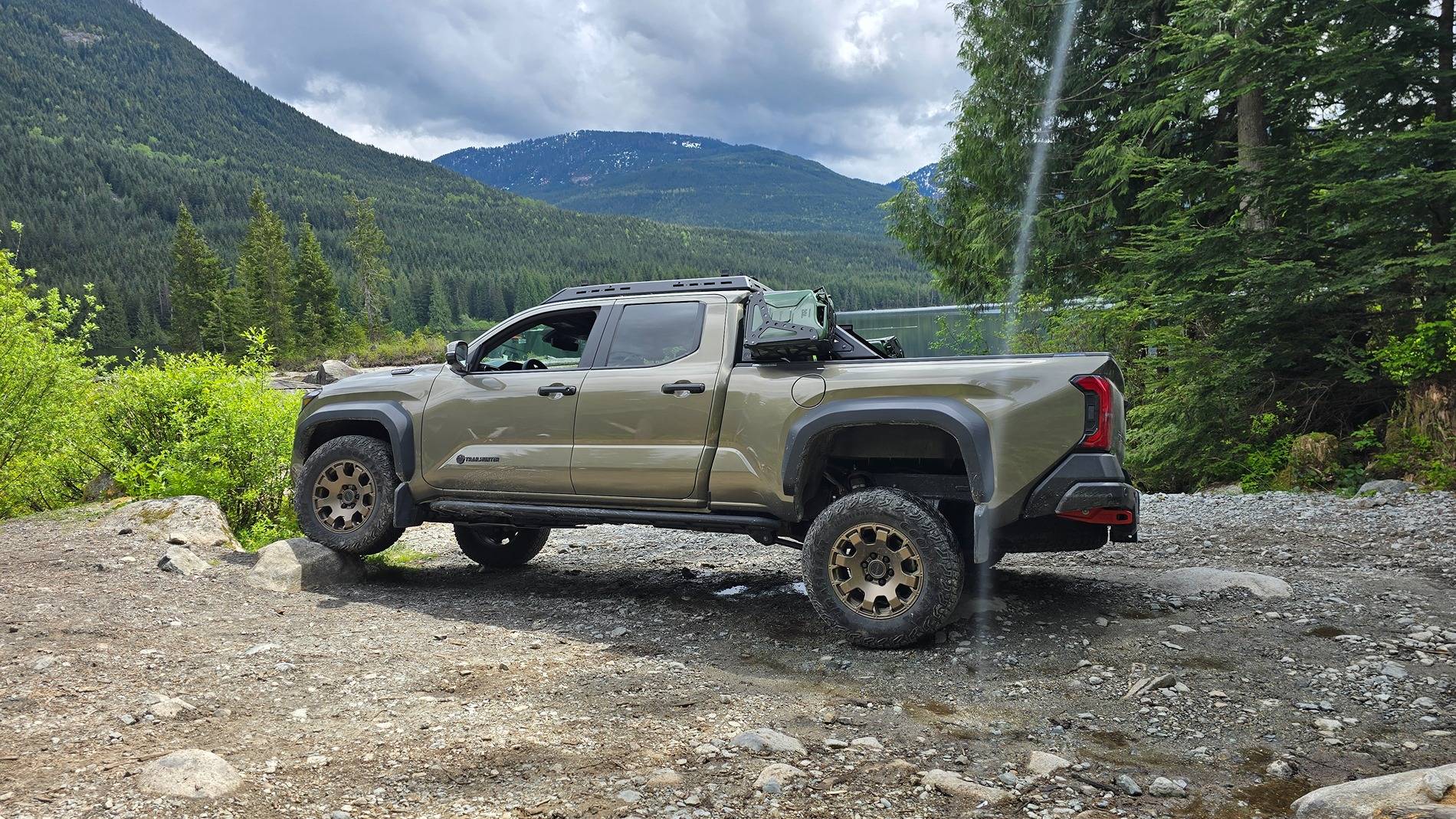

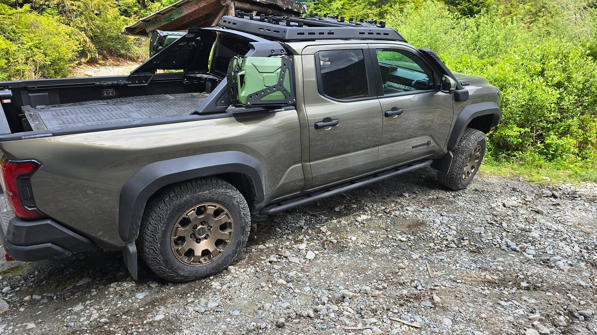

Changed coils on Trailhunter. Got 2 inches on the front and 3 on the back. And I can't believe how drives much much better - huge improvement. Even my mechanic was shock how trucks feels much better with stiffer coils.

No nothing at all. It drives so smooth, like floating. I have now about 300lb weight with my Decked drawer system ad 2 cans of gas full and it's just floating on the road. While before was way more bumpy and you really feel any imperfection on the road, now that is gone and truck just floats.

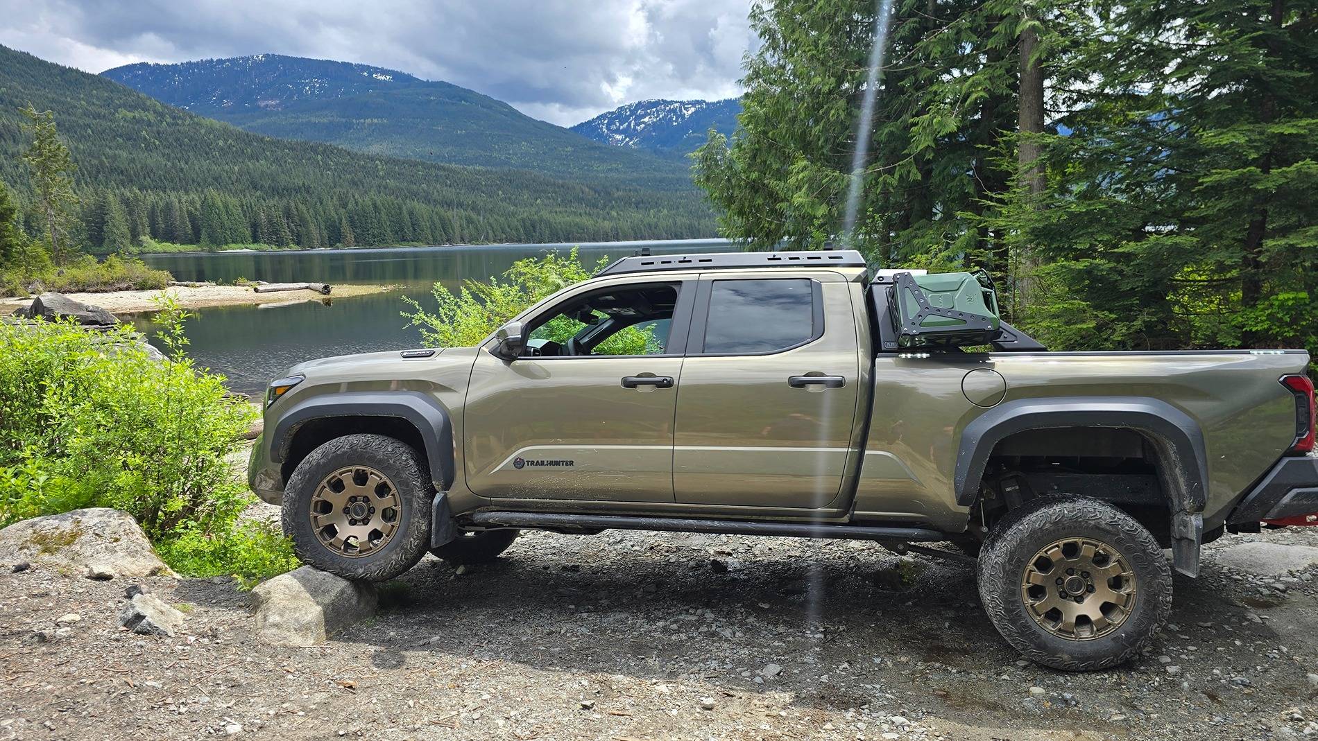

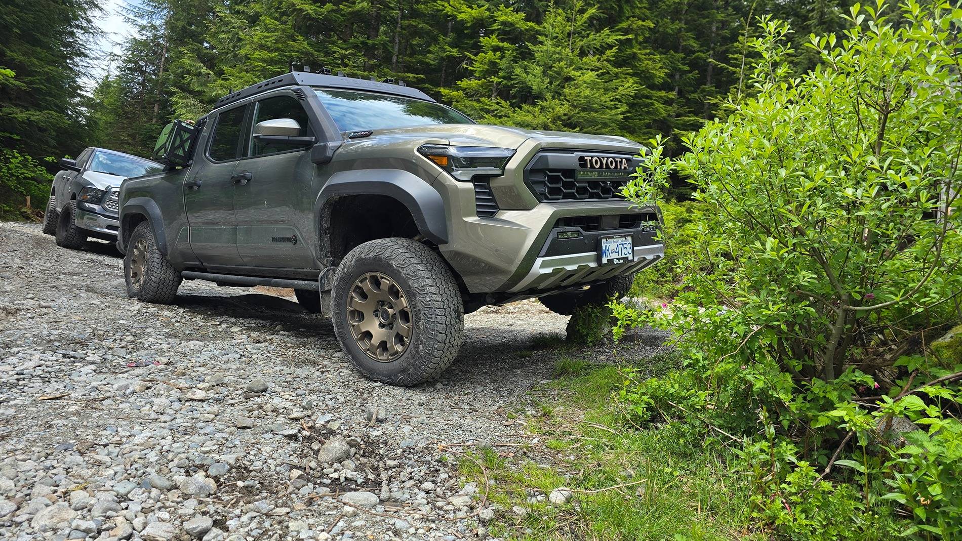

Ok - first time offroading today with these coils and absolutely love them. Around 300lb load in the back (Decked drawer system, 2 full jerry cans and some gear). Truck is just floating over the bumpy forest service roads. Never bottomed out, no matter how fast I was going over the bumps. With my jeeps I would be jumping up and down so bad on the same road if I don't slow down. Now I am thinking of changing coils on my jeeps as well. Even these are stronger coils still lots of compression as you can see in the photos. Unfortunately couldn't upload all videos here due to the size but will make YouTube video and will post a link. I am really impressed.
