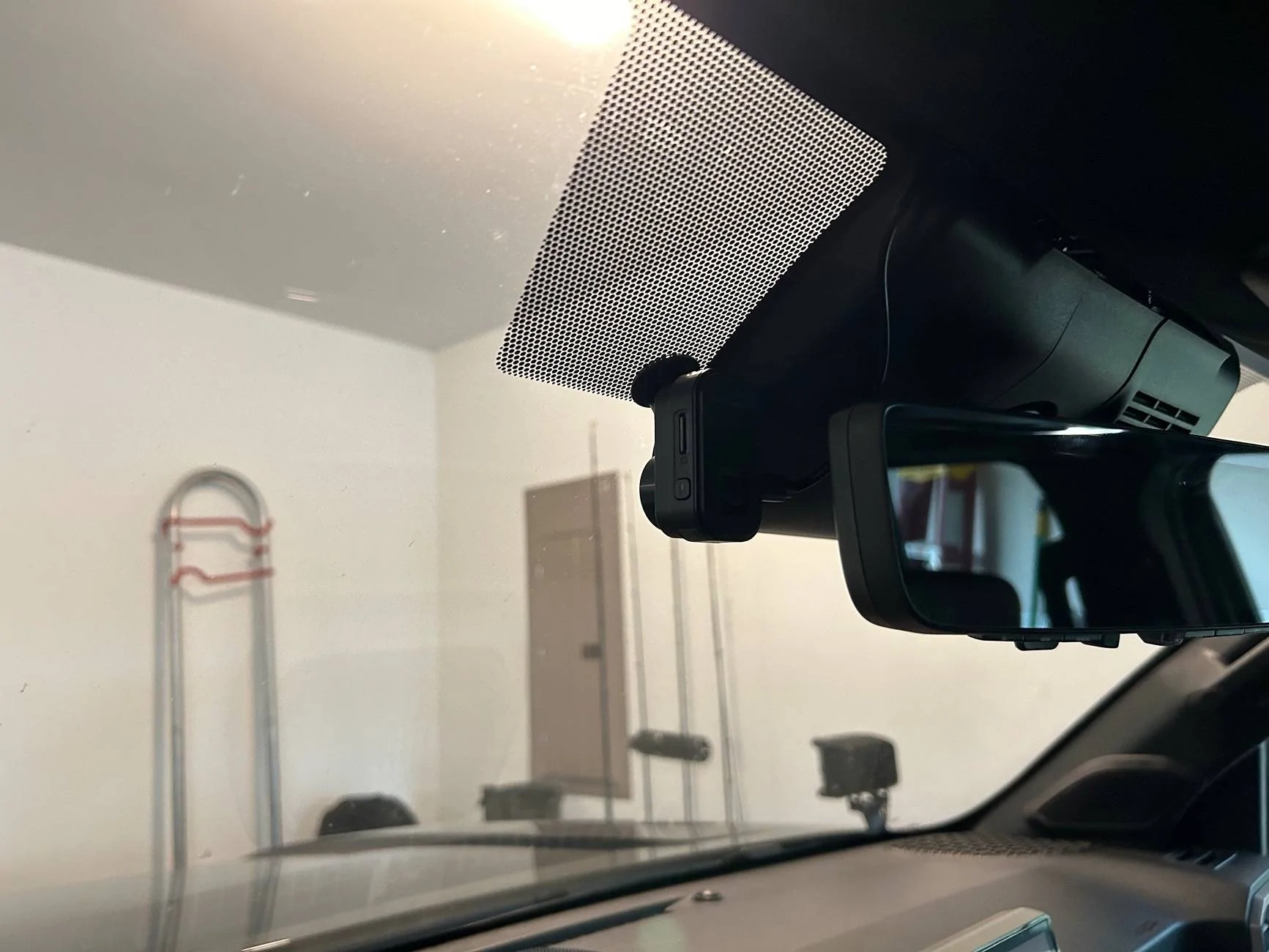

Just installed the Dongar adapter with a Garmin mini2. Super clean and easy install.
Glad you like it! Hit me up in a few months... we got something super special coming :)
