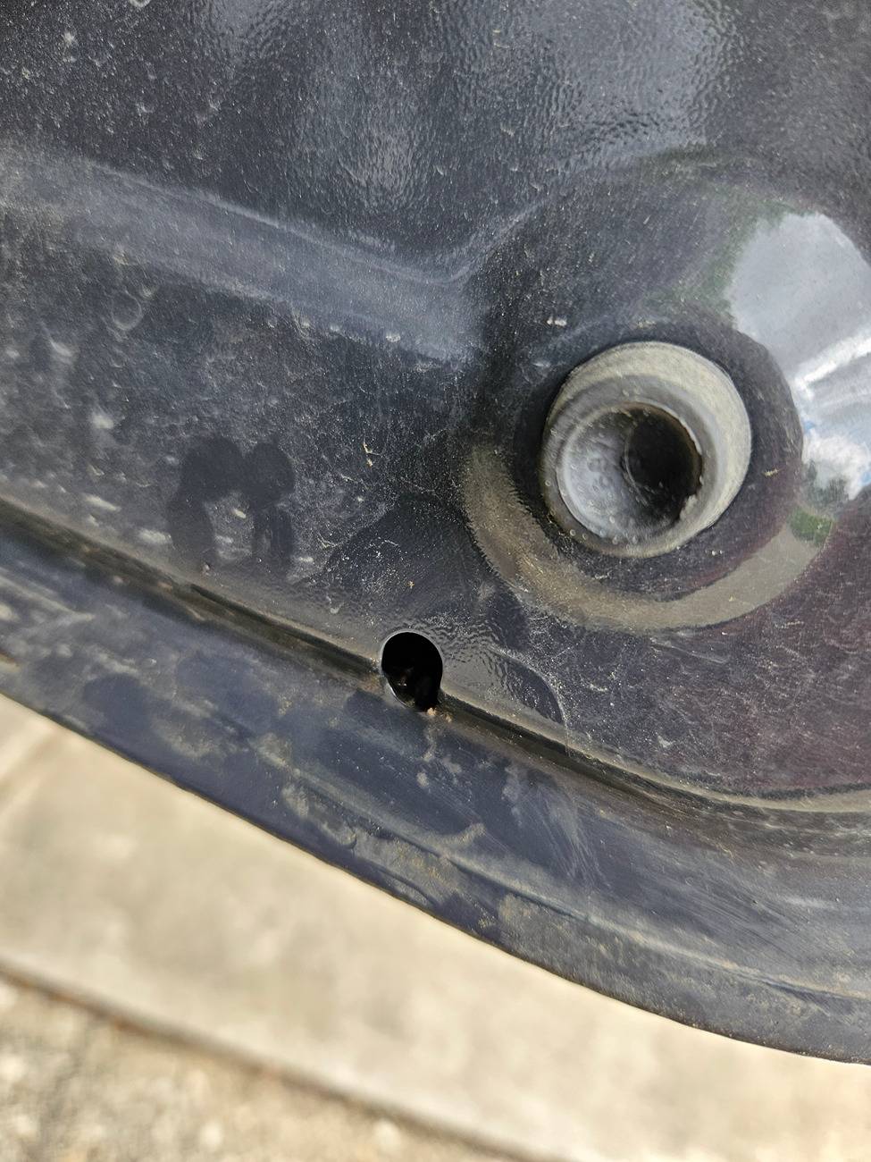

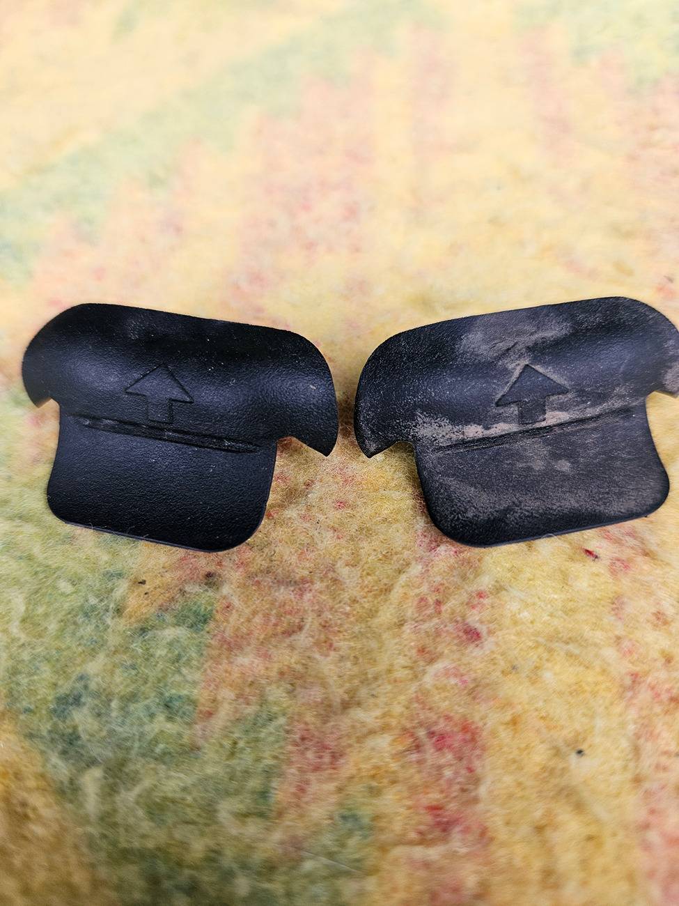

Went to open the passenger side rear door on my TRD Sport and notice a sloshing sound. So I assumed the door drains were clogged, I've had this happened with previous vehicles, no big deal. I then noticed that the drain holes had plastic plugs, pull them out and out came about a gallon of water. I can't reason why Toyota would plug these holes. Has anyone had this happen? I think i'll just pull the other door plugs so the door can a least drain naturally.

Can you take a pic of the other side? (See next post - I found it)
They usually allow passage of water, but provide some sealing against dust and bugs from getting in. Perhaps yours were clogged.

I looked them up - part number 67837-47060.
They are supposed to allow water to drain under them. If your truck is parked outside, either frequent drain cleaning or removal of these covers will probably be needed.

Found this TSB from Toyota, doesn't apply to Tacoma (applies to Corolla), but pretty much sums it up, I think I'll just remove all of the plugs

Good find! It would be nice to see a TSB for Tacomas so we know which dust seals should not be replaced.

Okay I’m convinced, they’re extremely easy to remove, prying up from under the bottom of the plug

Yeah - good info. I need to check mine and I like the idea of only putting some of them back or maybe not putting any of them back since they seem to get clogged up. I would rather have a little dust in the doors than have the doors holding water.
I saw a post a while ago about a TSB for a different Toyota product. Maybe a Rav4? It said to remove them, let the water drain and then to put some back, but I don't remember which one(s) you were supposed to leave open.
