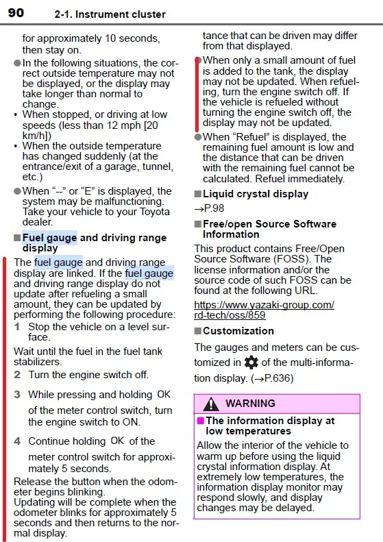

I think my issue is different than most people are interpreting what is really going on. I filled up my truck and the gauge stayed on 3/4.
See if the information on page 90 of the owner's manual is of any value.

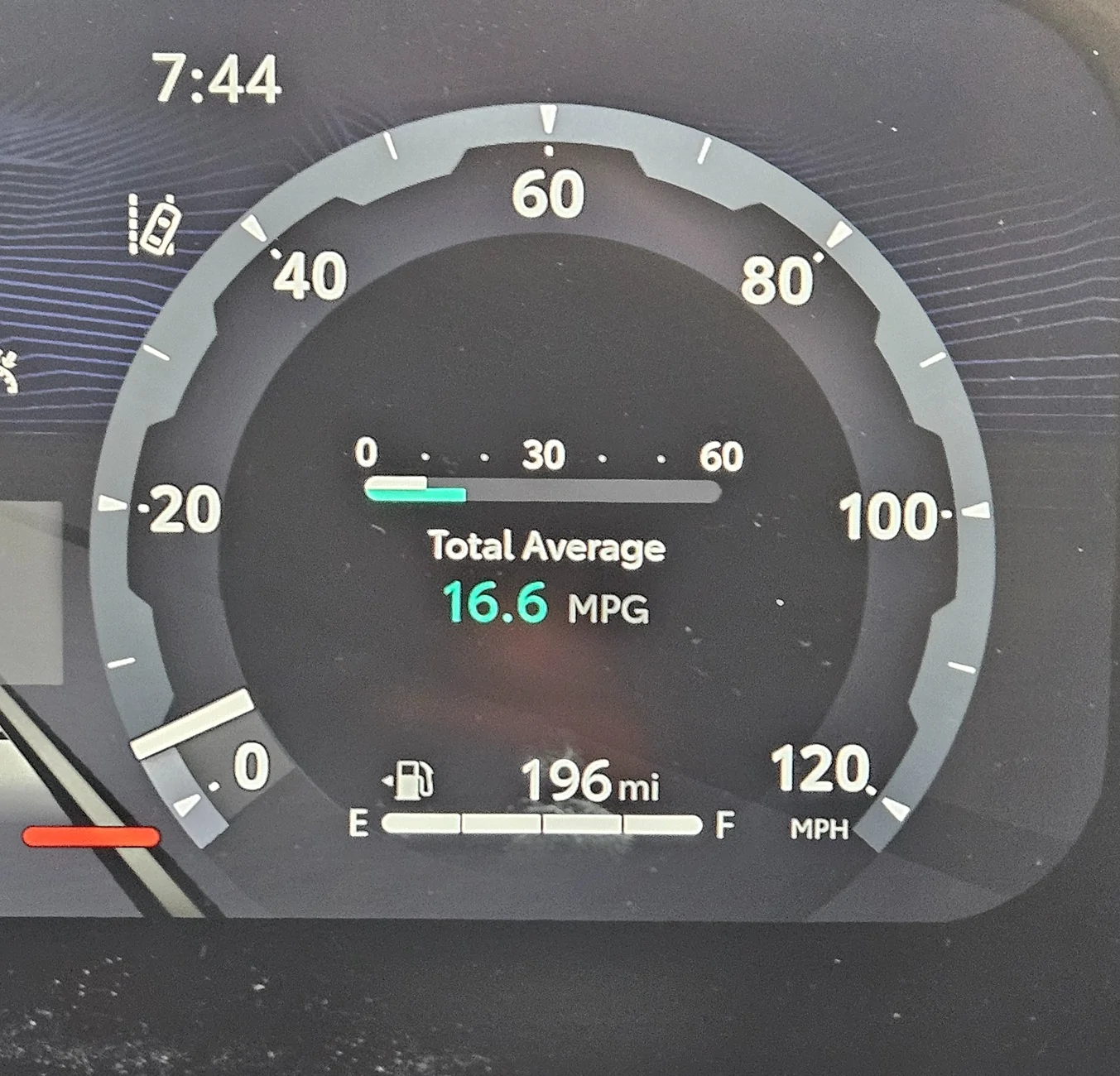

With a 18.2 gal fuel tank at 16.7mpg it should say about 300 mile range. When I full up it says 255. Been driving for a few days now it says 196 and the gauge hasn't moved yet
This must be one of the biggest misconceptions about these trucks.
Your DTE calculation is based off of ~15.5 gallons of fuel & your current MPG reading. If you reference your user manual (shocking I know, why would anyone do that?!) you will see that you have ~2.7 gallons of fuel reserve, i.e. once your calculated DTE reads 0.
SOOOO, doing the math for your reading here (18.2 gallons TOTAL - 2.7 gallons RESERVE) = 15.5 gallons USEABLE.
15.5 USEABLE gallons x 16.6MPG = 257.3 miles, which is right about what you said it was showing.

Update: Issue resolved itself after I did the "reset/calibration" method. I've run several tanks through it and all seems fine.
Glad it's better. Definitely turn the ignition completely off when you refuel. In addition to the fuel gauge and mileage calculations resetting, the EVAP system can also get really angry if the truck is powered on and the gas cap is removed.

Glad I was able to find this thread. I have a new 26 that just did this. Filled it up with ignition off and noticed after a few days of driving I was mysteriously still on full tank. Did the PG 90 calibration and it is showing correctly. Little odd to even have to do something like this but ok hope it continues to work. Thank you for people posting, would have never thought of having to calibrate my fuel gauge
Well it did not fix my issue, filled the truck back up and drove 73miles and it is still showing full. I guess to Toyota dealer it goes
