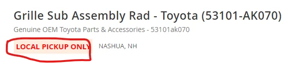

Comparing apples to oranges. Even says in big bold letters, local pick up only. The cheapest shipping I have found is $120 from a dealer. My local dealer and plenty of other do not discount.
2024 Tacoma Heritage Grille -- OEM and Aftermarket Options Screenshot 2024-09-05 162729

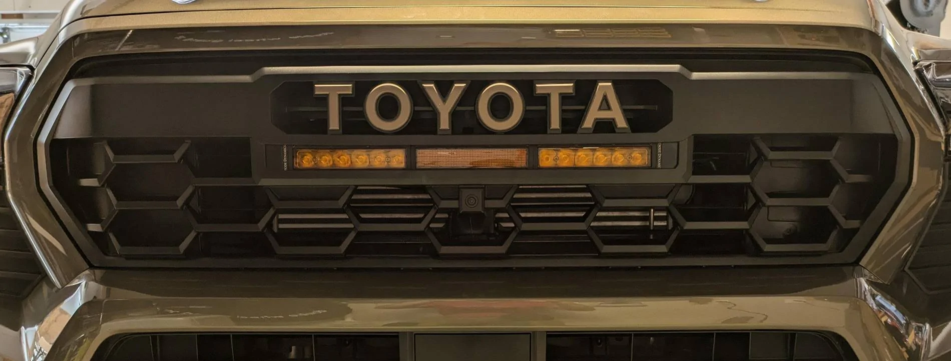

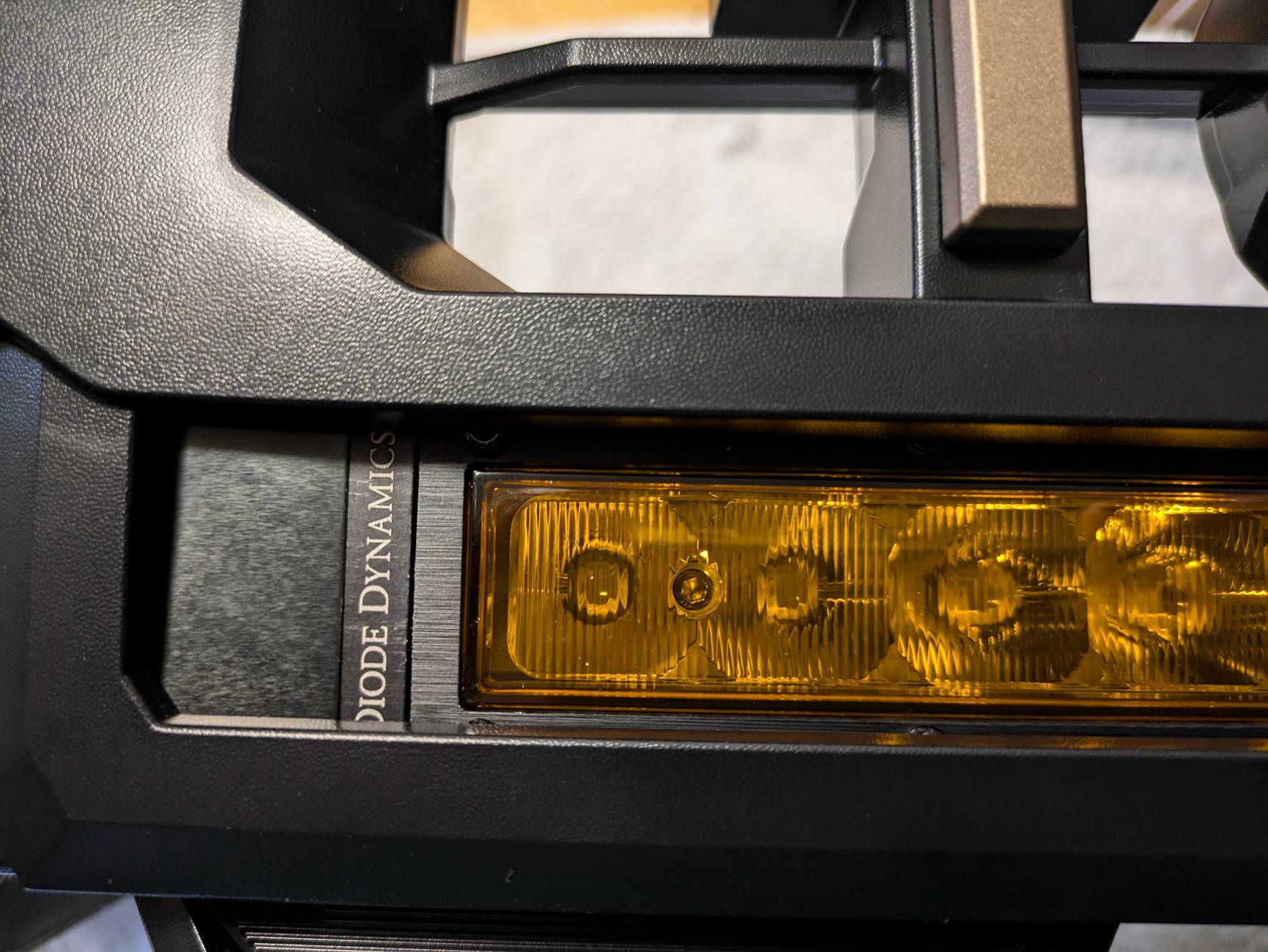

I went with Diode Dynamics 18" and used black anodized aluminum to fill the side gaps. Search for a combination of "DIY" "Heritage Grille" "Diode Dynamics" and you'll find the post and see what I did. I'm very happy with the final product.
2024 Tacoma Heritage Grille -- OEM and Aftermarket Options 2024-11-09 14.49.39a
2024 Tacoma Heritage Grille -- OEM and Aftermarket Options 2024-10-18 17.59.25
That said, DD announced at SEMA that they are switching to the 20" standard in their newest iteration of the product line.

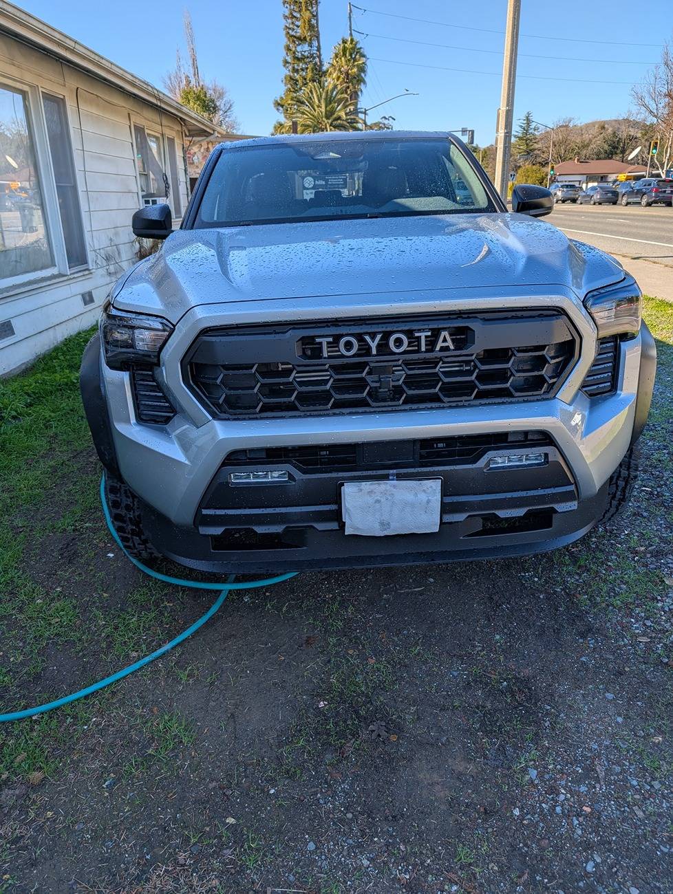

Aspire grill no cutouts for light bar/no camera
$289
2 week shipping
looks great silver lettering
2024 Tacoma Heritage Grille -- OEM and Aftermarket Options PXL_20250122_220738268
Love the no sombrero logo look !
i removed all the badges
" Badges ? I don't need no stinking badges ! "
