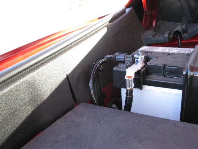

I'd like to get the struts but I tried the Redline which are the same thing as these and unfortunately for some unknown reason, some Tacomas come with an IBS module attached to the neg. battery terminal and some don't. Mine has the module and it and it's cable sticks out right where the strut would come down on. So I had to return them. Here's a photo of that cable with the strut bracket installed. It sits right on the mounting bracket from the kit. And if the strut was on, it would come down and damage the connector to the battery.

^ I've just installed the Redline version off Amazon a few weeks back and had the same battery connector sticking out (non-hybrid '25 Limited) but oddly it even says on the installation sheet several times and with photos that IBS cable isn't an issue if you tuck it underneath the ball mount. I did that and not thrilled with it since it does just barely touch the bottom of the strut once installed, but seems fine at least on my truck and had the cable sheath to help protect it. Might try to shift or unbolt and try to rotate that cable connection next time I'm under the hood. Overall the Redline version worked for me and seemed more than strong enough to support the hood, other than me leaning on the wheel fender and putting a nice 3" crease in it. Spent more time lightly hammering the crease out from underneath than on the hood strut install.

Thanks for the info. There's really no way to turn that IBS connector. It also looked as if the strut would come too close or even deform the connector when the hood was closed so I just didn't take the chance. I bought the Redline early in 2025. I don't think the 2024 models had the IBS module so my 2025 may have been one of the first. At that time the Redline instructions did not mention the IBS module. Nor did their online video. I assume they got enough returns to look into it and that's why they now mention it.
