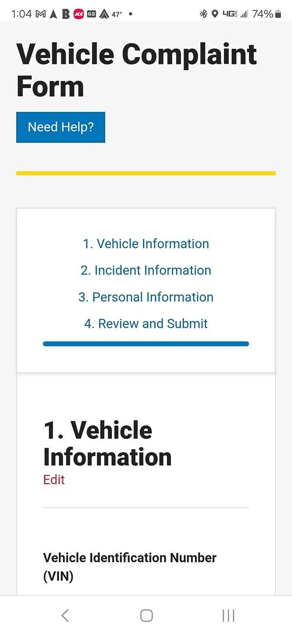

Who has taken or contacted Toyota about this and has got a resolution?

Yes, but that doesn't make it right. To me as an ASE L1, L2, L3 Master Technician, this is a safety issue and needs to be properly diagnosed, reported and possibly issue a safety recall. #NHTSA
