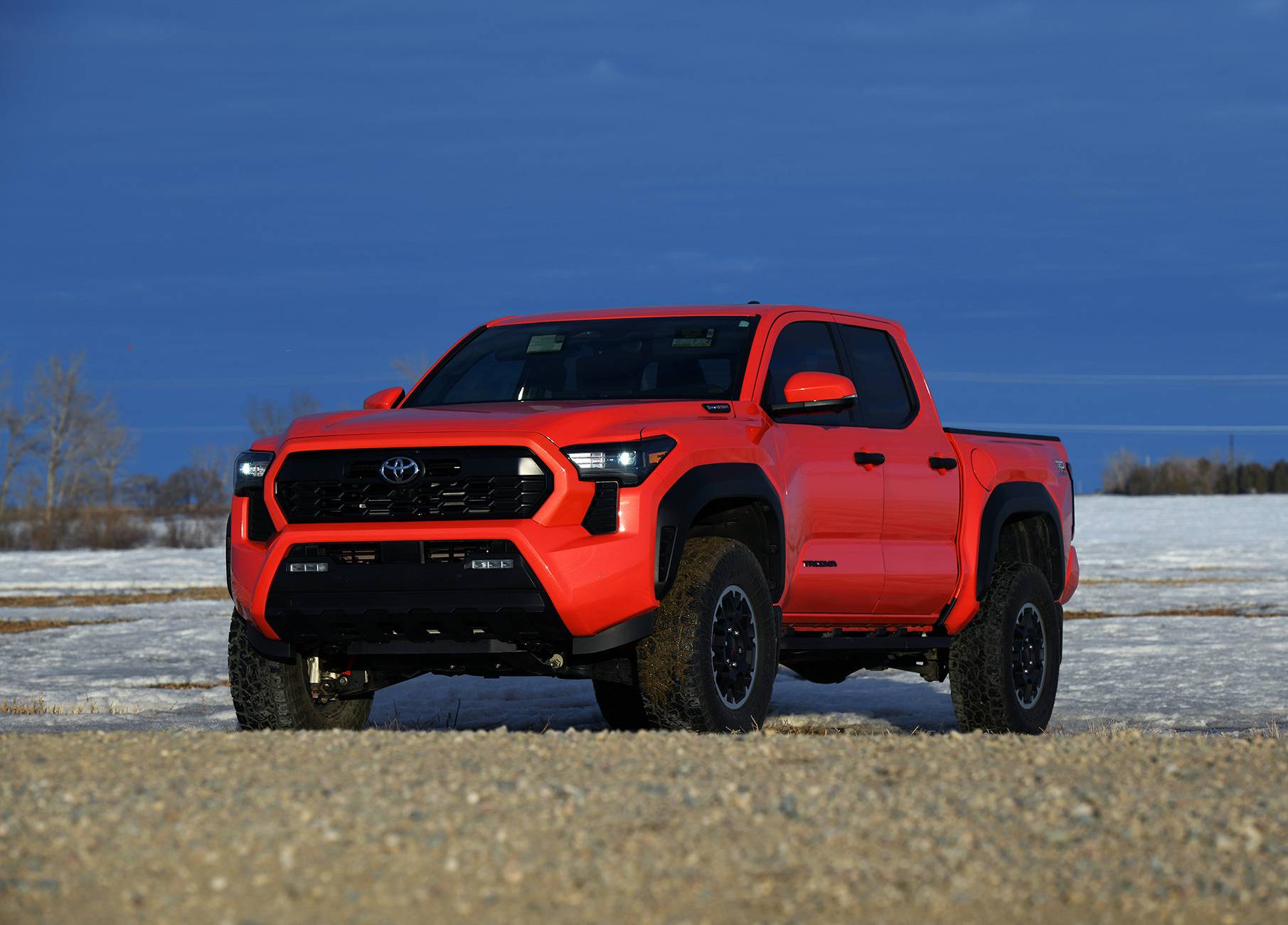

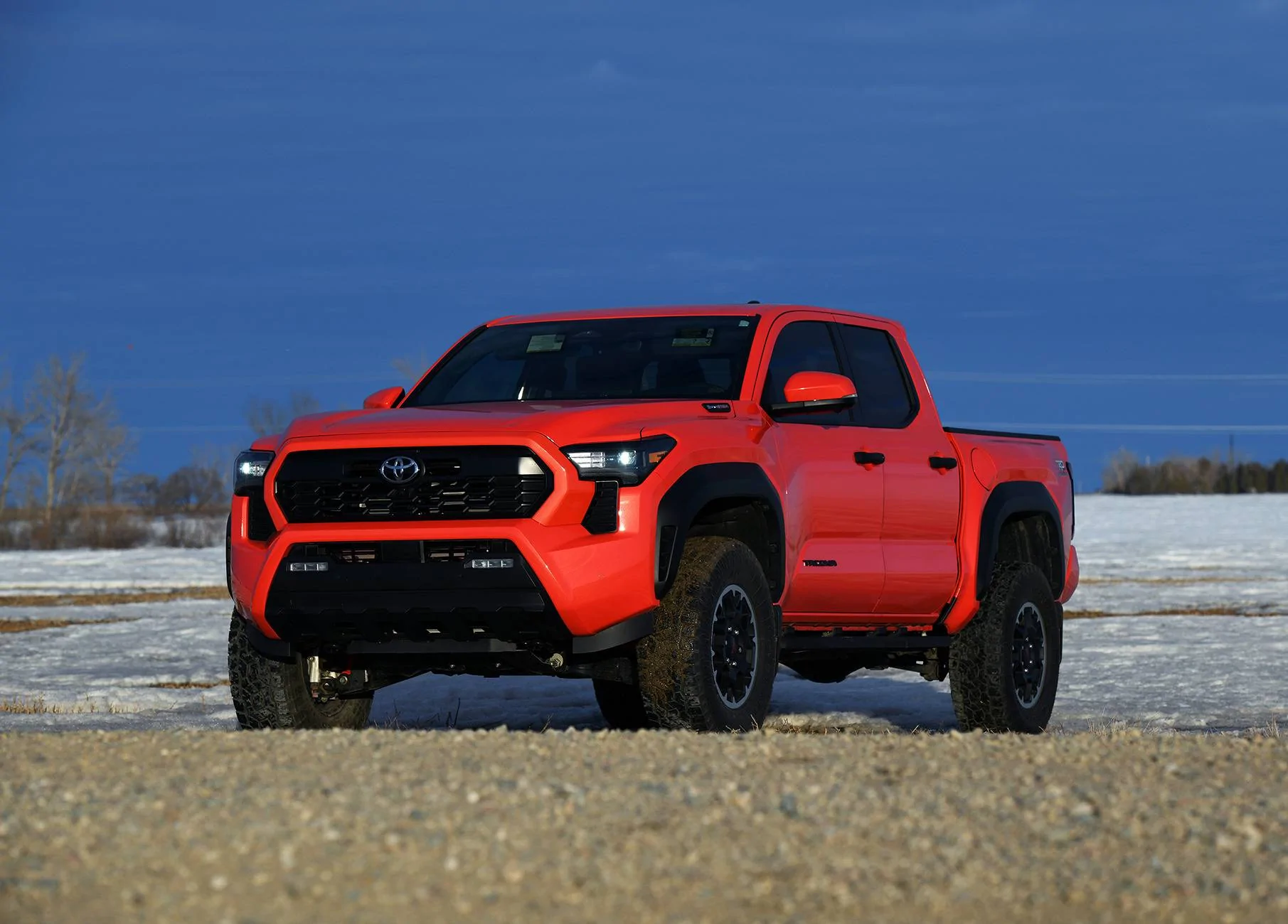

2024 Tacoma TRD Off-Road Hybrid
Sounds like my Phase 1.
Just wanted the truck to look a little "tougher".
-Wescott spacer lift front and rear
-17 inch TRD wheels with Spidertrax 1 inch spacers
-Toyo AT3 285/70/17
-front spoiler delete

Sorry, I might have the terminology wrong. The Wescott is a preload collar lift.
No issues so far. It is a little stiffer on expansion cracks, etc.
Not adding heavy wheels and tires helps, I'm sure.
As for longevity, you would want to hear from someone who puts their trucks through more of a workout than i do. :)
I am waiting and watching as new suspension options come about. Including the Toyota TRD lift.
But for my purposes, the Westcott lift is doing fine for now.
I installed them knowing it would probably be somewhat short term.
I went with my particular 17 inch Toyo AT3s for a few reasons. One is that they are only 47 lbs (per Tire Rack specs). They are 32.8 inches diameter. Which is only a little more than the 18" Wildpeaks that came on my OR Hybrid. The extra torque from the electric motor off of the line makes a few extra pounds transparent.
Good luck!

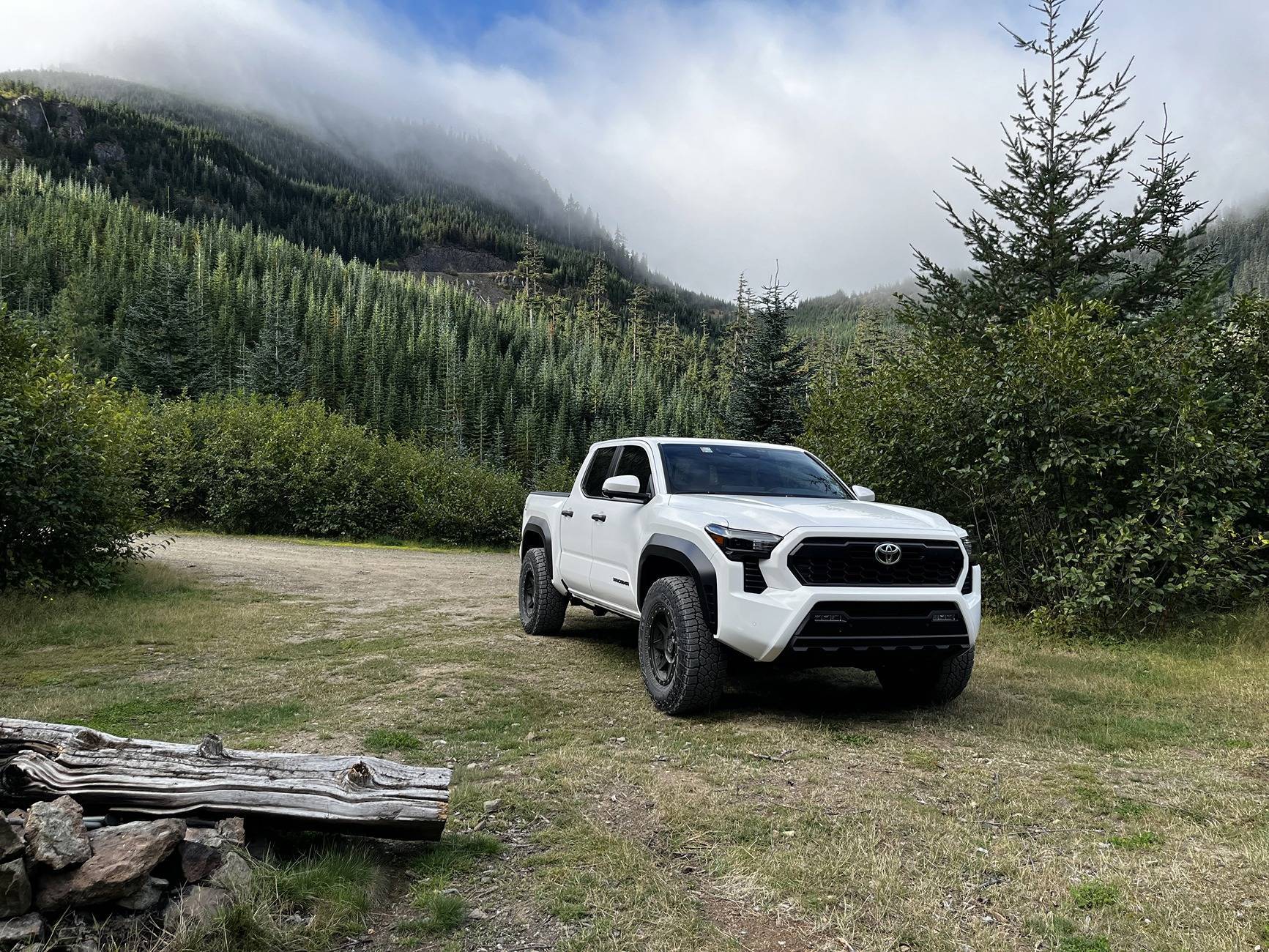

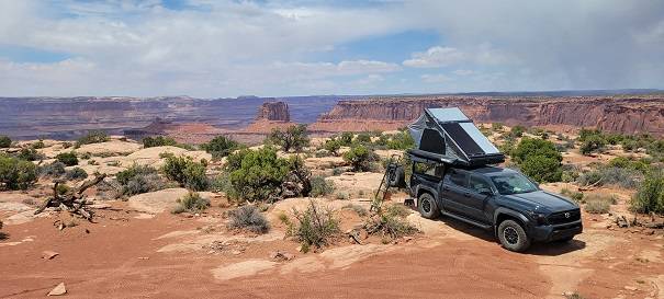

I mostly use my truck to commute and the occasional forest service road. I saw another member use the term "softroading" and I think that perfectly describes my use case.
With that said, I did no lift and installed 285/70R17 tires (33" tires) on Icon wheels. Everything clears without issue and saved the costs of a lift kit and any potential negatives that come with some of the lifts.
