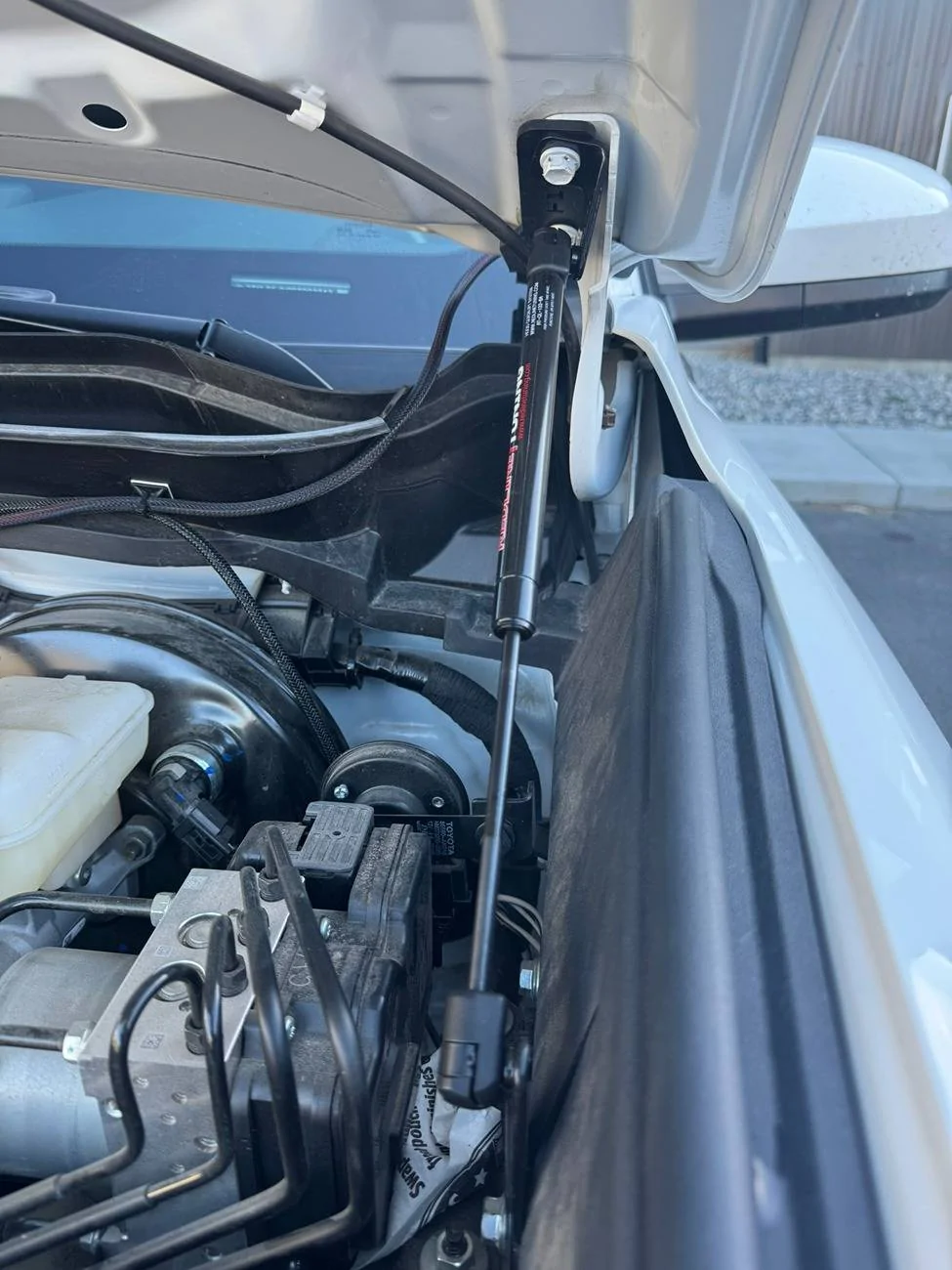

2024 Tacoma New Release: Redline Tuning Hood Struts for 2024+ Tacoma 4th Gen – 10 minute Bolt-In installation! IMG_1163

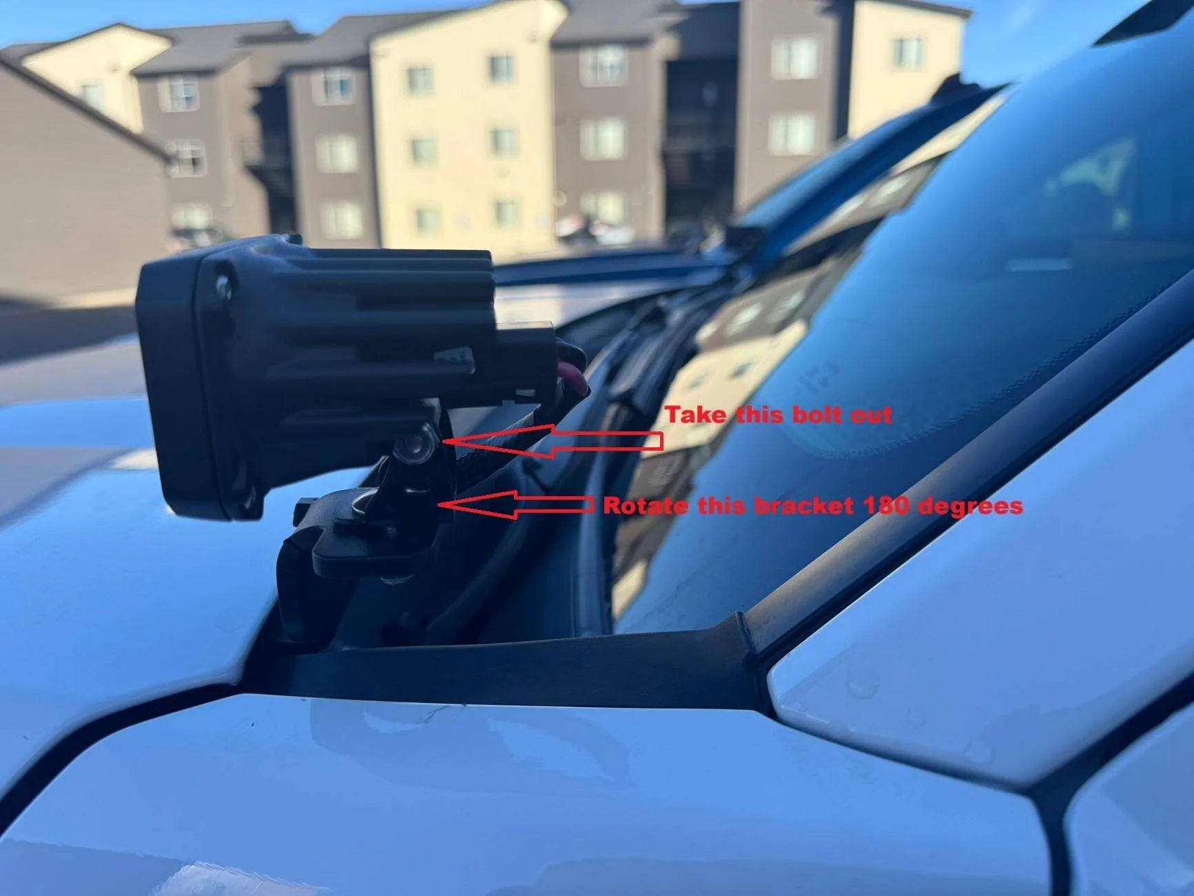

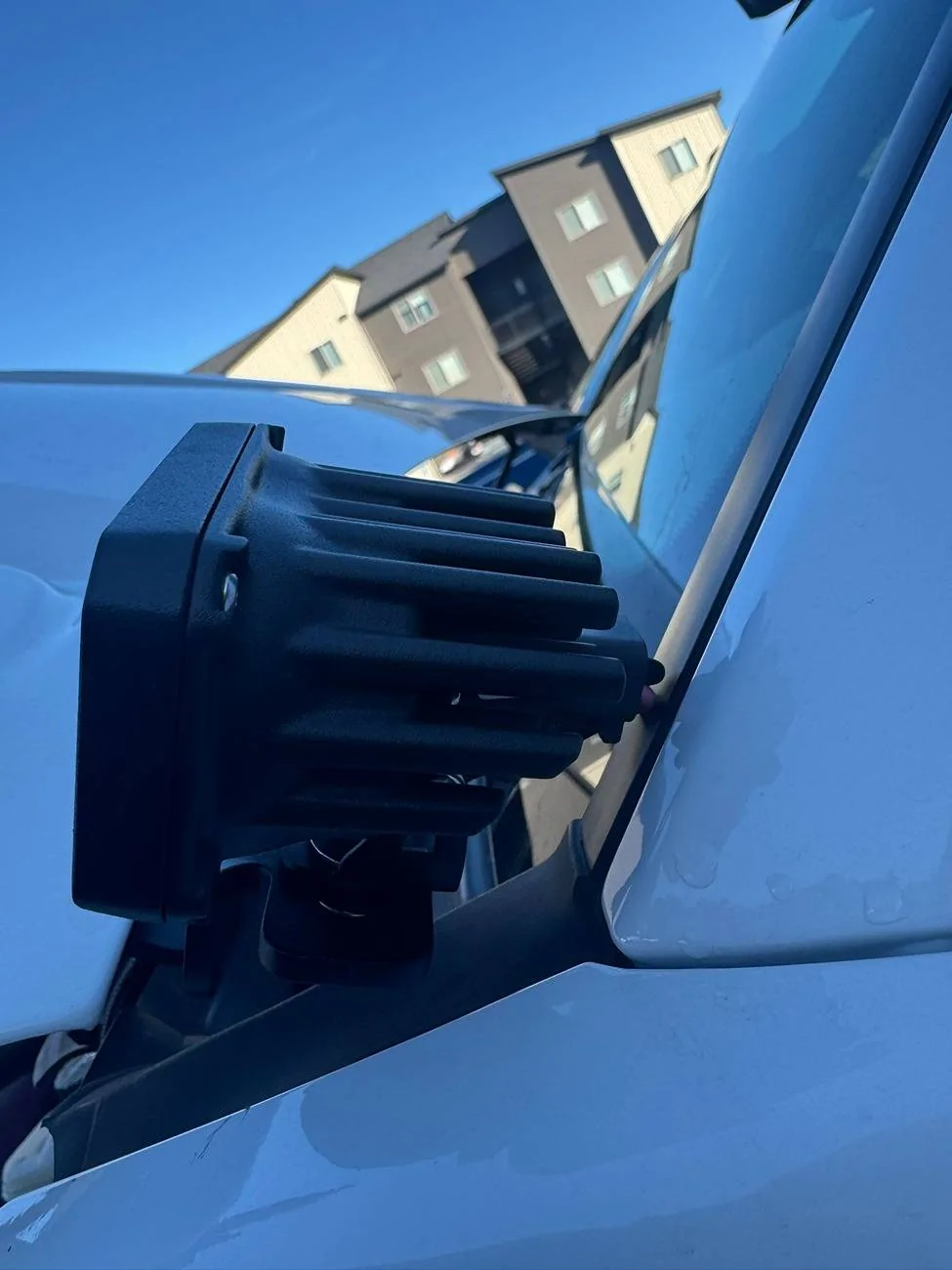

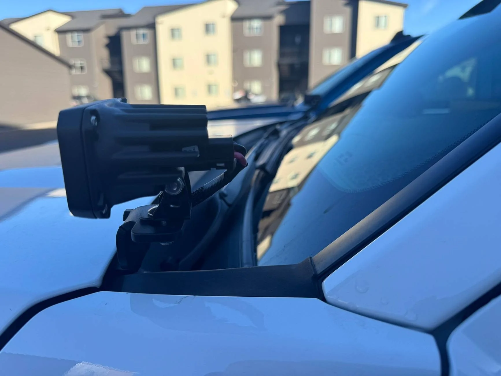

@Redline Tuning I haven't seen any one with ditch lights report fitment. So here's mine. I tried to use them with the CBI ditch light bracket and some Diode Dynamics SSC2 pods. Both the lights and brackets are pushed as far "forward" as possible. With the struts they push the hood farther up than with the prop rod causing the wire connector to impact the windshield trim.
@geonerdist Thank you for the feedback. I would recommend you rotate the bracket that mounts directly to your light 180 degrees. This will move the entire light "forward: and give you more clearance. :like: Hopefully this is enough to solve your clearance issue.
Oh my goodness...I did not think of that. I suspect that will work perfectly! I'll report back.
