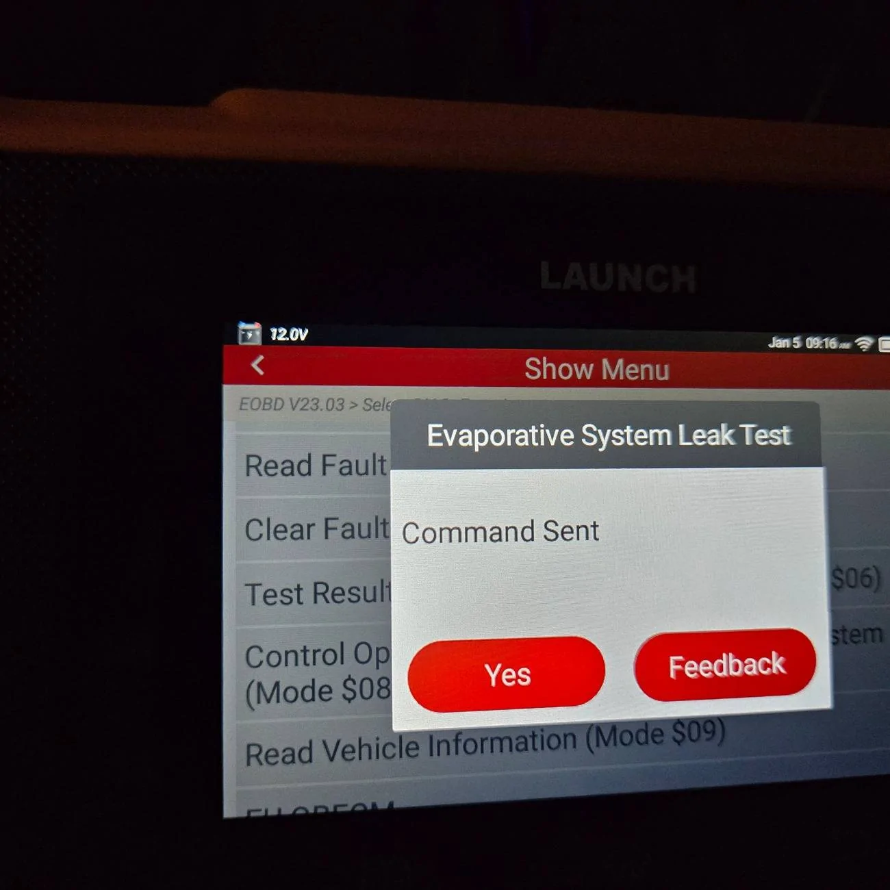

The OBD is pretty simple and is where I would kick off the EVAP test. I would have to take the gas cap off to see if it worked resulting in a fail. I will do that after I complete my reassembly and then pass emissions on my Land Cruiser
2024 Tacoma New Scan Tool Like Toyota Techstream and better than Carista 20250105_091707

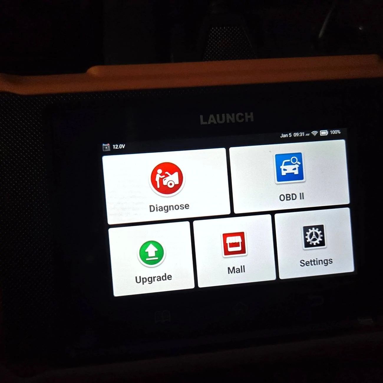

Now for the customization and good stuff.

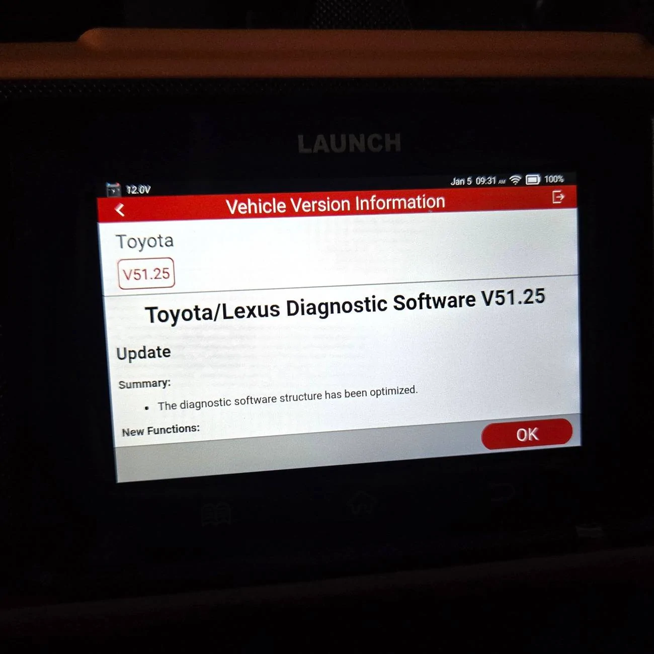

It isnt very obvious how some functions work. I got to one point were it was giving me a sw version so I thought that was info and all there was, but you have to select OK (Not sure why) to proceed to the good stuff
Main Menu- OBD takes you to normal OBD Functions. The Diagnose took some figuring out

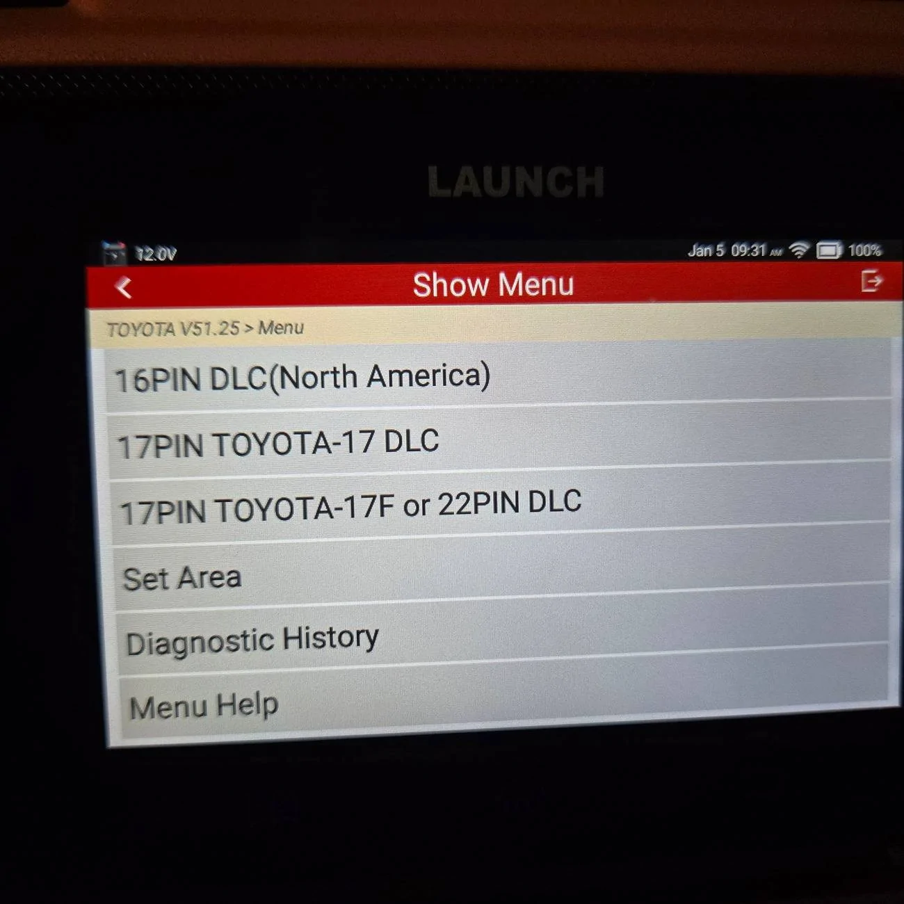

First select Diagnose and then you get this menu, select Toyota

Select OK
2024 Tacoma New Scan Tool Like Toyota Techstream and better than Carista 20250105_093139

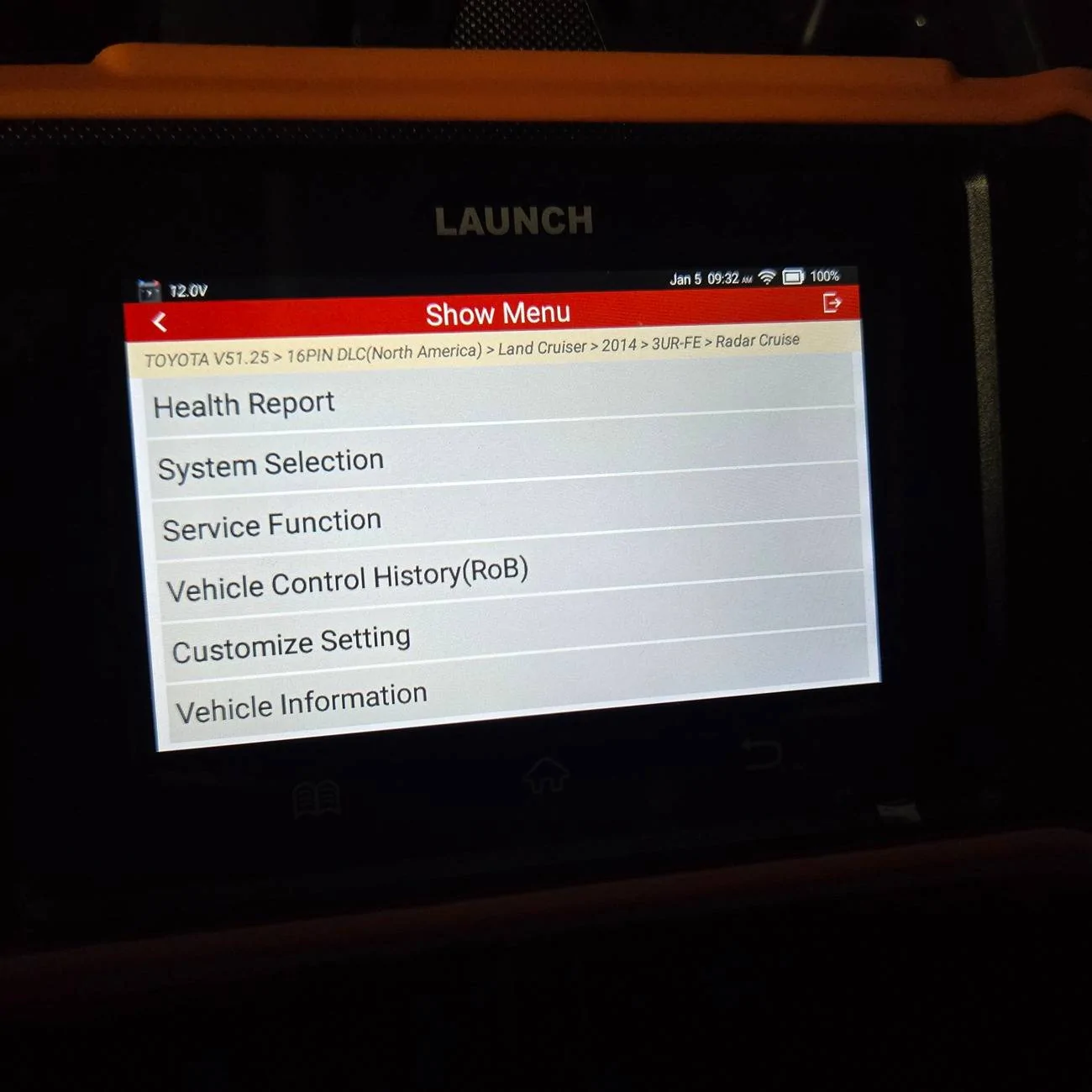

Then finally you get to the good stuff. I haven't played with it all yet. Service Selection is where you program TPMS or do Brake bleed etc or reprogramm a new factory key. I have not verified any of these functions
Customize settings is what Carista provided

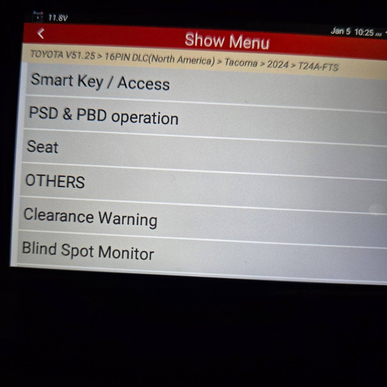

2024 Tacoma New Scan Tool Like Toyota Techstream and better than Carista 20250105_093249

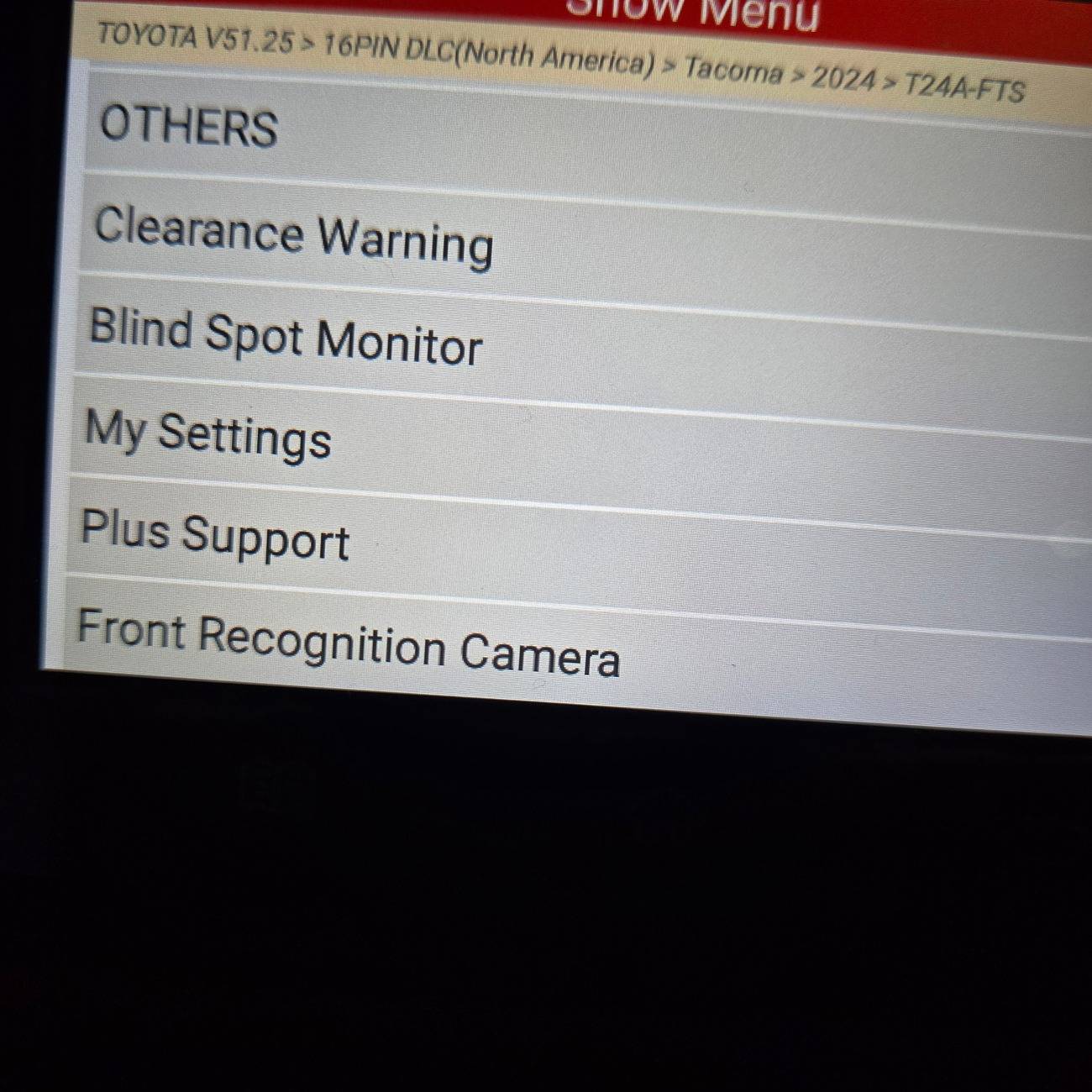

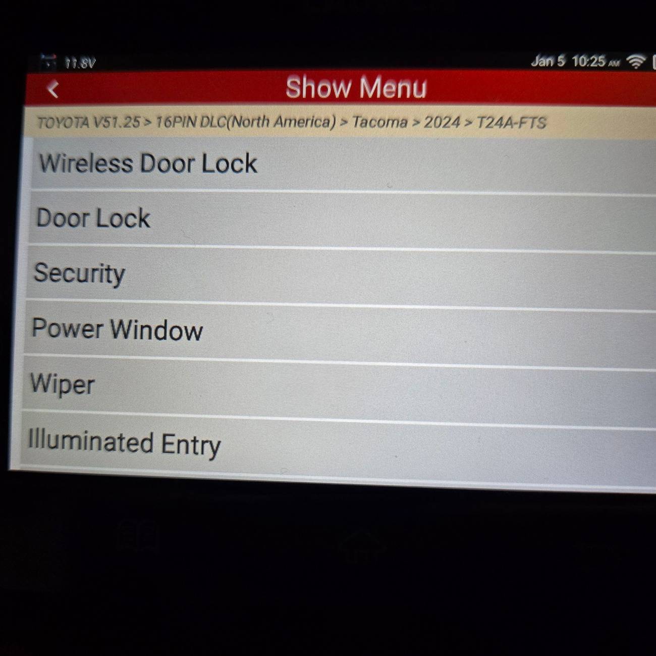

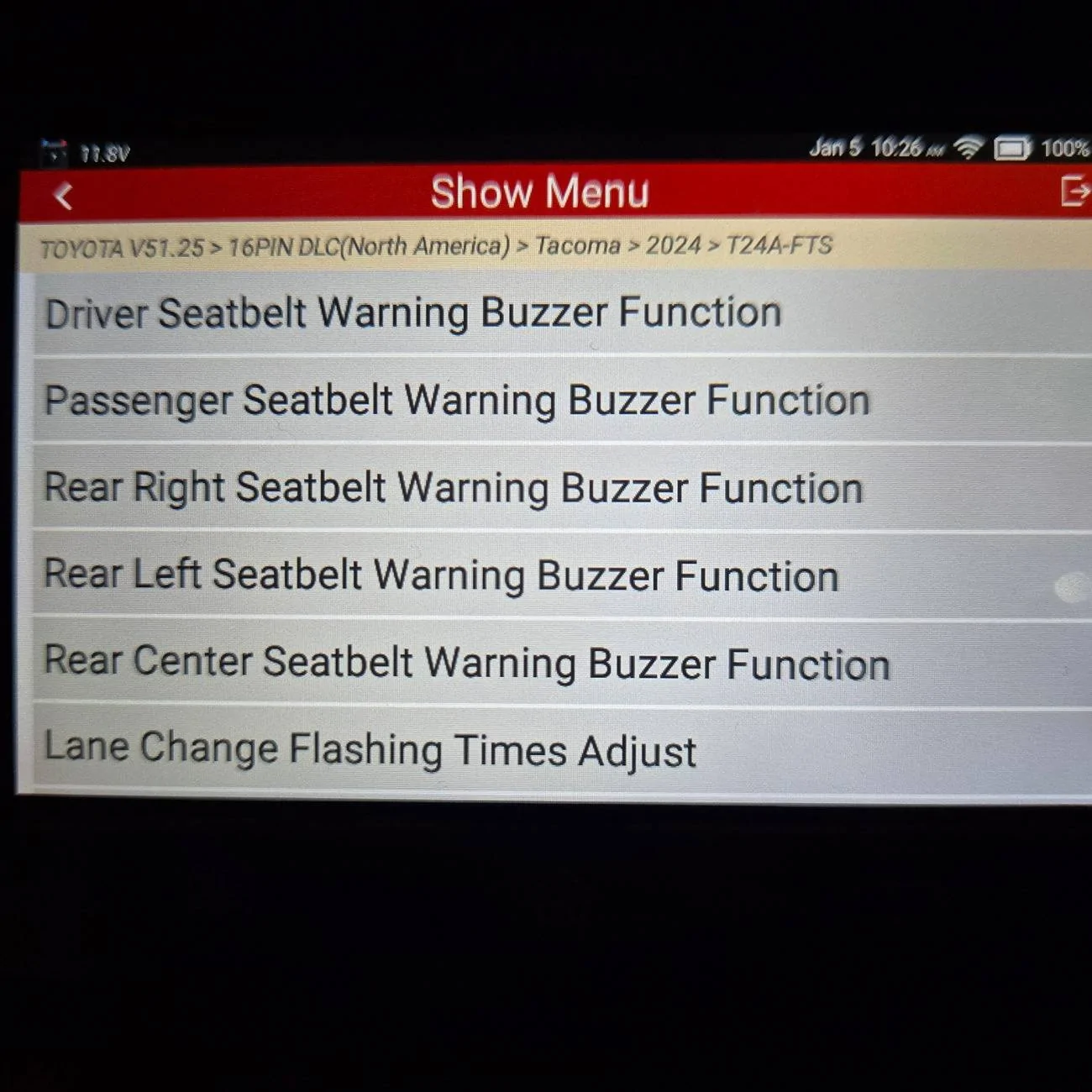

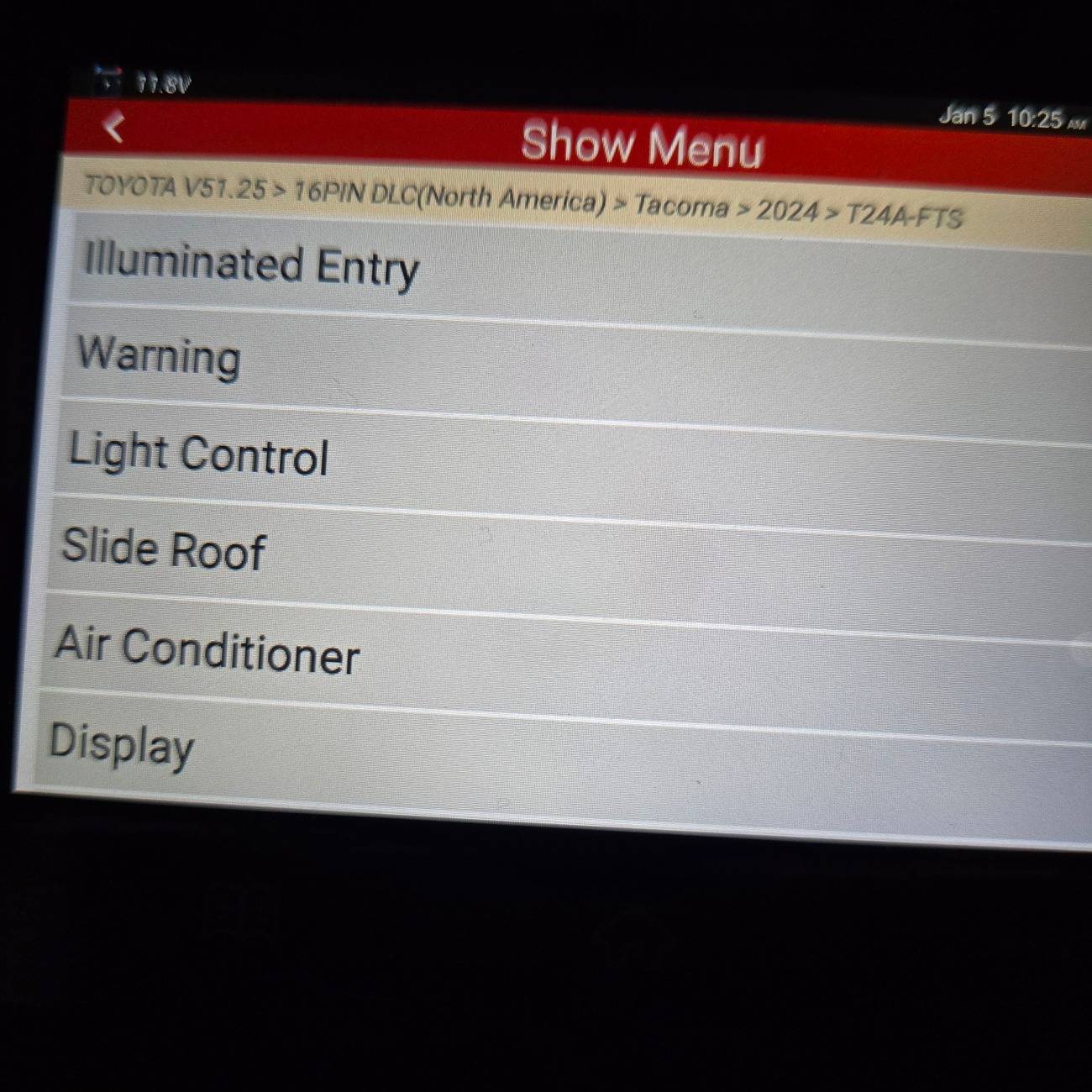

Customization menus. I did not dive down into each one. I did go under warnings to see the Seat Belt option I selected in Carista. Still a lot more to this tool that I haven't played with yet
2024 Tacoma New Scan Tool Like Toyota Techstream and better than Carista 20250105_102554
2024 Tacoma New Scan Tool Like Toyota Techstream and better than Carista 20250105_102603
2024 Tacoma New Scan Tool Like Toyota Techstream and better than Carista 20250105_102613
2024 Tacoma New Scan Tool Like Toyota Techstream and better than Carista 20250105_102619

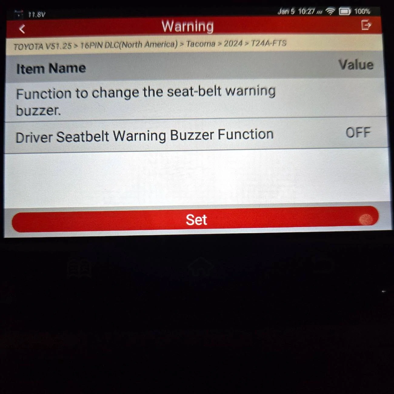

This is the menu under Warnings
2024 Tacoma New Scan Tool Like Toyota Techstream and better than Carista 20250105_102728
2024 Tacoma New Scan Tool Like Toyota Techstream and better than Carista 20250105_102737

Does this device also let you configure the engine noise enhancement and the raising and lowering of windows from the key?

I haven't tried that one. I think if Carista could do it, this could. Nice thing about Amazon is if it doesnt work for you, it is easily returned
