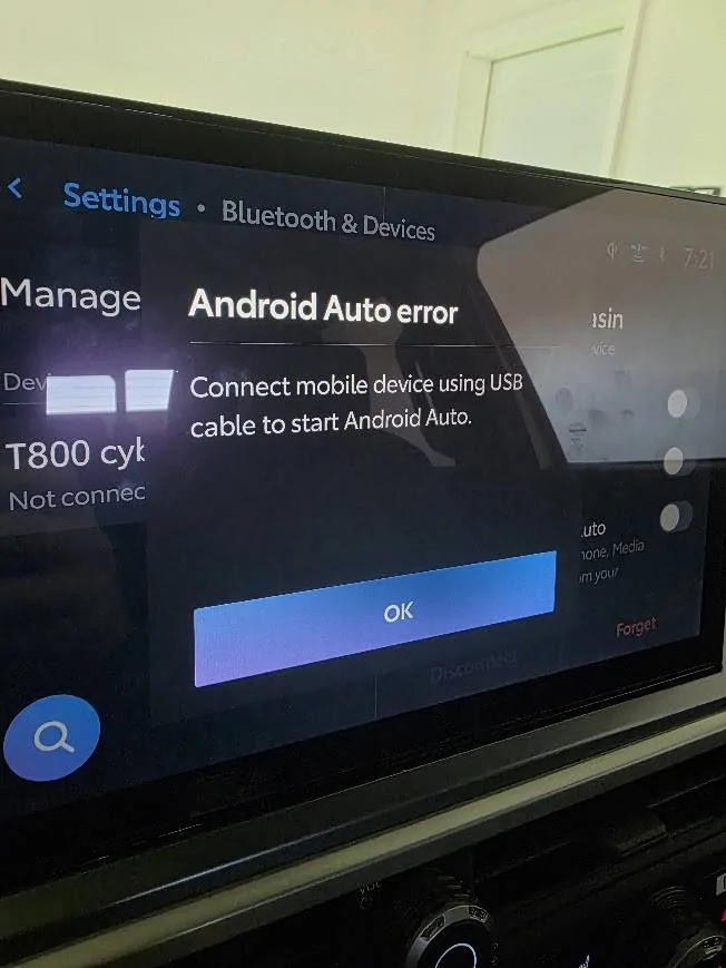

I got a new phone and now after setup it pops up and says I have to plug-in to use Android Auto. I was wondering if anyone else came across this and has an idea of permission settings or something? Ive tried a couple restarts of both the phone and vehicle. Previous phone was working fine (Samsung Galaxy s22 to Galaxy S25).
Android Auto error
"Connect mobile device using USB cable to start Android auto"
2024 Tacoma New Wireless car play/ Android auto issue requires being wired error

When mine does that occasionally, I usually restart the head unit on the truck, then go to settings>bluetooth>"my phone"> then tap the Use for Android Auto slider and it'll reconnect.

mine does that as well. its usually when im on long trips or the phone has a lot of background apps running. sometimes it will auto reconnect, if not i just go through display and reconnect. I have not been able to pin point the exact reason. maybe the app needs an update or reinstall?

Haven't had that on my truck but I just had it in a rental car Rav4. I went into Bluetooth on the car and forgot the phone, then reconnected Bluetooth only without plugging in the cable and wireless worked again.

Mine works wired or not. Until I finally found the ‘use for Android auto’ slider, it only worked wired.
