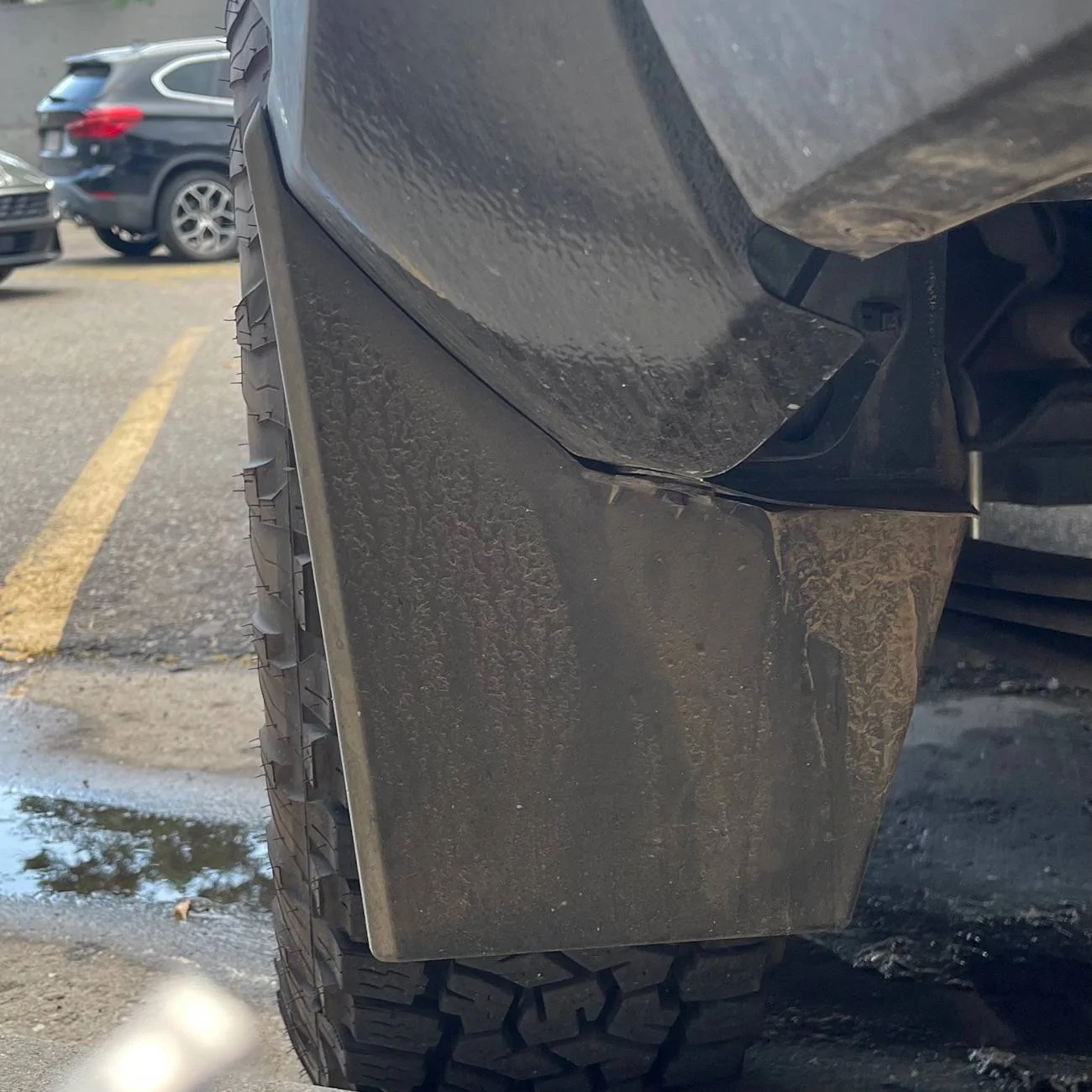

I’m running 285/70/17 and the Canadian flaps had me rubbing like crazy so I had to pull them off.. they have a big protrusion that hits my tire…. Odd nobody else is having this issue???

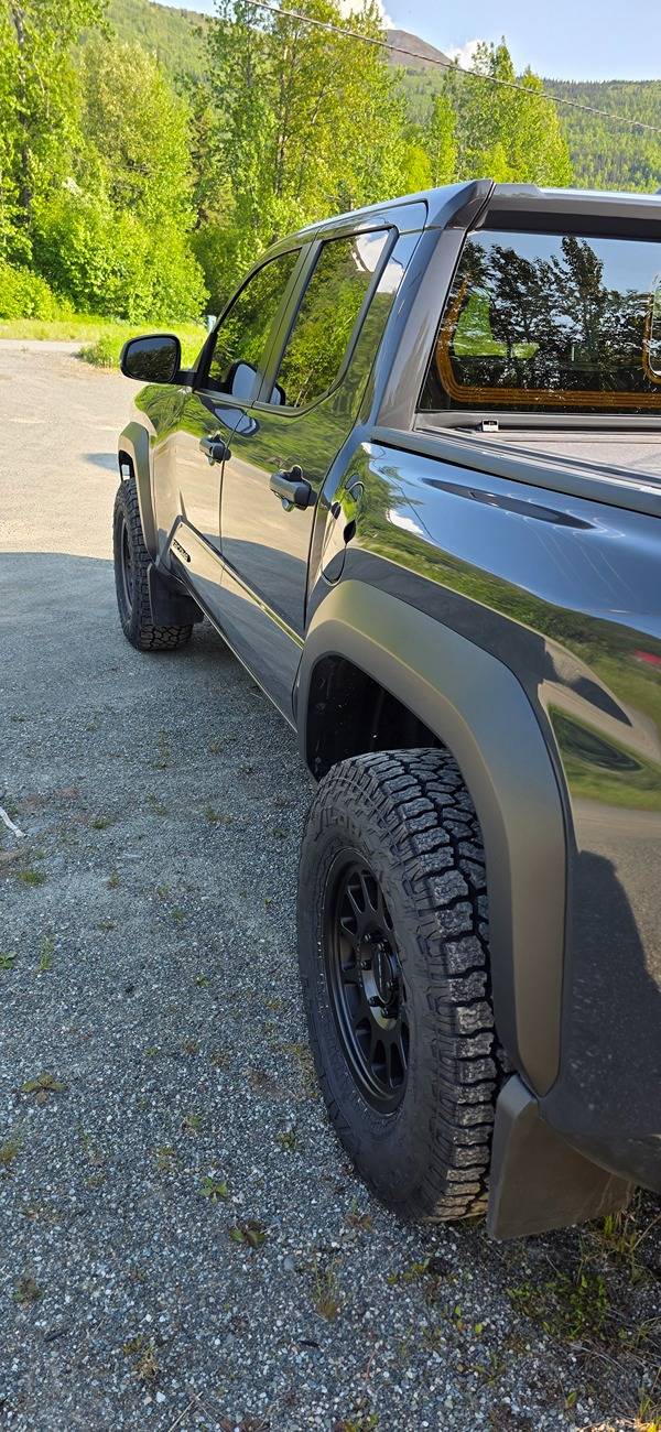

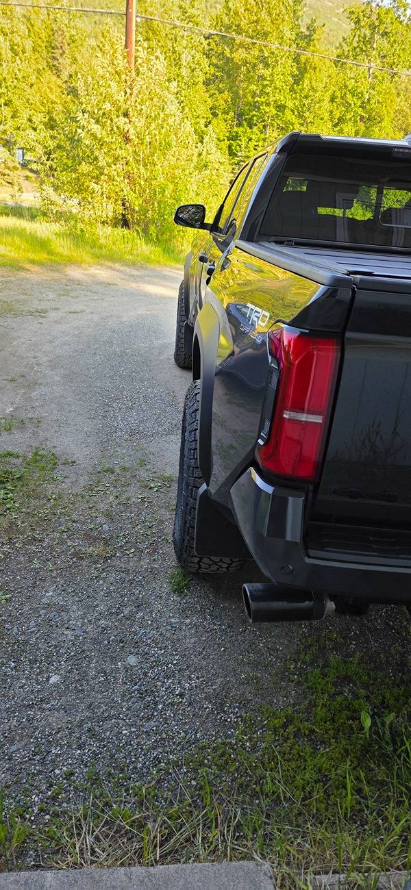

I'm on my 3rd pair of flaps... Started with the OEM then the Canadian OEM which were awesome until I upgraded to 285 70 17... The front Canadian flaps will rub on turns especially when turning into a parking lot or driveway... Now I'm on Rokblokz : Definitely more room just trying to figure out why there price is so high...?... The Rokblokz don't look as good but definitely more protection with bigger tires.. Hopefully my last flaps for this truck!... If people are sticking with stock tire size Canadian flaps work well...

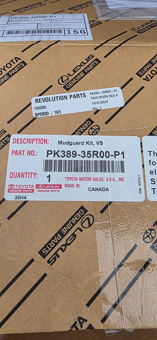

Not sure the size heres the part number... Thought there was only one size... I don't have any pictures before I took them off... Maybe you can zoom and see with 285 tires there is about an inch gap... New setup is rock sliders and rokblokz... I don't like the look of them but definitely wider protection... Rally flaps

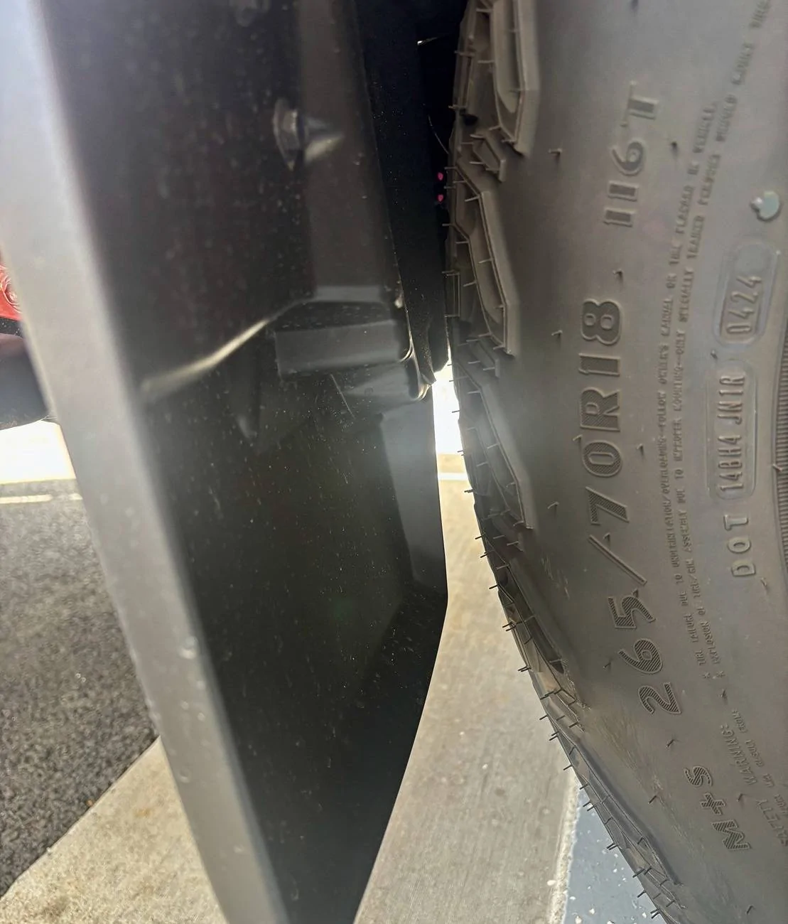

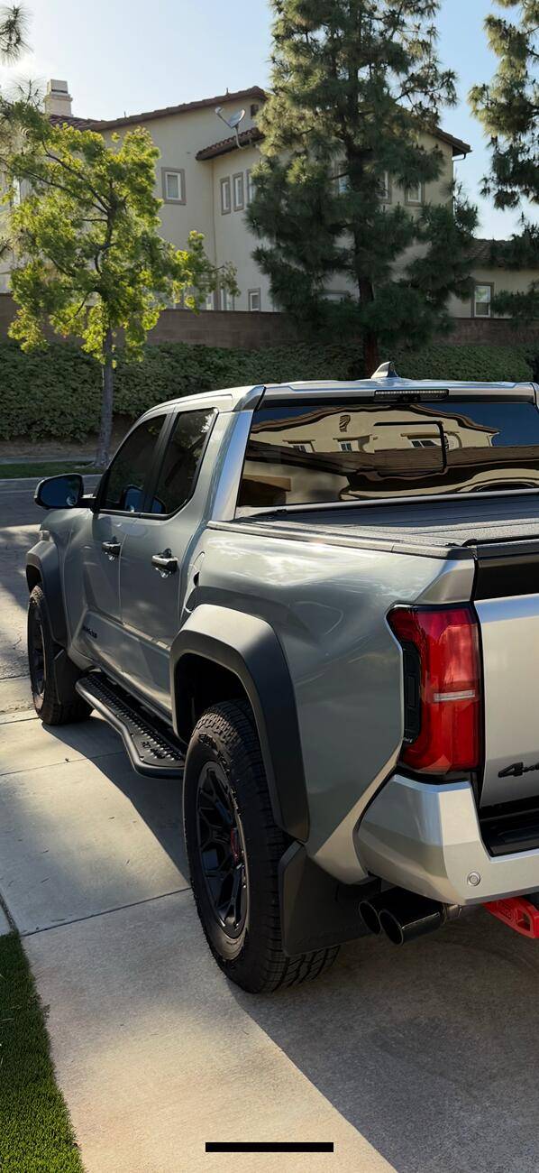

PK389-35R50-P1 would be flush with the wider flares.

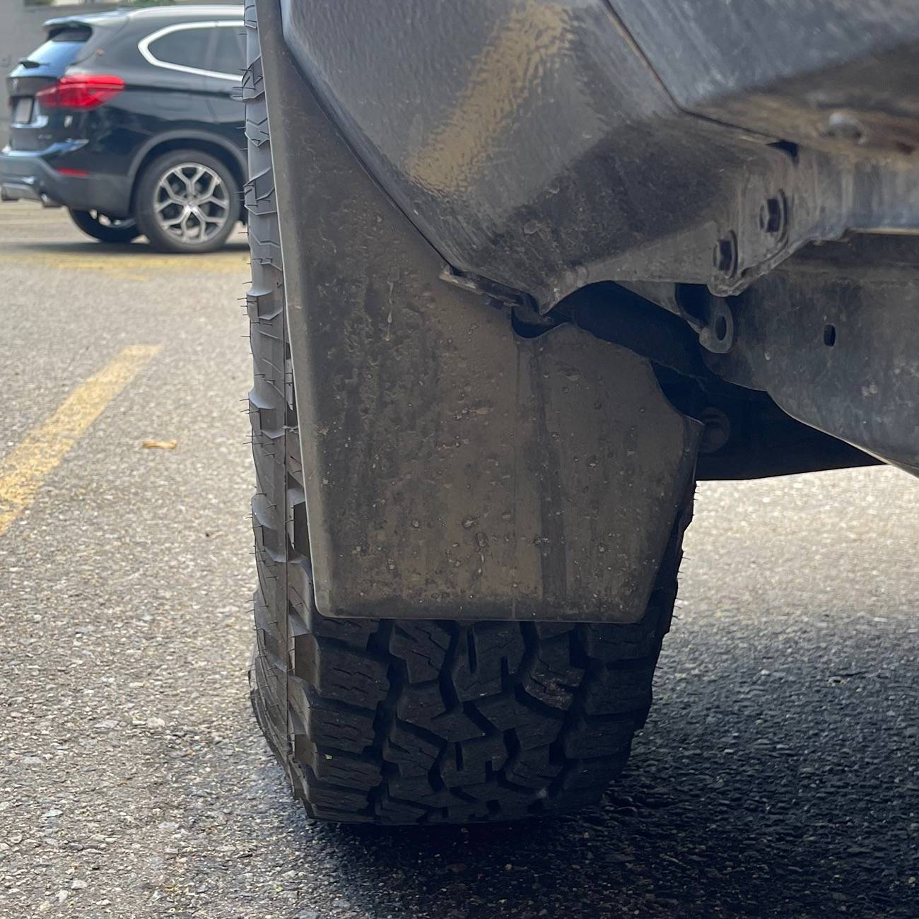

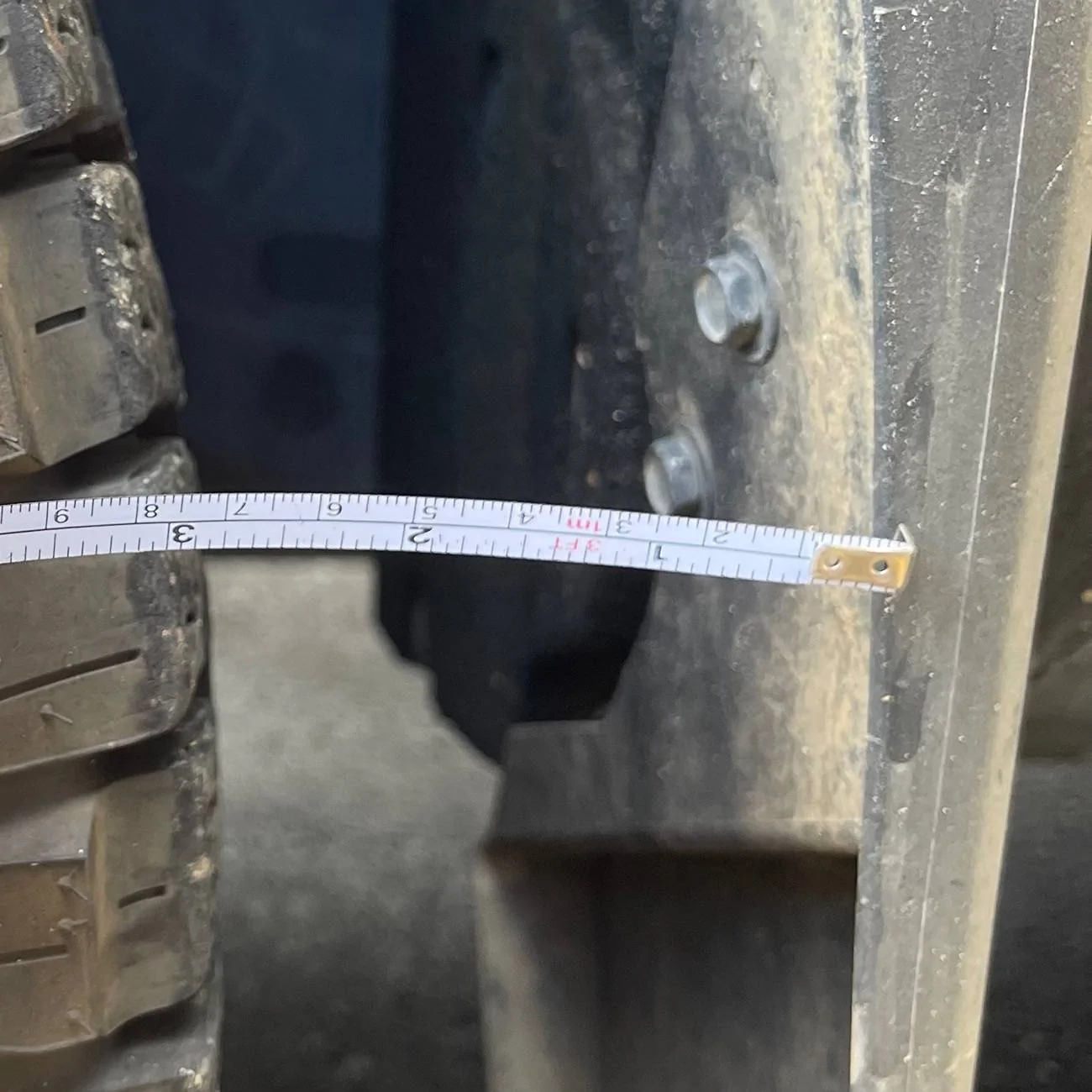

I've been following this thread for awhile, and it's interesting to see so much variance in rubbing based on trim/alignment even with the same size tires.

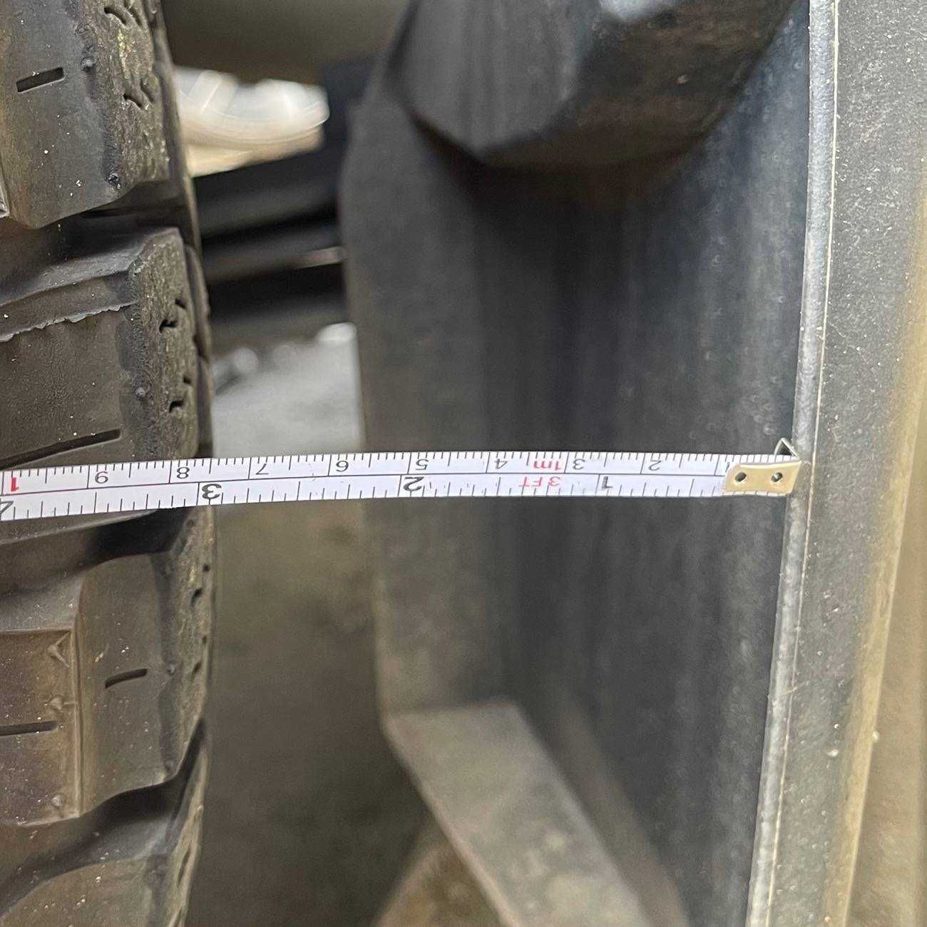

I was curious if anyone had more pictures facing towards the wheel wells to clarify clearances based on tire size and trim/alignment. It seems like my SR has quite a bit of clearance, even with 33’s on. About 3 inches to tire from front and back guards. Does anyone know what the depth width of the Canadian mudguards is into the wheel well?
I've got the SR on 255/80r17s (stock mudguards 76625-AK010, 76626-AK010, 76621-AK010, 76622-AK010)
Front:
2024 Tacoma OEM mudflaps. Canada vs US. IMG_9345
2024 Tacoma OEM mudflaps. Canada vs US. IMG_9349
2024 Tacoma OEM mudflaps. Canada vs US. IMG_9348
Rear:
2024 Tacoma OEM mudflaps. Canada vs US. IMG_9337
2024 Tacoma OEM mudflaps. Canada vs US. IMG_9351
2024 Tacoma OEM mudflaps. Canada vs US. IMG_9340
and it looks like I've got enough clearance to run the Canadian PK389-35R00-P1 (medium width) or PK389-35R50-P1 [may have changed to PK389-35R55-P1] (full width) according to https://www.tacomaworld.com/threads/oem-mudflaps-pk389-35r50-p1-vs-pk389-35r00-p1.858176/
I do take the truck off the beaten path enough that the stock mudflaps don’t really do much with the inward angle as they go lower. I think I may go for the medium (pk389-35r00-p1) because I have skinny tires, but I do want more of that protection than stock
