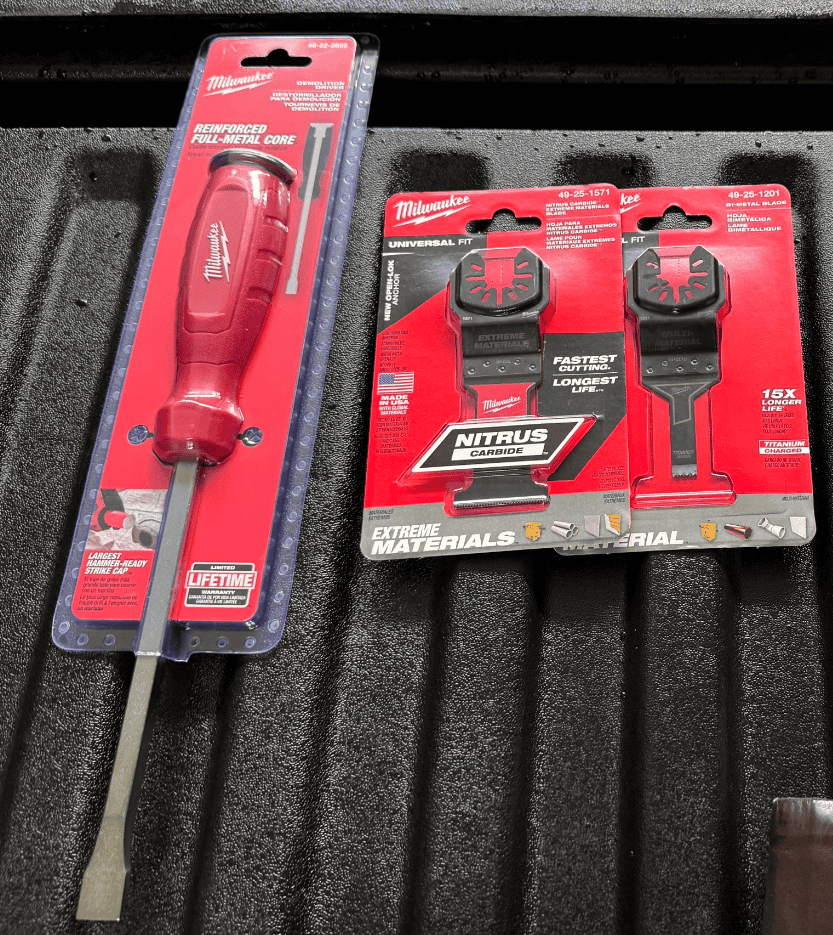

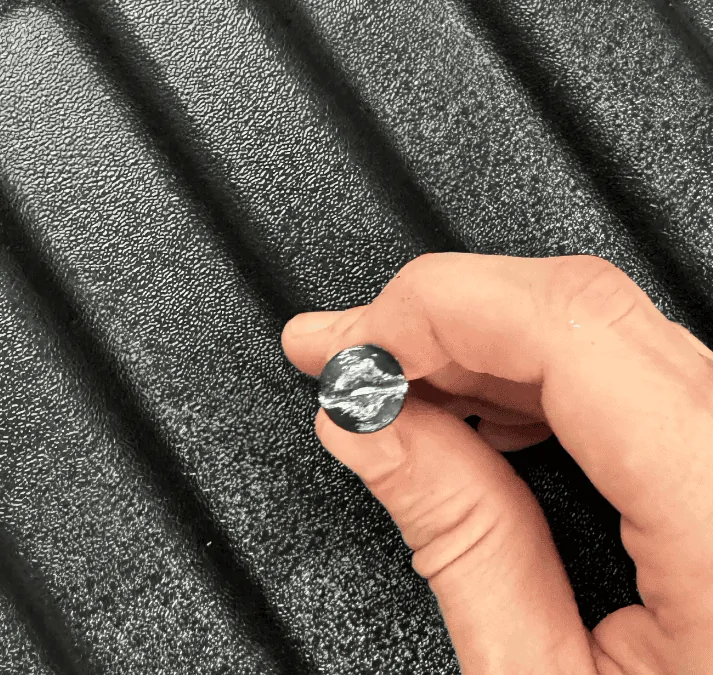

1. The TORX T30 bolts in the deck rail can be wayyyy overtorqued from factory and strip out (this was the first time I ever stripped a torx bolt). Be careful removing these and maybe start with a manual driver instead of impact driver. My resolution was to use my oscillating tool to cut a big slot in the bolt cap, and then use a big 1/2" demolition slotted screwdriver to break it free. I had to use channel locks perpendicular to the driver to get enough torque to succeed. I attached a few pictures of the bolt and the tools I used.
2024 Tacoma OEM Trifold Hard Tonneau Cover PT954-35240 installed on 2024 Tacoma bolt_slot

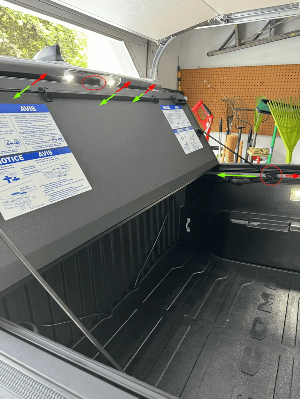

2. Starting with the rails, try to push them towards the cab of the truck as far as you can before securing. The reason, is you want to make sure the support arms (for when the cover is folded up against the back window) can reach the cover to lock in, without pulling the cover towards the tailgate. If they pull the cover towards the tailgate, it will prevent the foam pads from resting against the window, and likely block your rearview camera and/or hit against the painted part above the window. I have a photo showing where you should attempt to align the rail, and what you should try for (green arrows) as opposed to avoid (red arrows).

2024 Tacoma OEM Trifold Hard Tonneau Cover PT954-35240 installed on 2024 Tacoma support_arms_tem

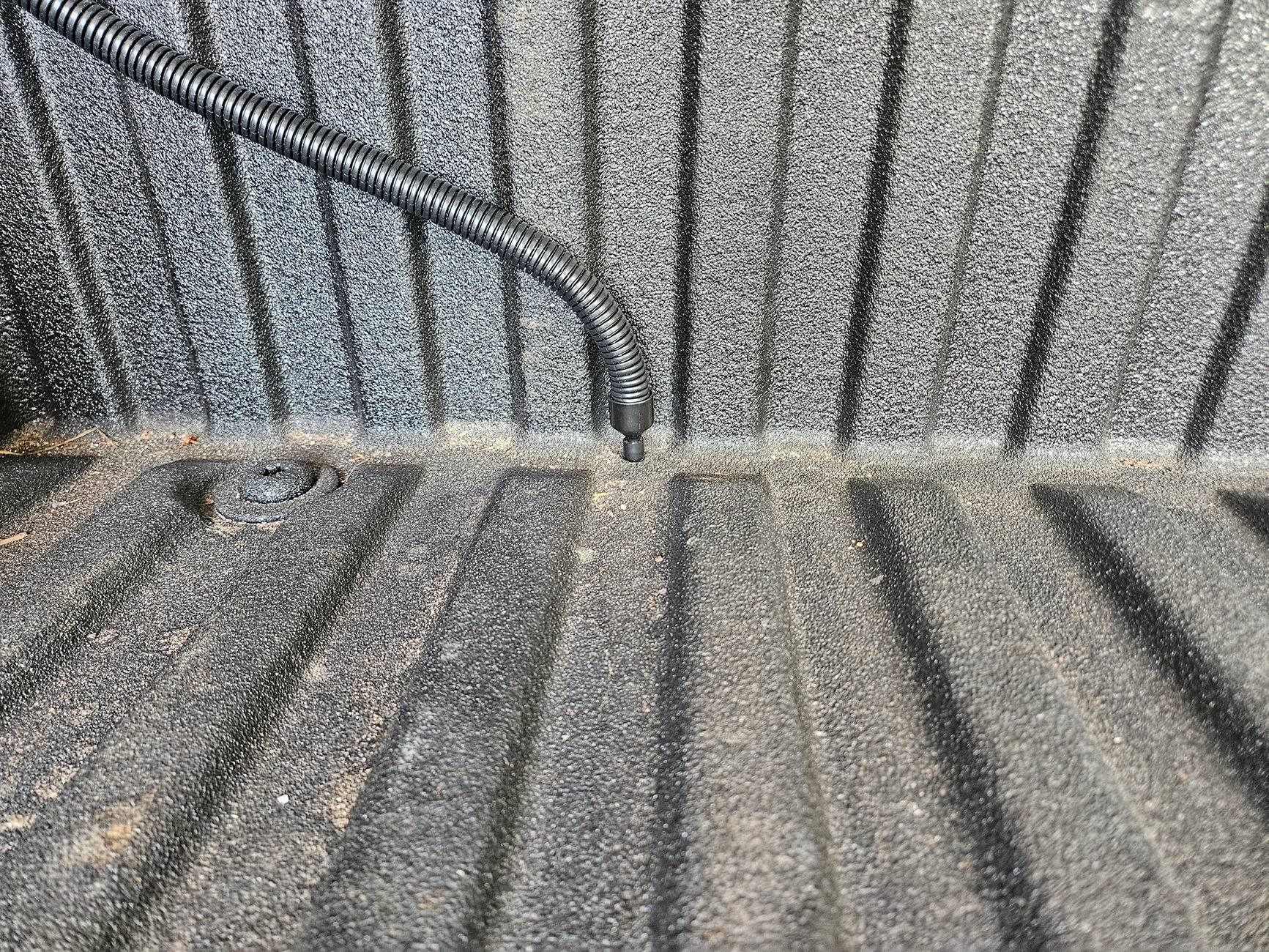

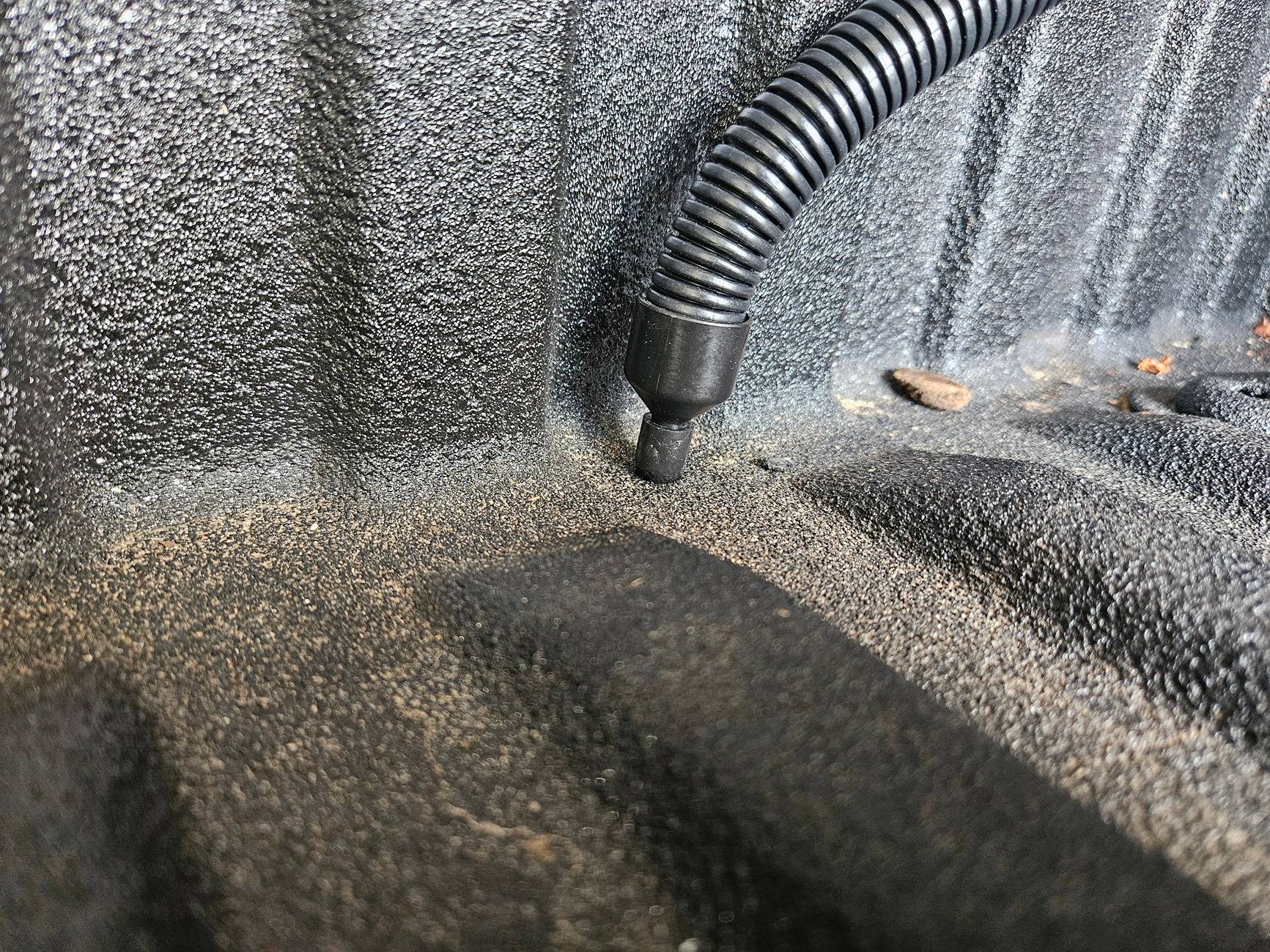

Not sure if anyone might still need this but I was FINALLY able to use the OEM drain holes after some support from Bakflip. I ended up contacting RealTruck to try and find a solution and they transferred me to Bakflip customer support. Long story, short they sent me the Ford Maverick drain tube adapters. They fit over the drain tubes that came with the Bakflip MX4 and I was able to install the adapters to the provided rubber tubing. What I ended up doing was stuffing the rubber tubing into the OEM holes, then connecting the other end to the adapter. From there I connected the adapter to the plastic tubing that came with the MX4. Hope this helps!

One of the hoses in my OEM kit was shorter than the other. Oh, and I only had ONE center hole, not two. So I ran both of them to the more exterior holes. Hope that is okay…
I wonder if we can order these adaptors... I ended up drilling a 3/8 hole but I would much rather use this and shorten my hoses a little... (I ran to the 2 center holes)
