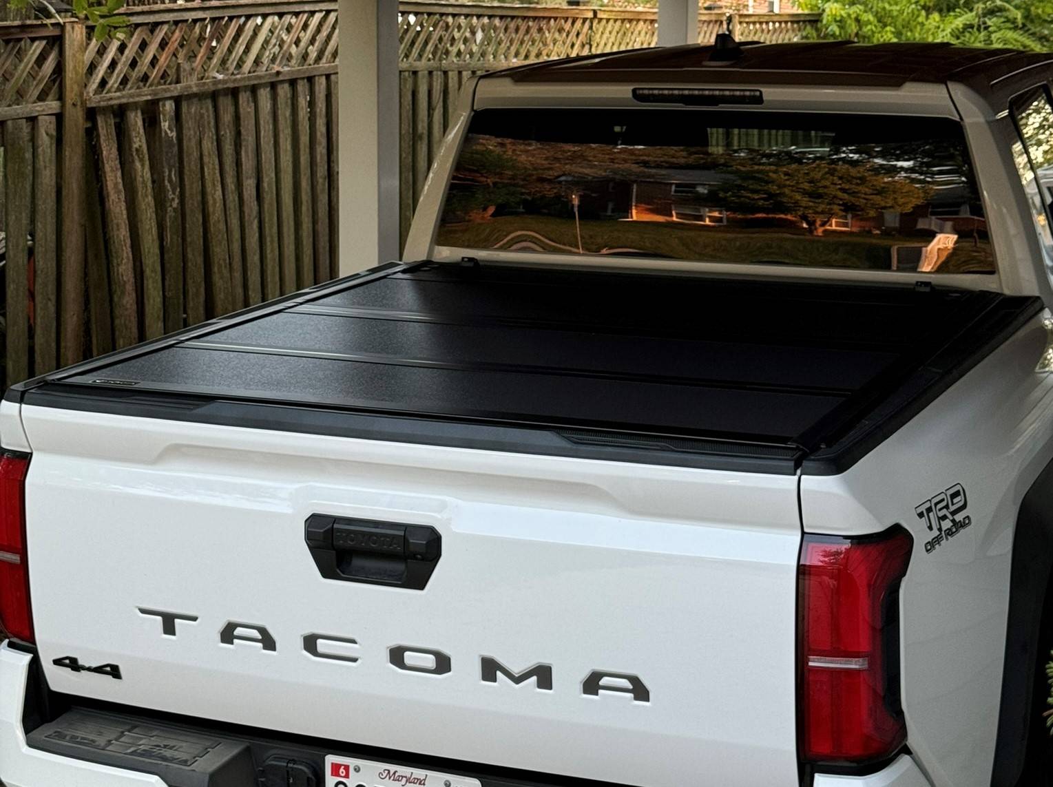

Just installed mine yesterday. Very easy to install, and it looks great too! I had to a bit of searching around my area to find one, but at around $1,000 for an 'OEM' tonneau cover, I definitely can't complain.
I don't know if anyone's done this yet, but I'm attaching the installation instructions here in case anyone needs a copy.
2024 Tacoma OEM Trifold Hard Tonneau Cover PT954-35240 installed on 2024 Tacoma Bed Cover

Good call on the instructions. I would just say (and sorry that this doesn't help you much) but for others looking to buy one, be on the lookout for Toyota parts sales. I paid less than $800 for mine, even though I had to drive an hour and back to get it from a specific dealer.

Yeah, mine was discounted a bit (15% off I think), but they seem to be a bit difficult to find, and I'd imagine that sales would only make things more difficult. If you really want a bed cover, this seems like a very solid option, even at the retail price of $1,200, I wouldn't hesitate (unless your budget is really tight). It fits perfect, it looks sharp, and it feels very well built and sturdy. The fact that it's OEM is just icing on the cake!

I agree with all of this. Plus mine doesn't leak, is super-low-profile, and keeps all of my stuff safe and sound.

Great post, thanks for the instructions

Funny question - but can that Toyota sticker be easily removed from it?
