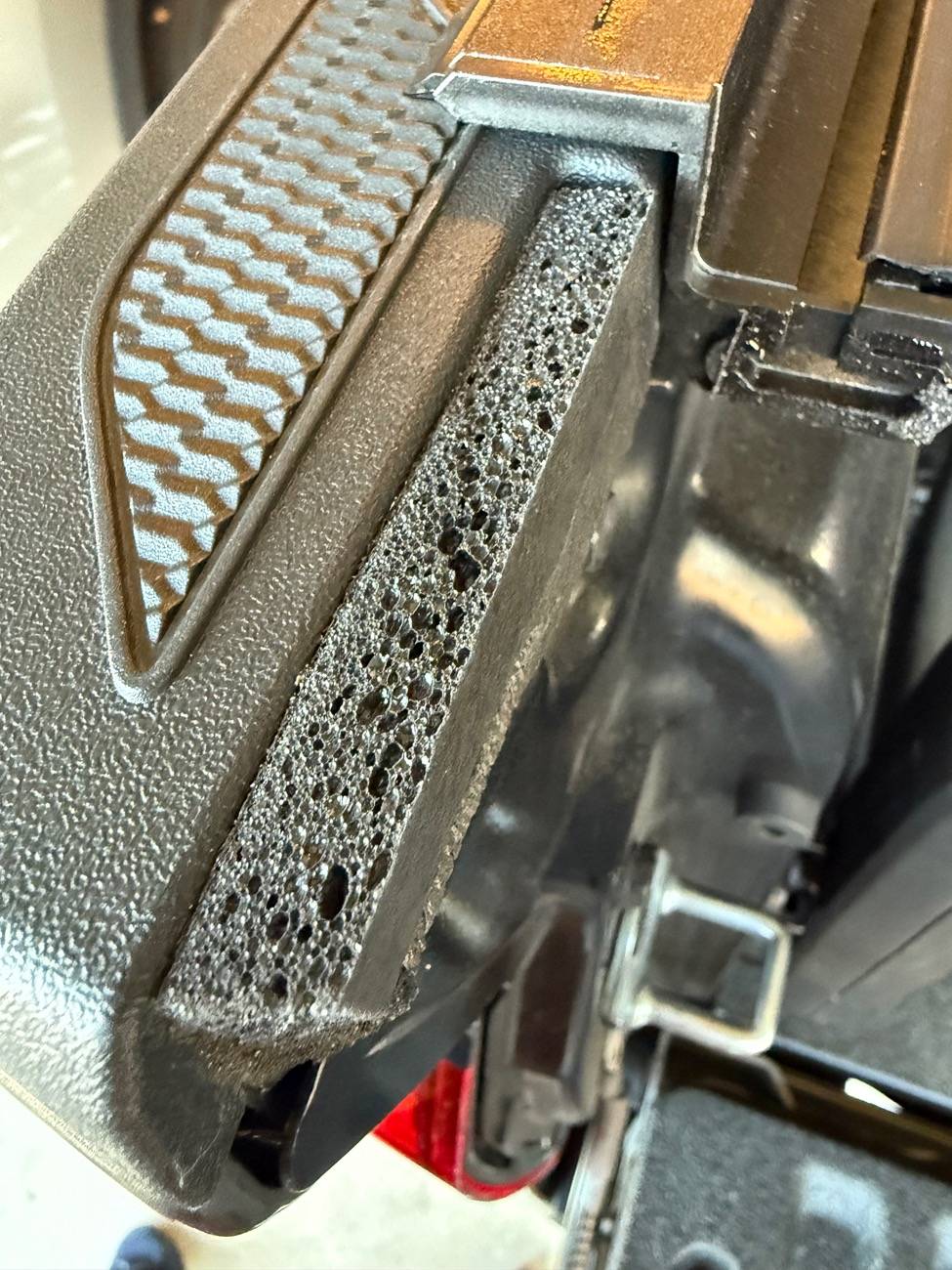

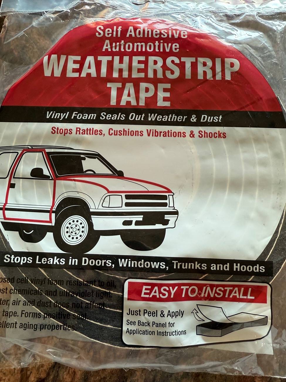

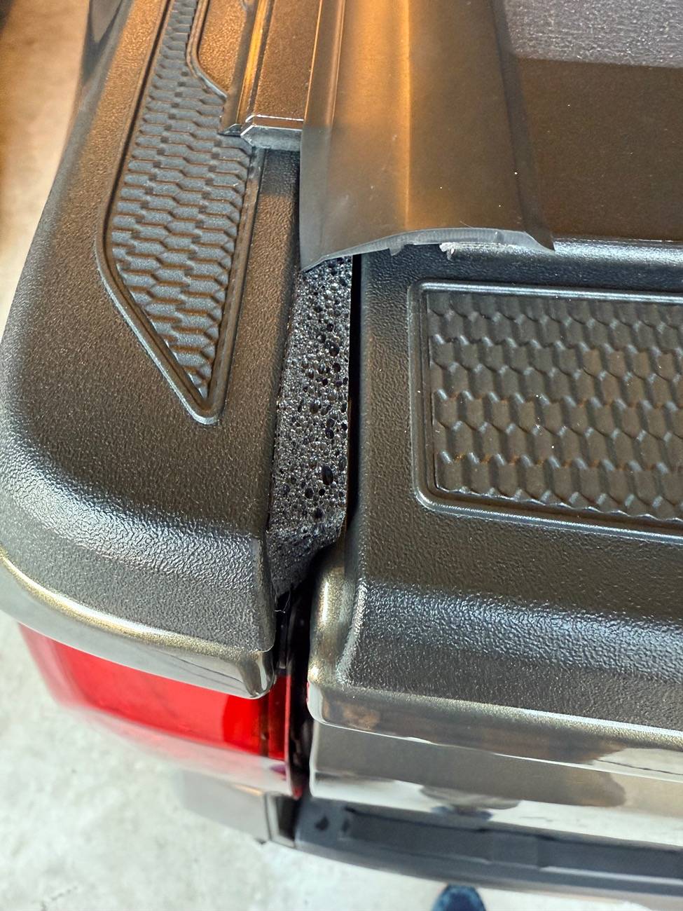

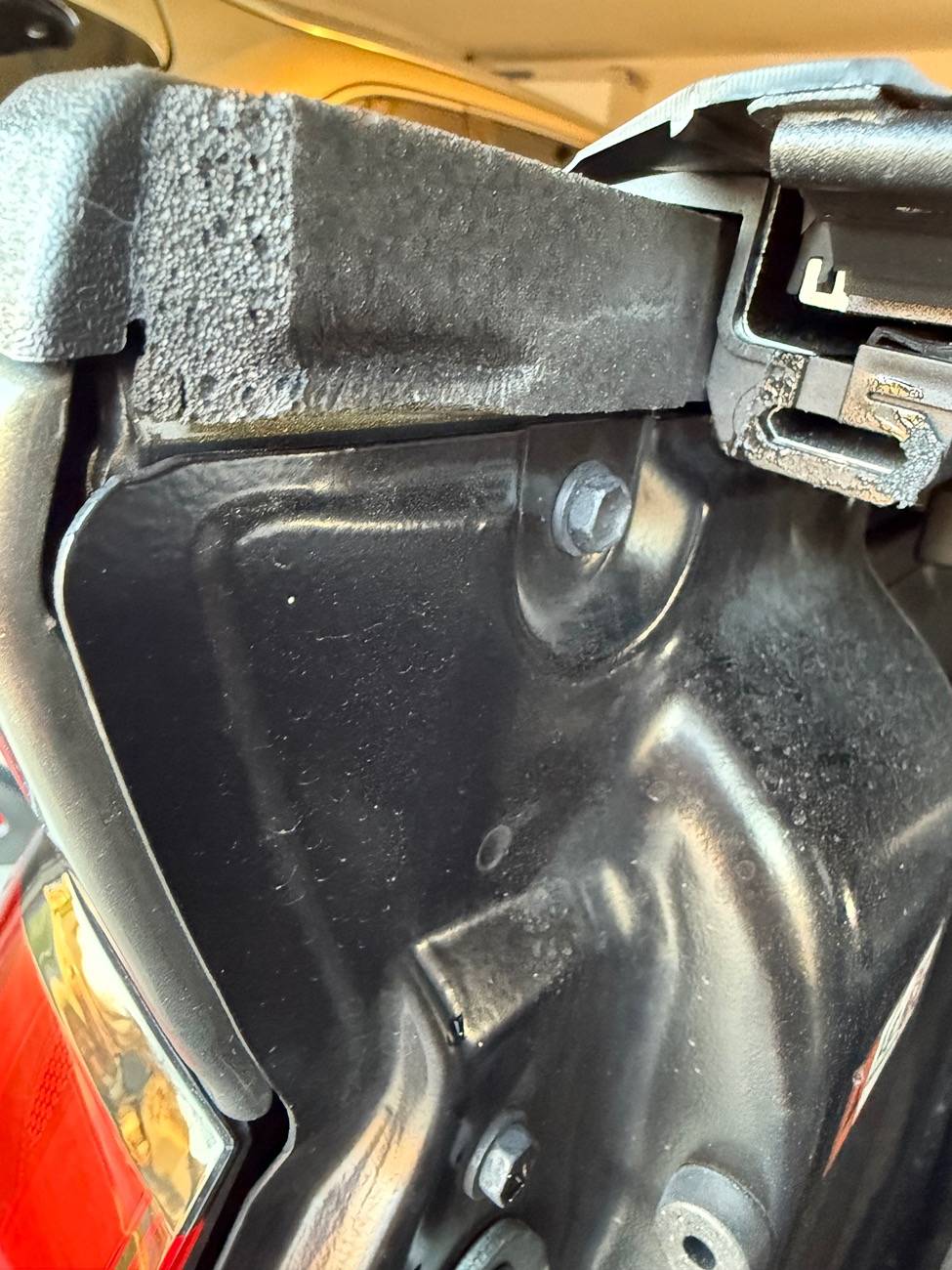

I did originally think water was coming in through the tailgate side gaps. I made these seals out of 5/16” x 1” Black Vinyl Foam weatherstrip tape. Fits perfectly. Does not interfere with auto tailgate

What did you use to adhere the foam to the sides? I’ll keep this in mind if I have any significant leaks

It is self-adhesive.

thank you! Took a screenshot and added as a mental note for if it leaks. I forgot to check before I left the house this morning and it had down poured overnight. I should’ve looked into it.

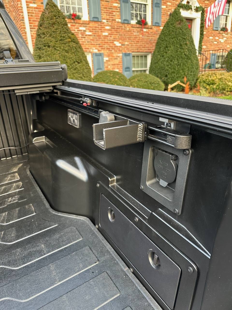

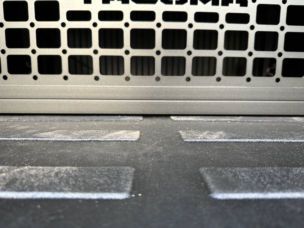

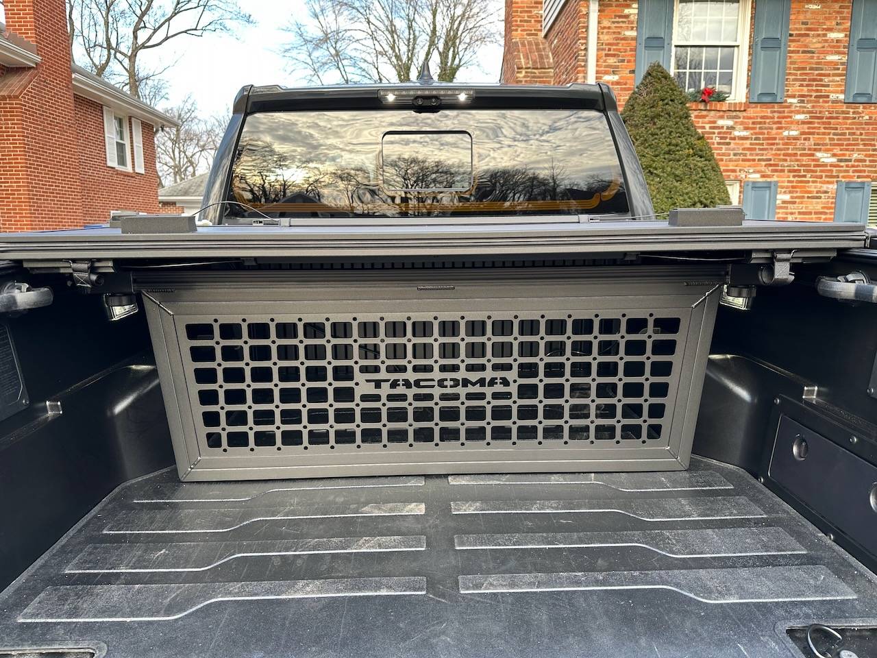

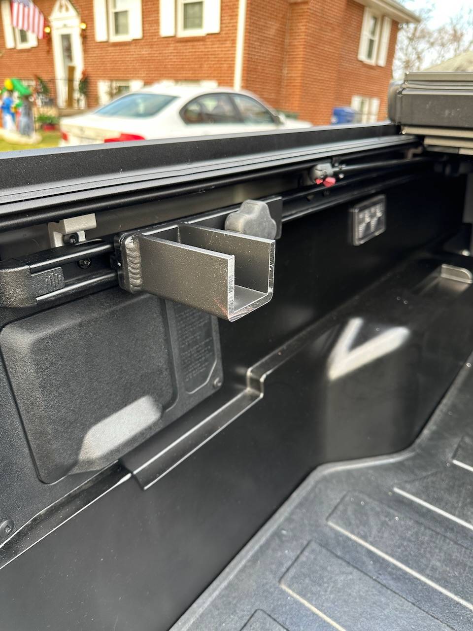

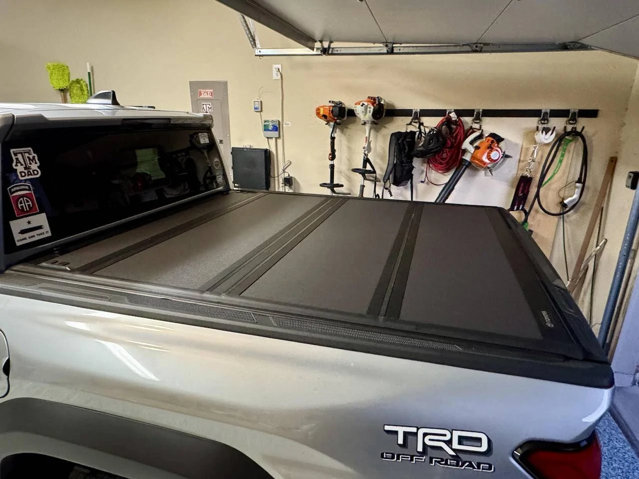

So I installed the OEM divider in my TRD Offroad today with OEM bed mat and OEM trifold cover.
The answer is yes it fits with about 1/8 in gap between the bottom of the divider and the mat. (at least in the middle of the bed where I placed mine).
Similar to what others have said I needed to cut 1/2 in off each end of the divider.
I also needed to cut 1/2 in off each of the two brackets so that the divider and welds fit between.
I found the aluminum to be soft and easily cut on my miter saw with fine tooth carbide tip blade. Left a clean cut. May paint the cut edges in the spring, but since it is aluminum not worried about rust just about appearance.
Very pleased with the outcome. Photos attached.
