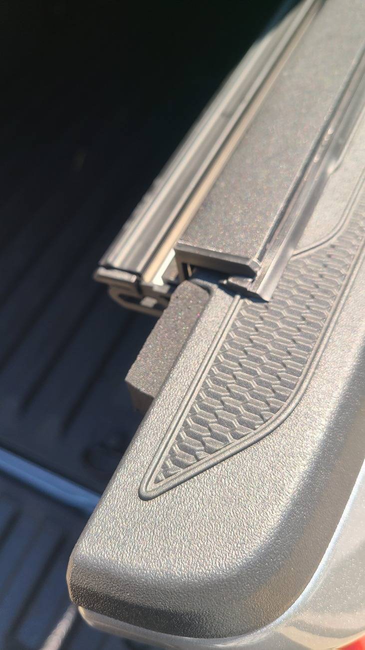

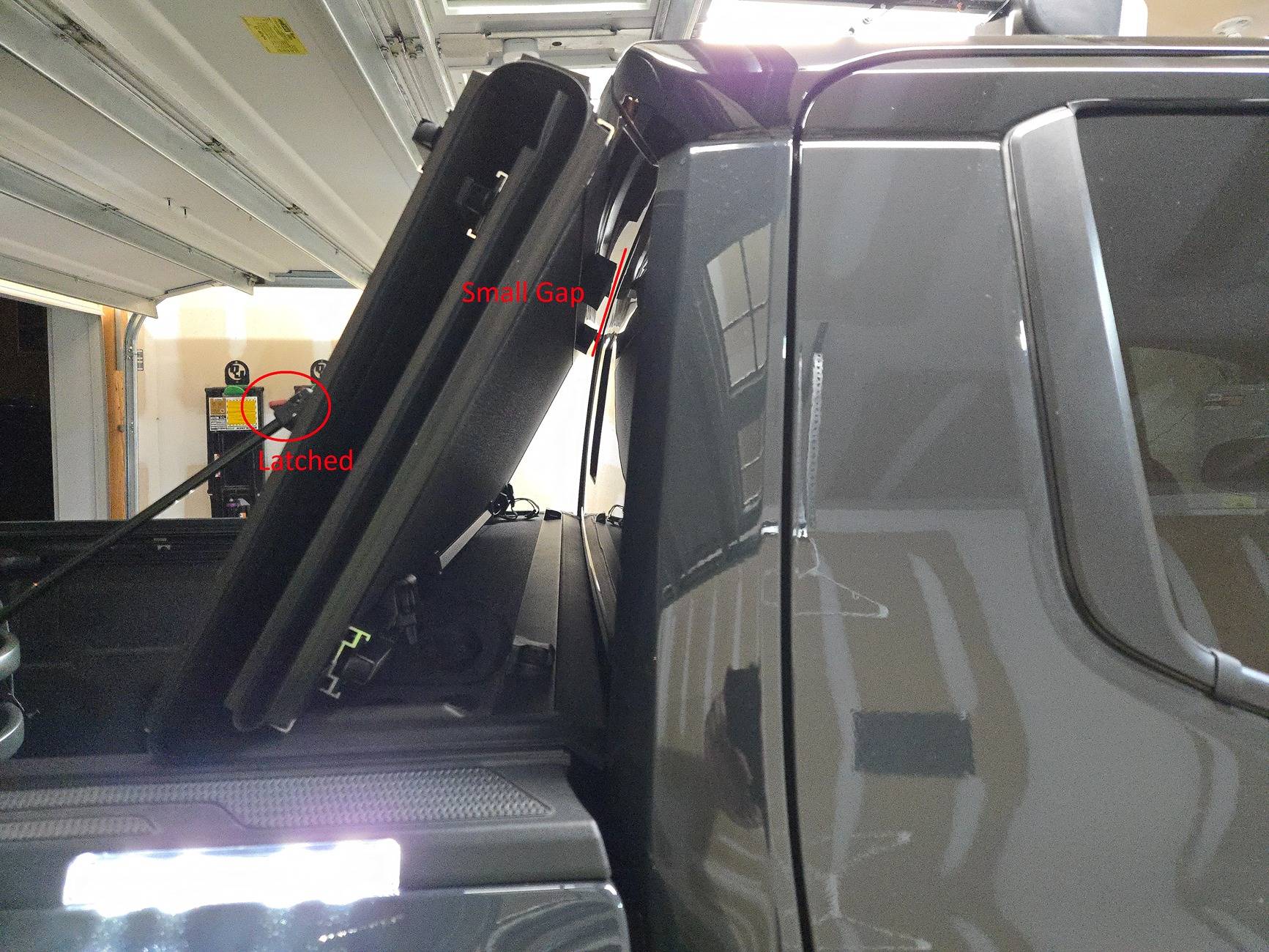

Question, when I fold mine all the way back (resting on the window) the "arms" are off by a few millimeters. If i latch both arms into place, there is a gap between the window and tonneau cover's "foam bumps". Essentially the arms are holding the cover in place from going forwards and backwards [i figured it rests on the window and the arms are just to prevent the wind in flipping it back down]. I'm worried it's putting too much stress on the arms and that specific part of the tonneau cover railing. The cover and rails are installed as per the instructions manual:
  • page 4 step (b) Before tightening, make the necessary adjustments to the rail so that is pushed forward and tight against the front bulkhead.
  • page 8, step (h) Adjust the cover until the rear seal has the rearward most fin on top of the tailgate and the second fin leaning on the edge of the tailgate
Anyone else's looks like this? Perhaps this is an intended design? [the gap is only a few mm].. I was thinking maybe my foam blocks are placed incorrectly, but the gap exists regardless of placement.

Mines also like this, and I slid it all the way back towards the tailgate so I can still use my digital rear view, it moves a bit in the wind but I don’t know why else the rods would be there if you couldn’t transport while folded up

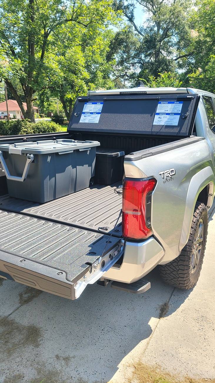

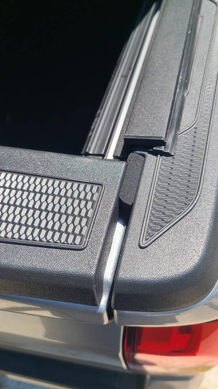

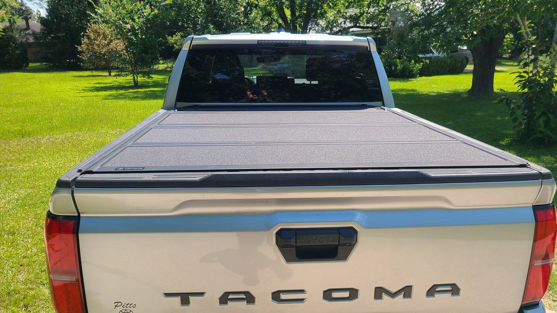

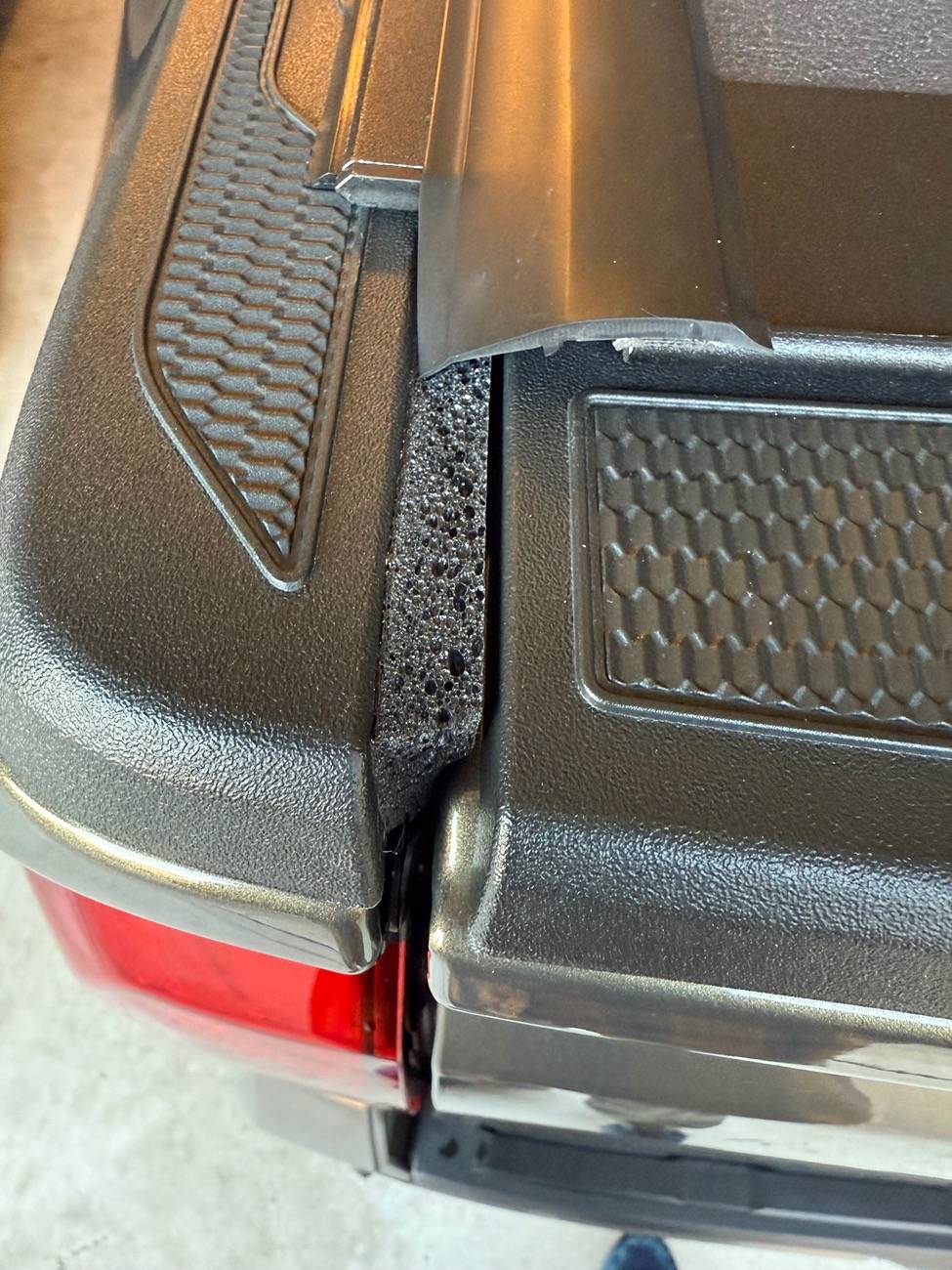

Hey, new Tacoma owner here and found this forum and have learned a good bit about my new truck so far. After looking on here I decided on going with the OEM hard tonneau cover. It was a pretty easy install, only taking about an hour. Fit seems tight but I put a piece of weather stripping in the gap by the tailgate after seeing another forum member say that they stopped leaks by doing it.

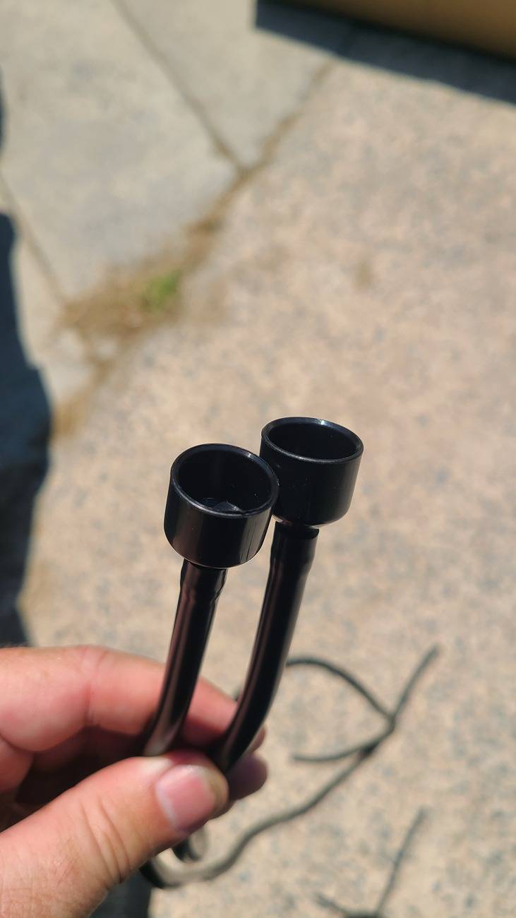

One thing though, is that the adapters for the drain tubes are loose and will fall off easily. Has anyone had this problem and if so how did you fix it? I was thinking that I could just use electrical tape or a small hose clamp.
Anyway, thanks yall!

Can you show a pic of where you added the weather stripping to deal with leaking?
@conky my drain tube adapters were the same way, would fall right off. Haven't done anything yet but I think I'm just gonna put a dot of super-glue on the adapter as I don't see any reason why I would ever need to take it off in the future...

Yeah, it might be my fault too. I adjusted the foam pads and I'm going to try to see if I could get it to not touch the truck when I prop it up. I am talking about the MX4, not the OEM.
Did you ever solve this issue? I had the same problem the last time I went camping so I'm trying to avoid that this time. Any pics of the fix would help a ton! Thanks.
