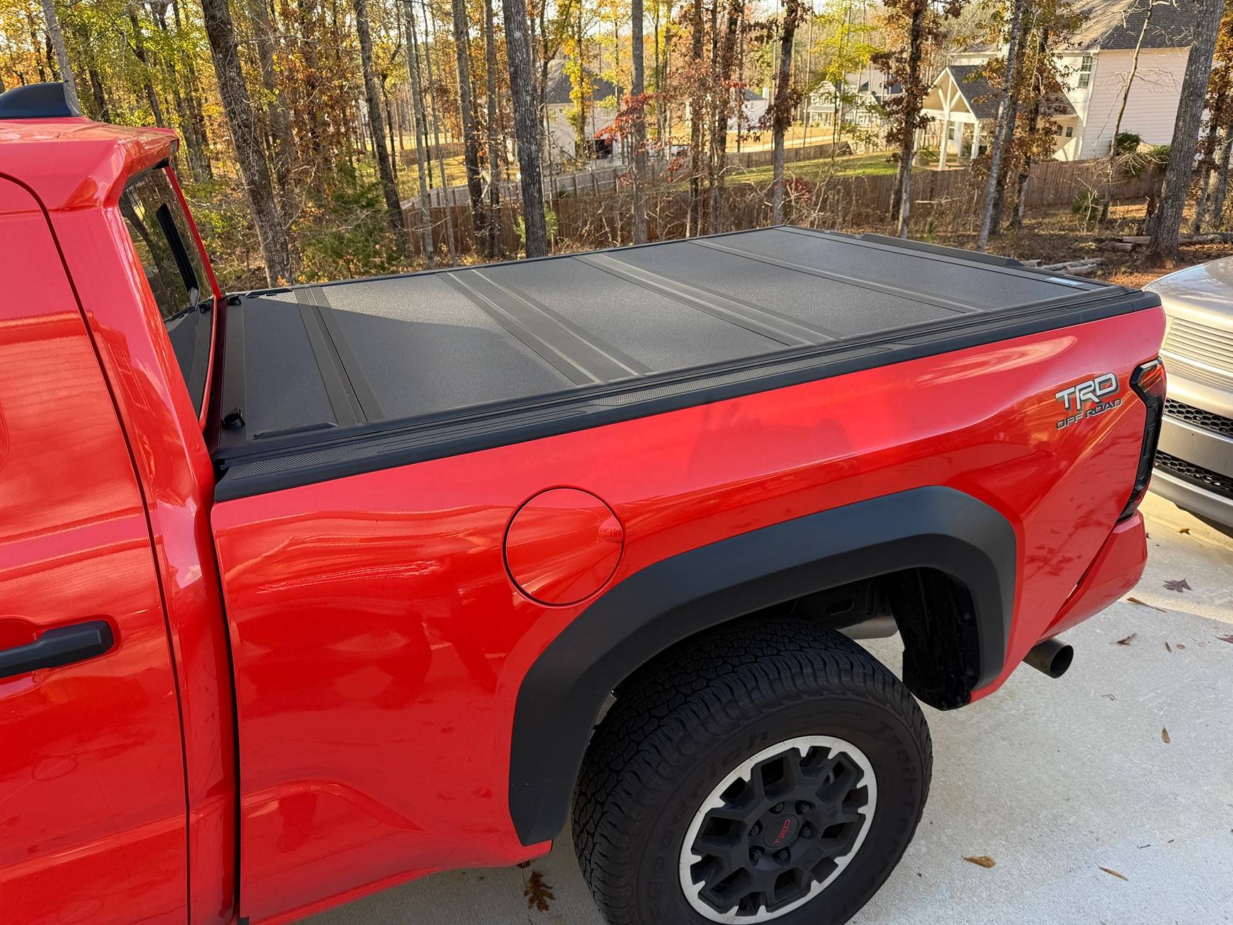

I just installed my OEM Cover. It was quite easy even with one bad arm (recent elbow/wrist surgeries). I am happy to report there are no issues with the automatic tailgate operation. Also, the rearview mirror camera option still has 100% coverage with the cover folded up and connected to the stays. After reading some comments about difficulties with alignment, I decided to mark the cover’s position near the bolts. When I folded the cover back up to allow tightening of the bolts, I was able to confirm it did not move out of alignment. I do have one question: Why does the driver’s side drain tube have to go to the center bed drain hole (per OEM instructions)? I could not see a reason for this from underneath the truck. Being a good boy, I followed instructions. I plan on using some 3M cable mounts to hold the hoses against the bed side. Before doing that I may move the left one to the other drain hole if no one offers a reason not to. Thanks
2024 Tacoma OEM Trifold Hard Tonneau Cover PT954-35240 installed on 2024 Tacoma IMG_5788
2024 Tacoma OEM Trifold Hard Tonneau Cover PT954-35240 installed on 2024 Tacoma IMG_5783
2024 Tacoma OEM Trifold Hard Tonneau Cover PT954-35240 installed on 2024 Tacoma IMG_5789

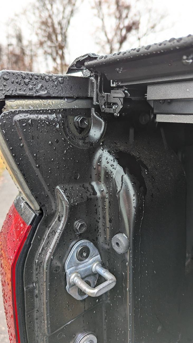

I was able to crawl into the bed and close the tailgate while the truck sat out in the rain. I found out at least where the water is entering the bed. The gutters are being overwhelmed. The rain was moderate (not heavy, not light). This has to be water collecting on the panels not leaking through the side gaskets. Surely this can’t be normal. First I pulled the hoses from the drain holes to confirm they were flowing. They were. Just too much water for them to handle.

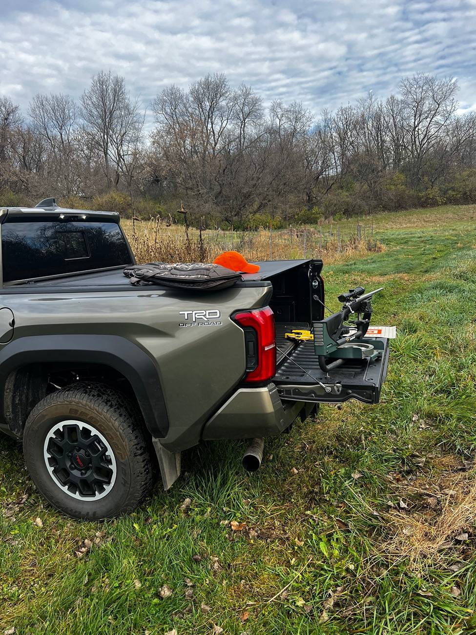

Thanks for posting the instructions. Installed ours last month. Here’s a pic - getting ready for deer season.
The tubes are simply too small to deal with anything greater than a drip. I think the tubes need to be 3/8" but darn if I don't want to drill that size hole in my bed. ;)
Any update or progress on this? I was just checking mine if a light rain and had water coming in that area. I pulled the tubes and saw no flow at the hole, but some water dripping from that section. I think that rear cutter section is not water tight and allows water to just bypass the hose holes and enter the bed. I would love to investigate the "gutter assembly" on the rail without the cover on. But I don't want to take my cover off to do so. Maybe someone could post some picks before they install.
I also had some water coming in from the tailgate side. I think it was from parking at an angle and water dripping back at the rail gutter, landing in the bed.

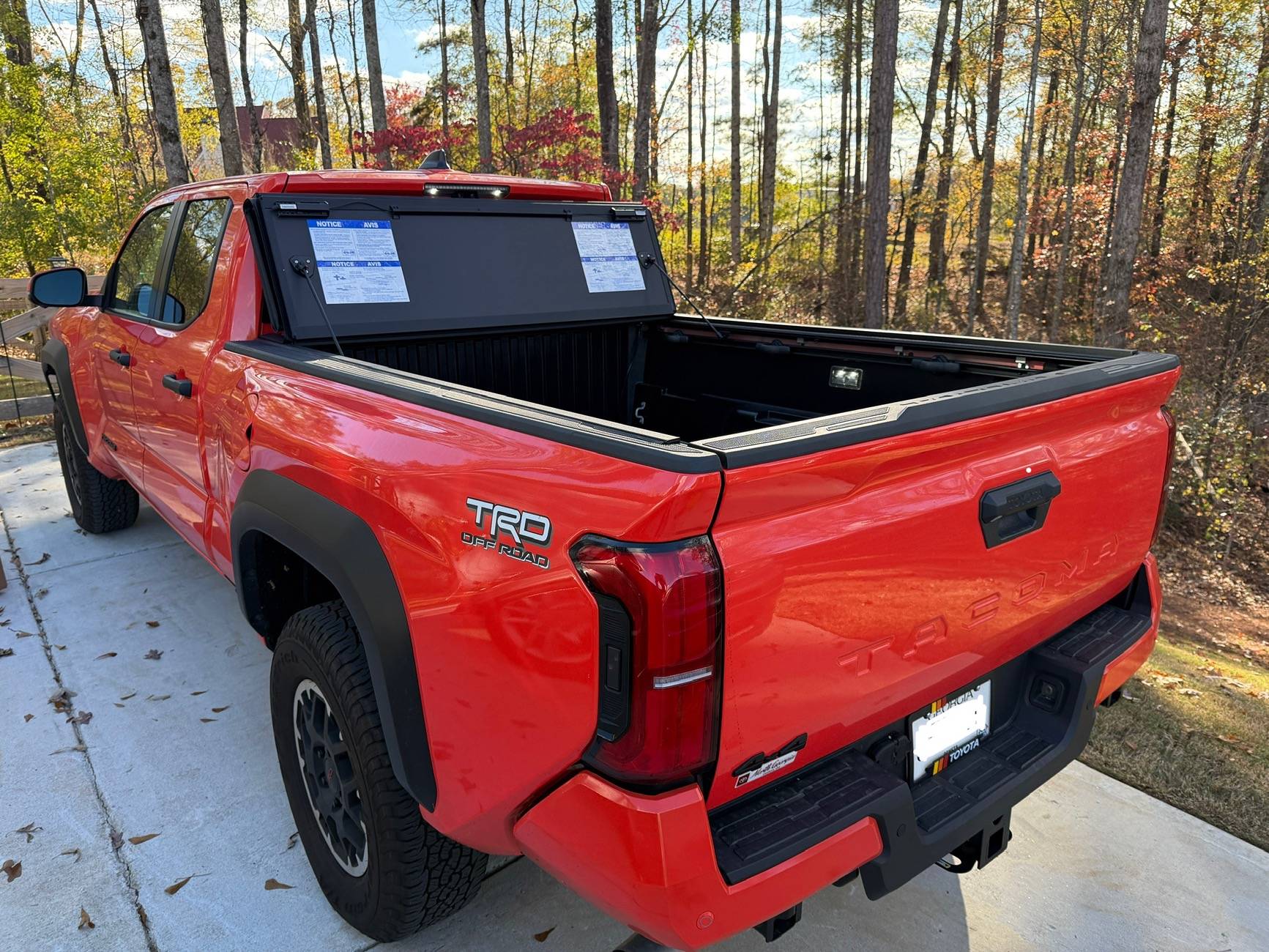

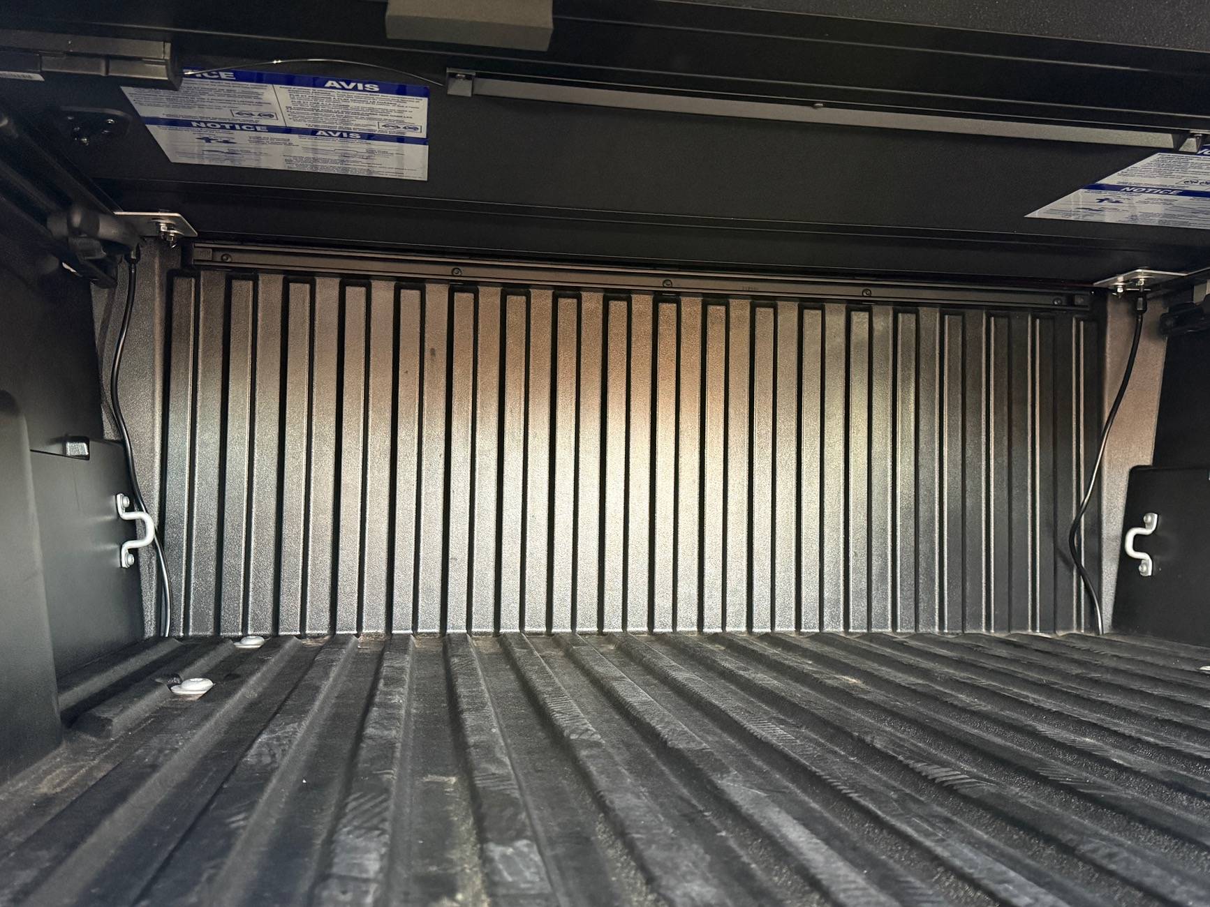

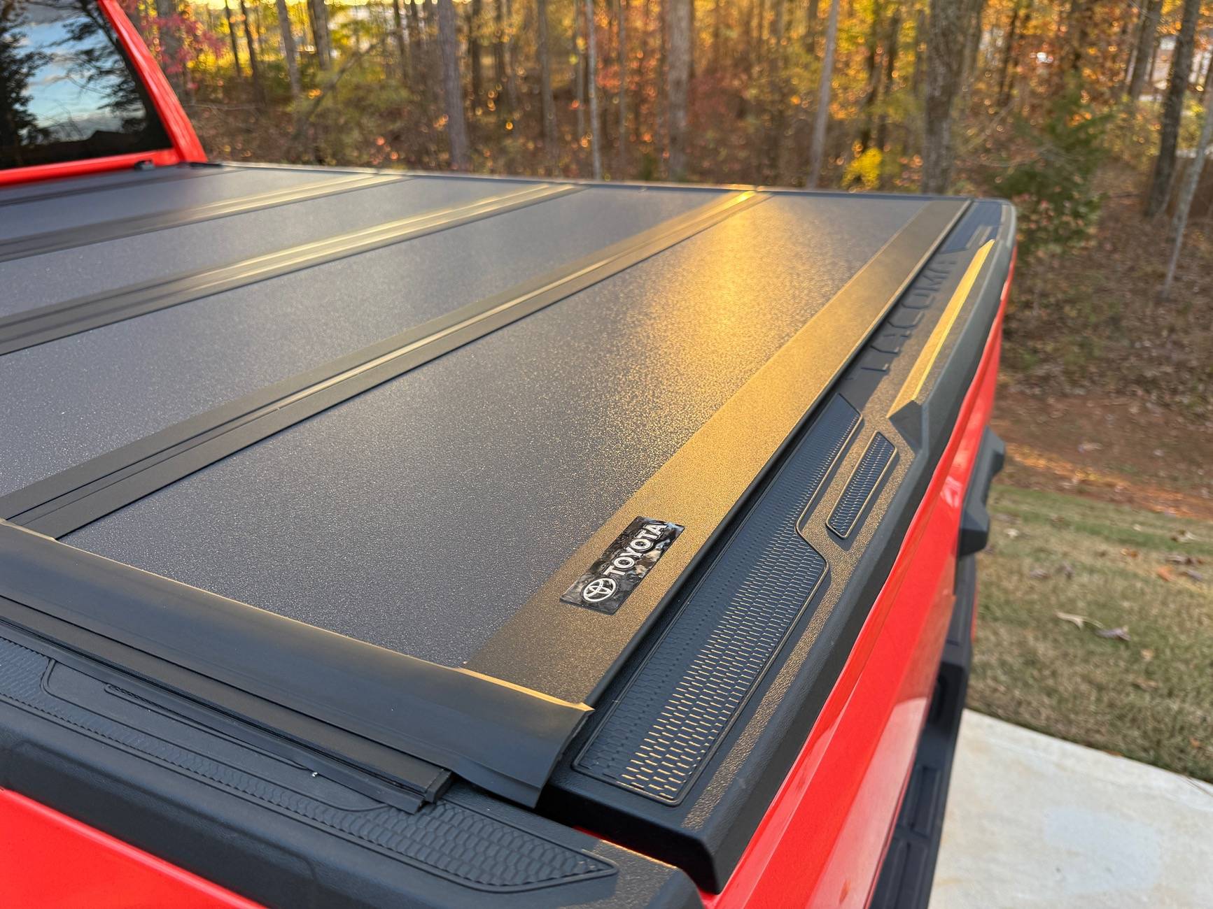

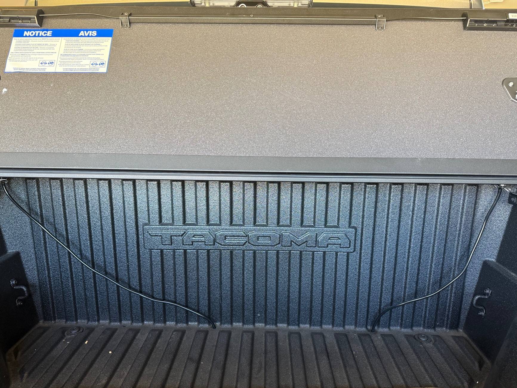

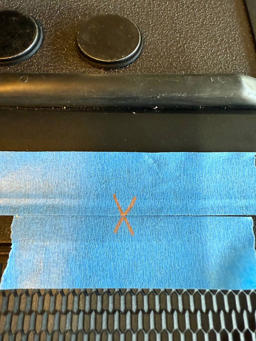

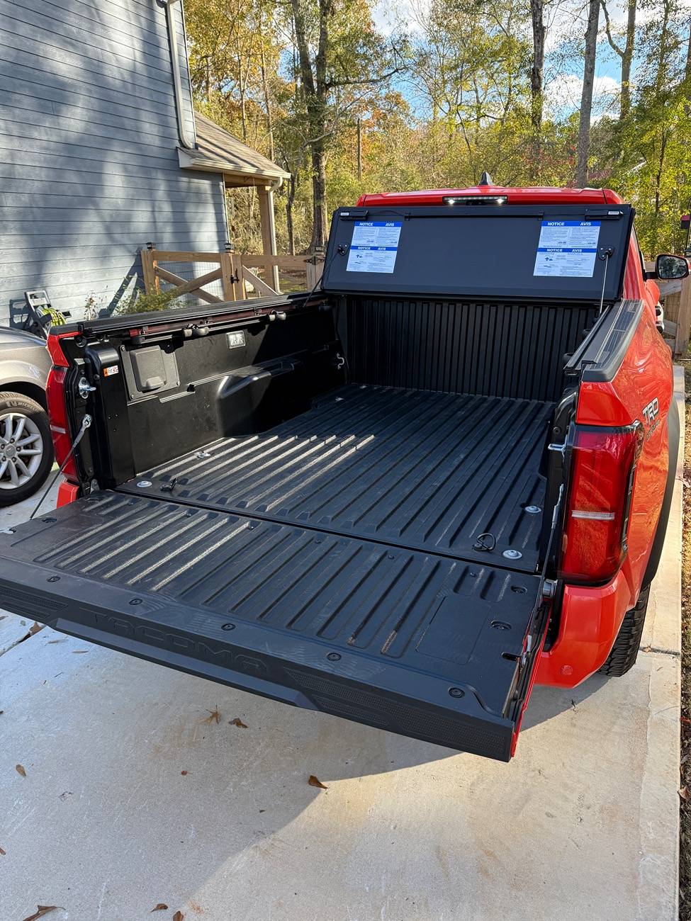

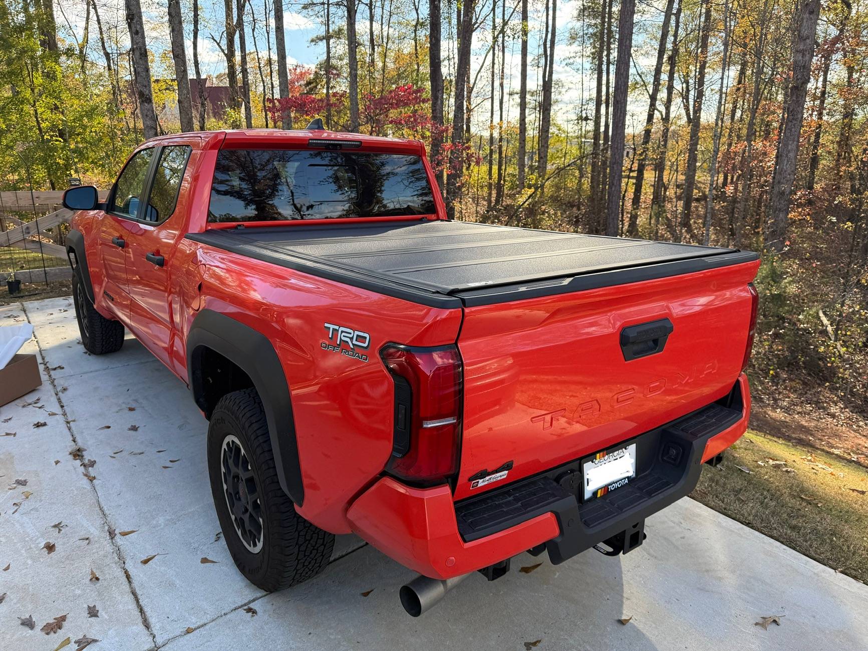

I too just installed the OEM on my 6’ OR. Overall an easy install. I also used the tape trick that @Randyg above did to ensure the cover stayed aligned whilst tightening the bolts down.
Had a 20% coupon sent to me by the dealer where I purchased the truck on top of the small discount that was applied for a current sale. Drove about an hour and a half each way to avoid the astronomical shipping cost.
Also, I’d already drilled holes in the corners near the cab to aid and drainage where my truck sits on our driveway at a slight forward and to the right angle, which was preventing rainfall from draining out of the bed as the original holes are not in the corners. Also, these are slightly bigger so I didn’t have any problem feeding the tube into it. Time will tell how much water leaks and whether I need to increase the tube size.
