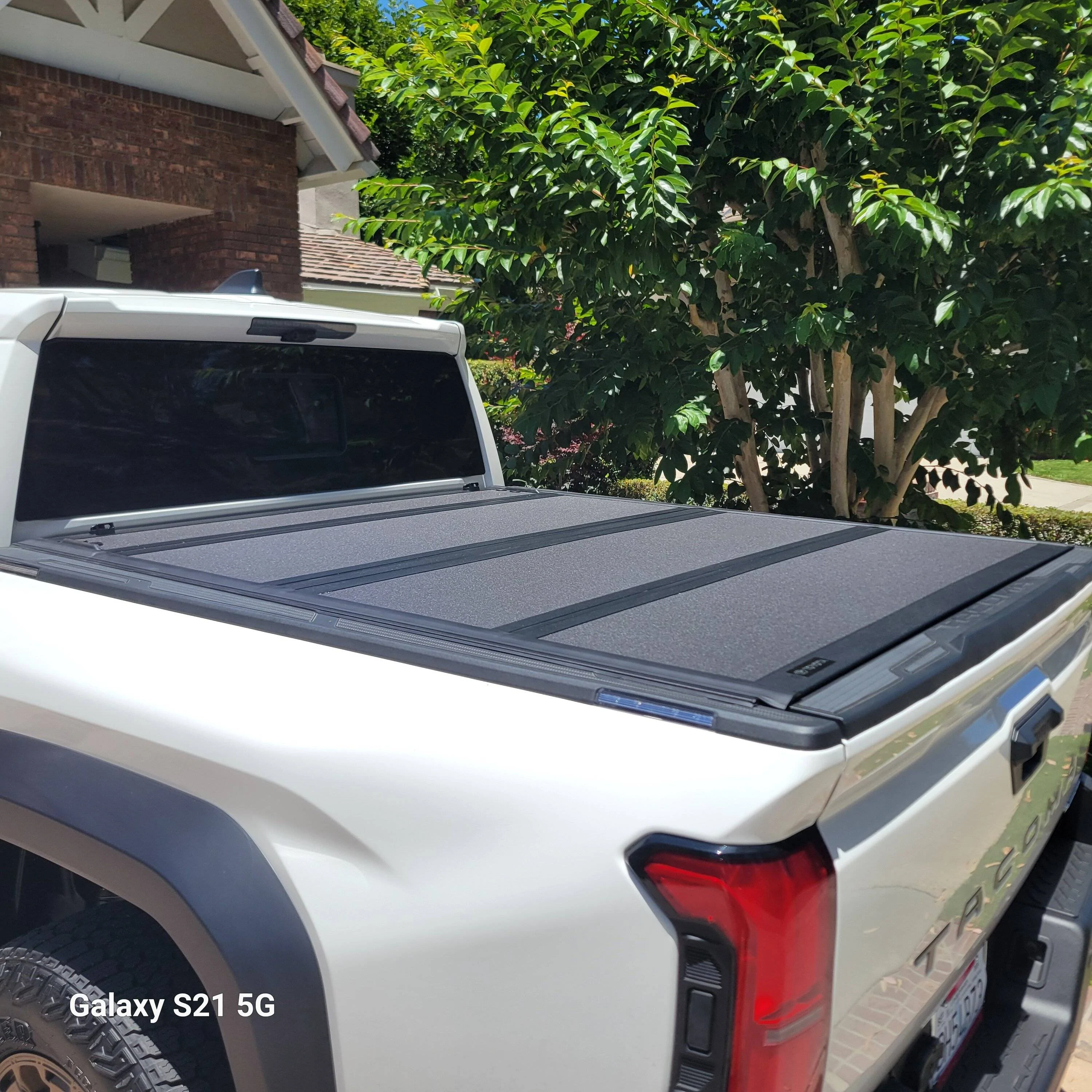

Ok, picked up my oem tonneau cover and I do have the oem instructions! My local dealer had no issues printing a. Ooy. Glad to scan them. If I can upload a pdf file here, I'll do so after I've installed mine today.
Installation was very easy.

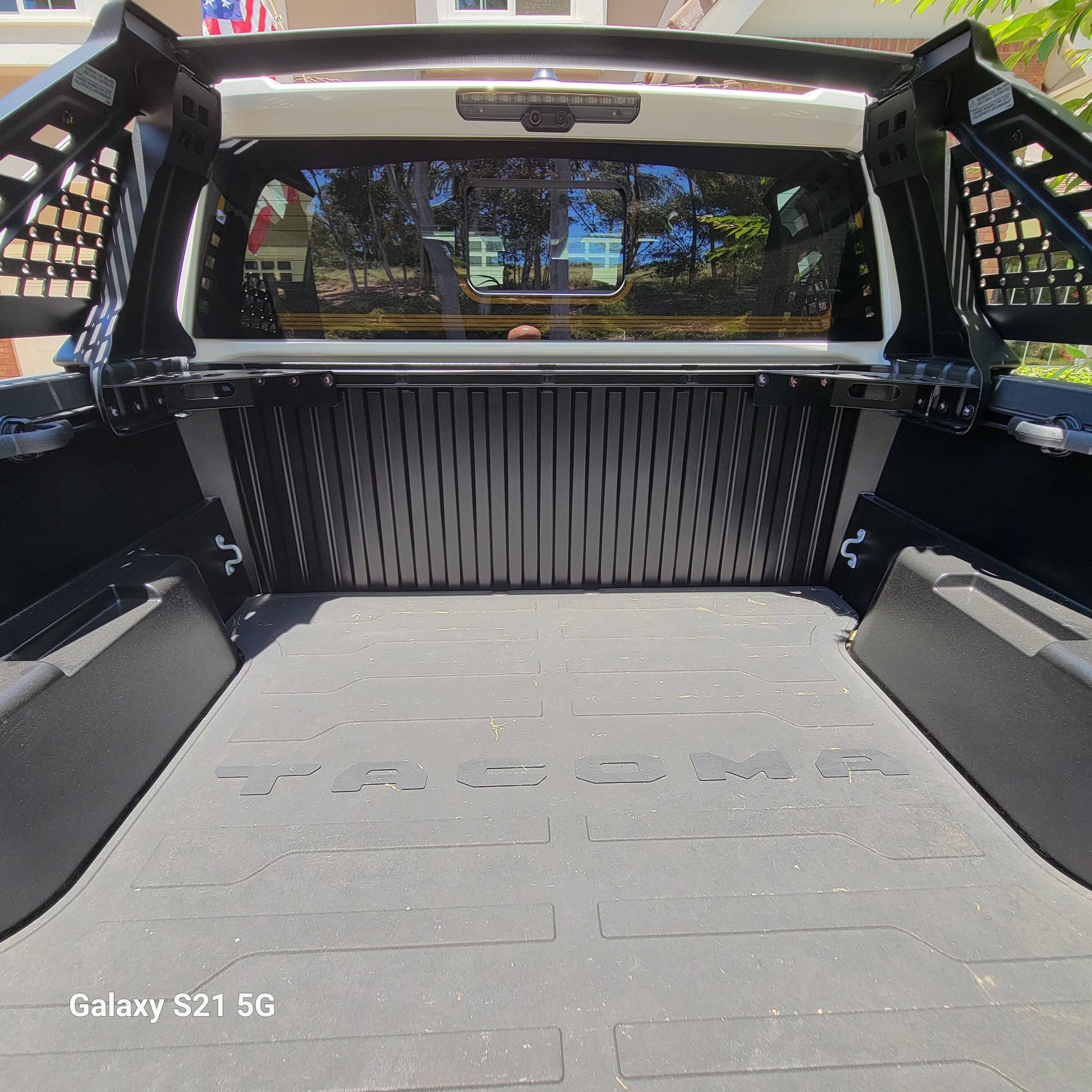

Ok, pics of how the Trailhunter ARB bar bolts into the factory rails. I'm inclined to just remove the bar in favor of the oem tonneau cover. The one thing, and only thing I think Toyota overlooked for offroaders was secure storage for camping gear. Anything now available means removal of the ARB bar.
