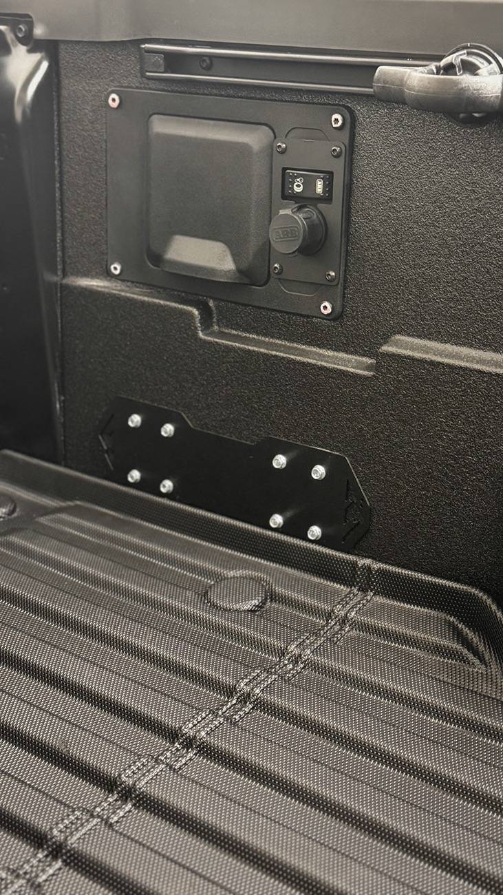

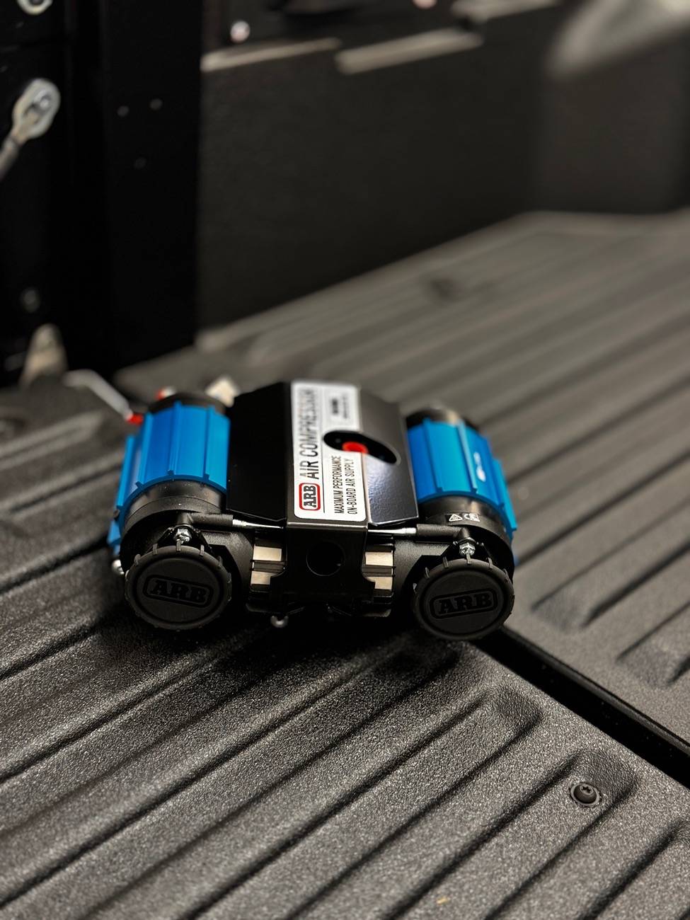

I stole some inspiration from the trailhunters and bed mounted this arb twin compressor. It’s nice and tucked out of the way. The only unfortunate part is the factory ARB power harness is about a foot too short for the hybrid models so I had to extend that harness. It was a little nerve wracking cutting and drilling into the bed of this brand new truck but it turned out almost factory looking other than the silver bolts I used are driving me nuts.
Clean install! What bracket and stuff did you use for the install? Is it all included with the ARB or did you buy seperate? Thanks

The bracket I used was a universal bracket for the arb compressor and used it like a backing plate. And the switch and coupling mount is from arb but had to be purchased separately.

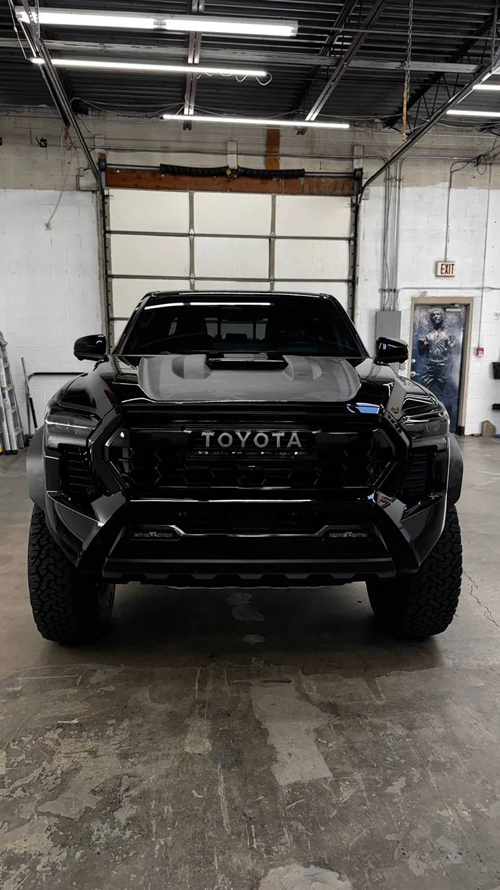

Yeah we talked about where to end the camo wrap on the tailgate and decided on to keep it similar to stock, because the issue that comes up, is where on the fender do you stop without it looking funny. But I agree on the black truck it’s not as stark of a difference as on the other colors. Just finished the last bit of camo on the hood today!
