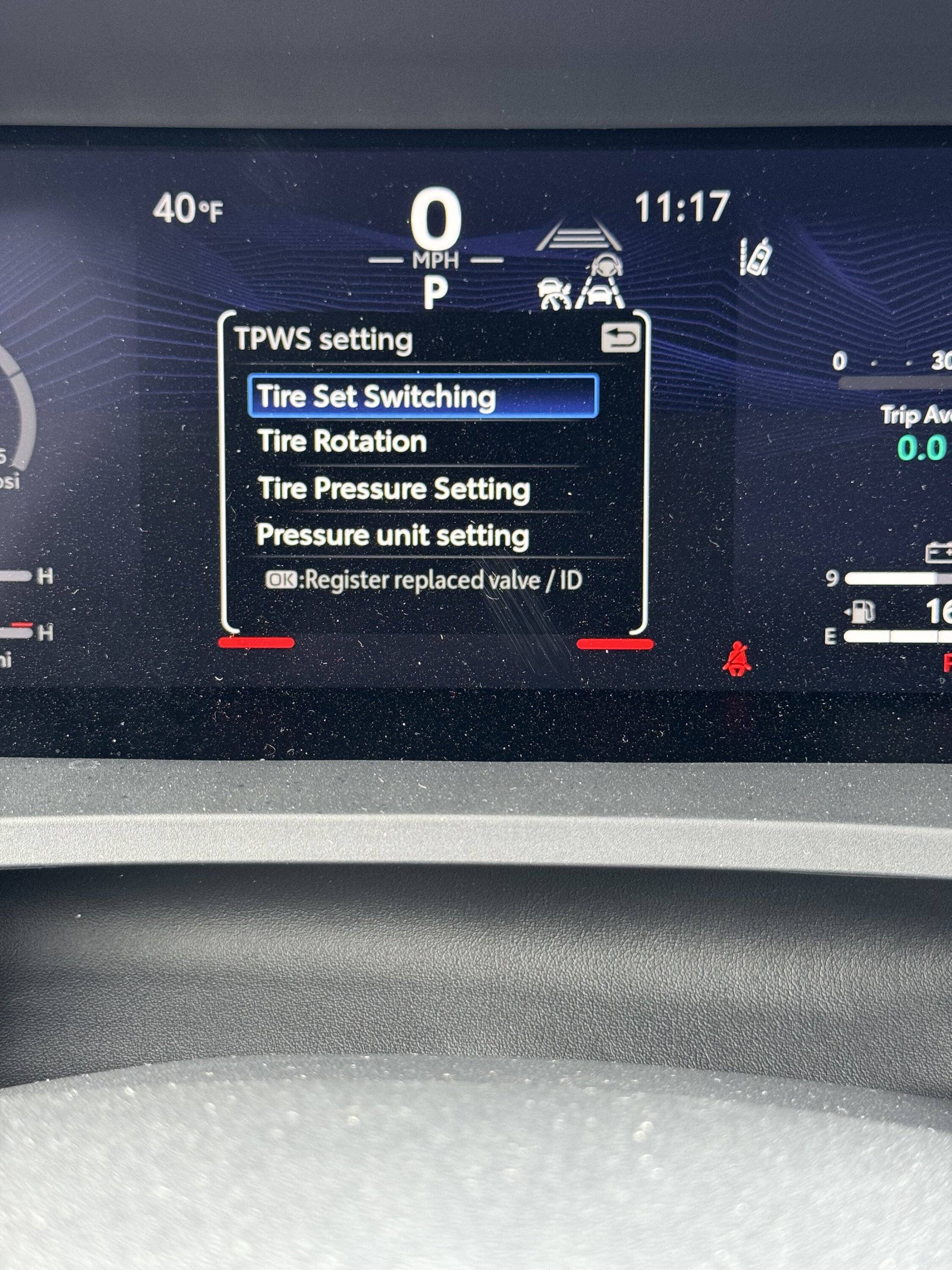

Toyota thought about you ahead of time and accommodates tire sets.

Yes, thanks I saw that. Very cool. Now, do 2023 sensors work?

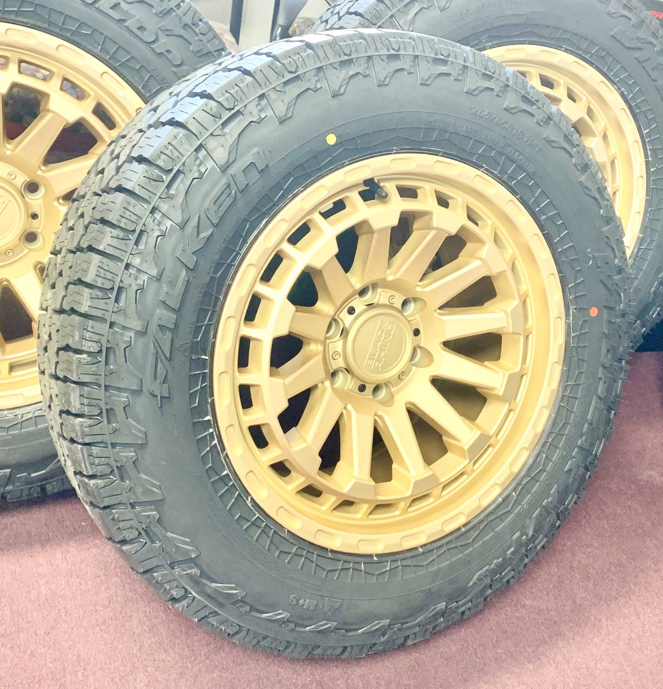

BTF
Bob
Mar 10, 2024
St. Louis
2018 GMC Sierra
Has anyone bought a 2nd set of Tires/Wheels for their Tacoma yet? Did the shop have the TPMS sensor that would read or do I need to get them from Toyota?
Yes - for ā€˜24 TRD Sport - Kept the same stock sizes for both wheels & tires. Switched to: 18ā€ Falken Wildpeak A/T4W 365/65R/18 tires and went with Black Rhino Raid 18x9.5-18 wheels. The Black Rhino TPMS sensors were available direct from BR. This took place last week.
