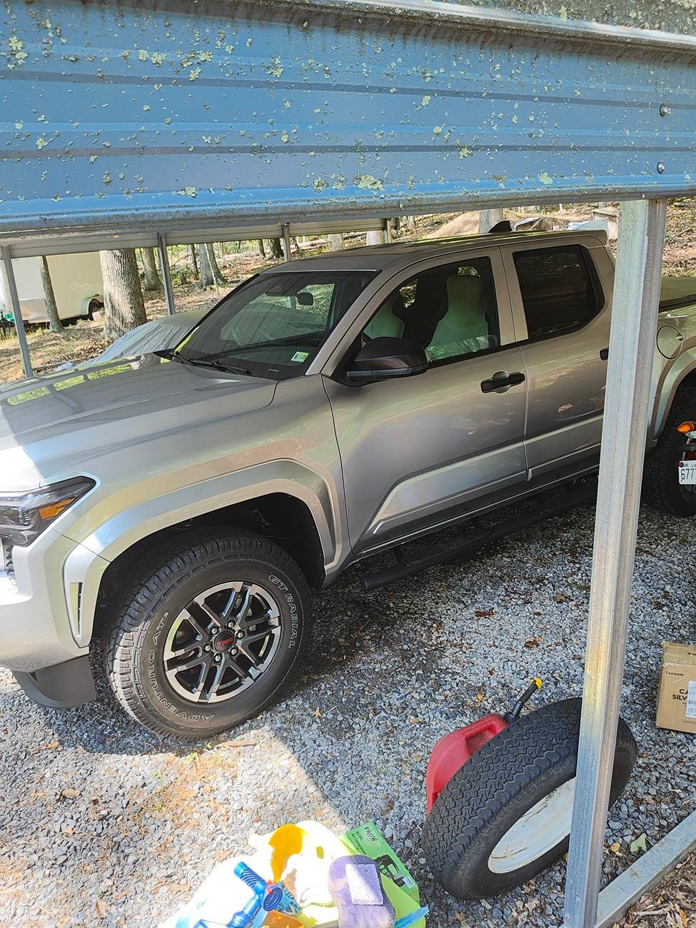

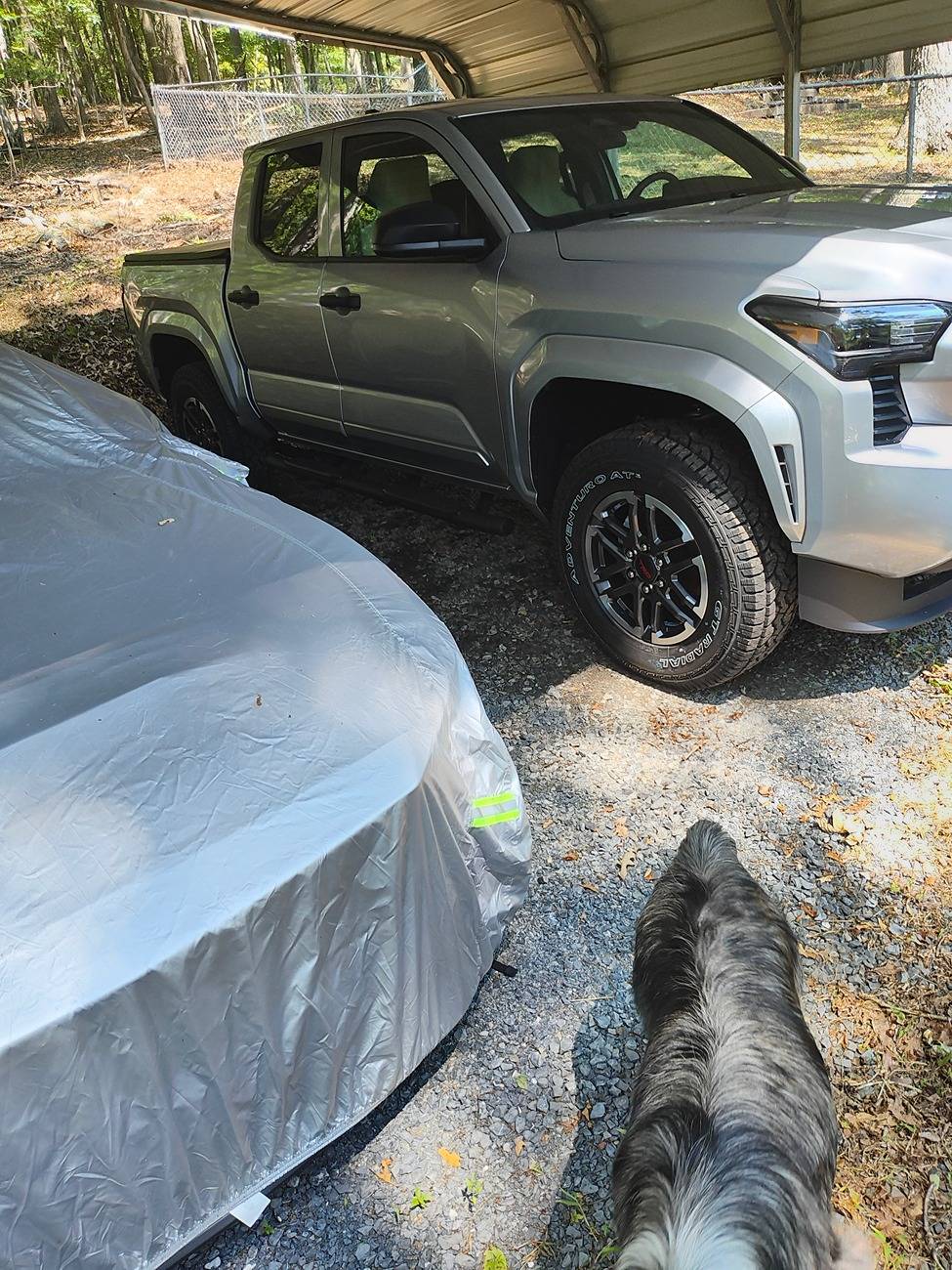

I purchased new tpms using the supplied p/n via eBay (they show for a grand highlander; had them installed on new rims and tires and except for figuring out the applicable ts508 instructions; success. 275/70 18 no fitment issues.
2024 Tacoma Purchasing additional TPMS Sensors ? IMG_20240805_115921747_HDR
2024 Tacoma Purchasing additional TPMS Sensors ? IMG_20240805_115935729_HDR
