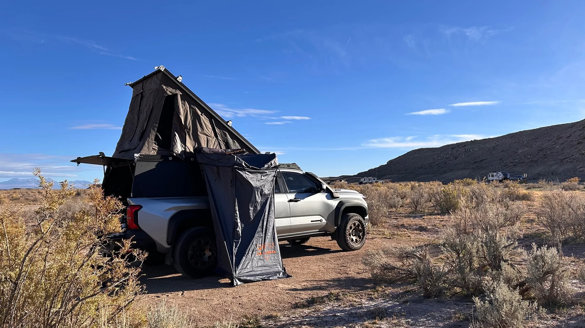

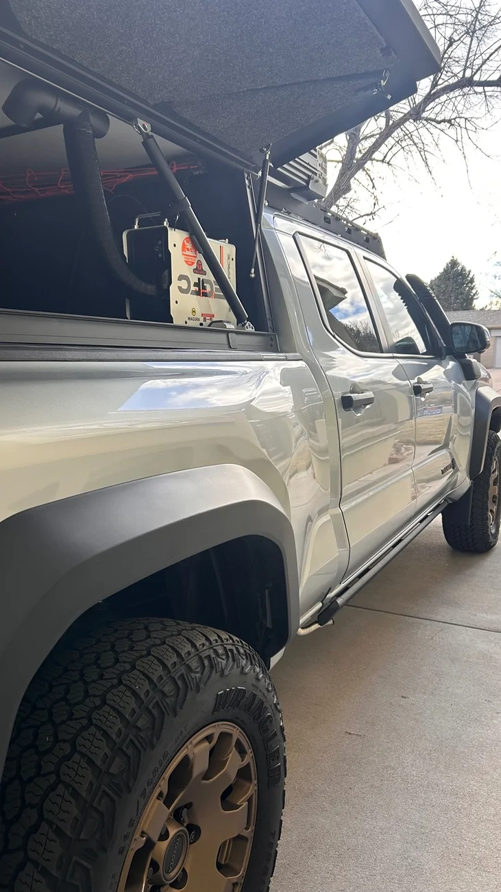

I'm all about keeping it minimalist in the truck bed with how I travel & camp, it's seasonal for me; winter slightly different setup, I take down the awning & shower system, summer a bit more gear but an assload of water & firewood. In 2-3 nights I use 100-150lbs of water out in the desert between cooking cleaning & showering. I made a choice to shave truck bed cabinet weight In trade for a shower every day after mtn biking. Fridge setup is dialed in too: I rock an 18L most of the time vs my Dometic, this smaller unit is lighter, has a li-ion battery that lasts all night, solar hookup to the roof during the day, these stupid chinese coolers are eating Dometic's lunch and I don't need 30L because I always run out of water before I run out of chilled drinks & food so I head into town always for water and re-stock the fridge then.
I built out my truck bed interior with 2020 euro extrusions - did a sleeper berth/bench @ 14lbs w/WISA Hex Ultralight for ~$150 (honestly one of the easiest things to DIY), also installed a 2kW diesel heater (10.5 lbs mounted/fuel topped-off) that's plumbed both upstairs and downstairs in the GFC, kitchen was a slide out that I built but later sold. Decided I just need a tailgate cantilever ledge system for those non-campfire cooking nights. -working on that setup as we speak, real quick & easy to deploy also made of Hex ply, simple induction hob, basic Dometic water jug & a deployable catch sink.
I don't work remote full time, but I've done my share of computer work under an awning, which is nice. But if I was out there for extended periods, working remote & my place rented out.. an actual work desk & a swivel seat in a van is the dream. Zero setup, pull in and you're done.
My build is super light for what it is & offers, stock suspension no air bags, 5 gal RinseKit shower on the roof rack, weight evenly distributed. Lightest GFC V2 Pro configuration; no glass, you add glass to your build you start adding adding poundage. Keep these gen 4 tacos light & fast, load up on water when your ~30min from camp.
standing up in a pop up truck bed camper is clutch, but when the bed is loaded to the gills with a fking kitchen sink, dinette, fridge, pilates table...it gets cramped, pricey (and heavy as f) real quick. My thinking is might as well save for that van life & its 4000 lb payload..
