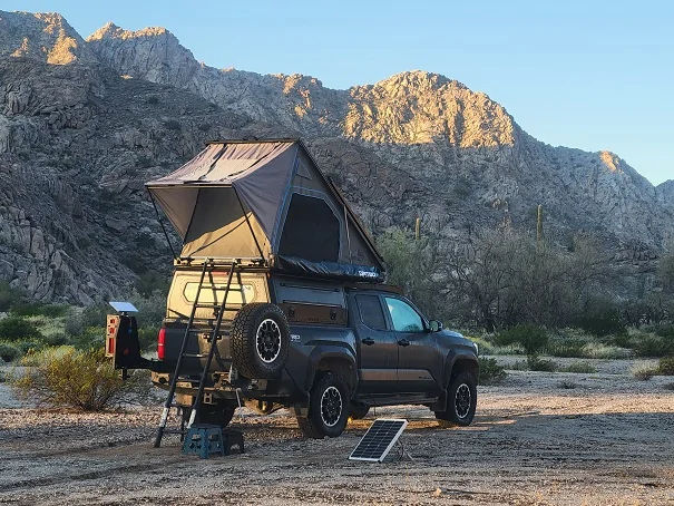

It looks like you have migrated from the Four Wheel camper idea to the possibility of a canopy camper. I have a Dirtbox Overland. I looked at just about everything out there and thought it fit my needs better, and was a more reasonable value. On paper it weighed 450#. Lone Peak was another option.

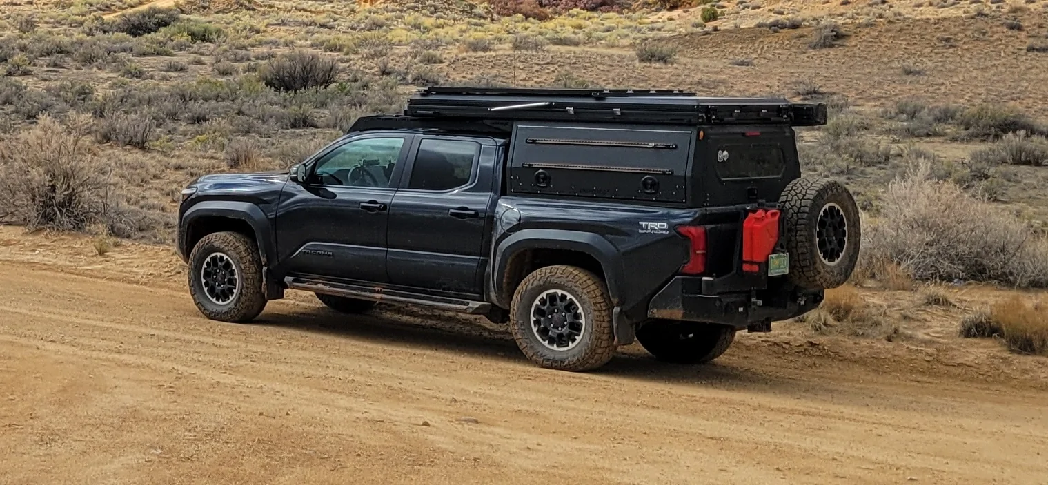

my Trailhunter stock w/GFC V2Pro is 6’-8.5”H / that’s without the beef rack bars on top.

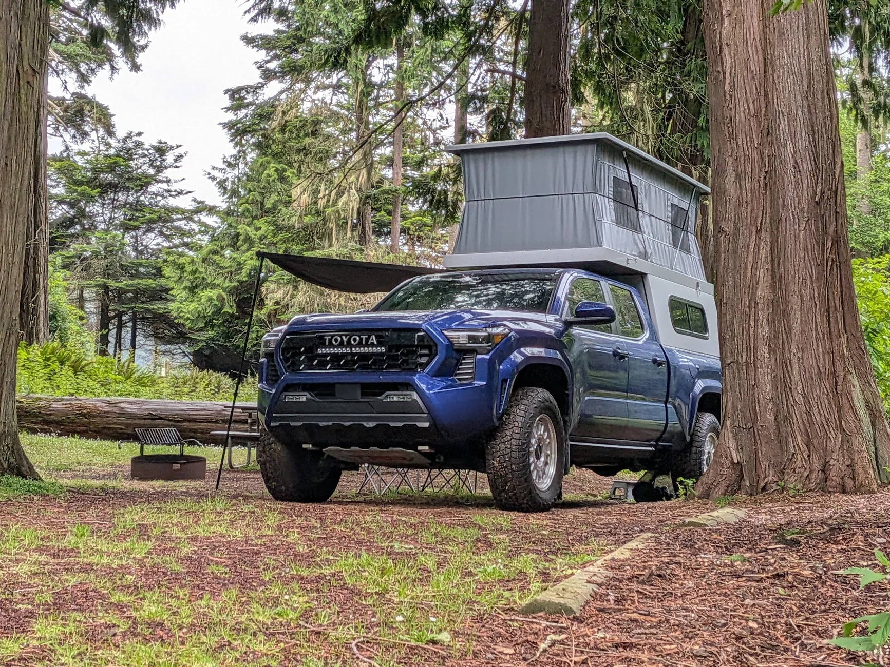

I've got a FWC Fleet (almost fully loaded) on my 4th gen and it handles the over-payload weight really well. I rip up the Coquihalla highway (in BC) with it fully loaded and it handles the weight no problem.
I would say just go for it! I love mine.

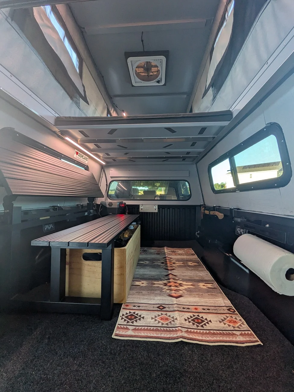

Just another option: I've got a Topo Toppers Badlander. Full size bed up top. Nice space below. Put a small aluminum bench that converts into a table in the bed for my wife to do computer work. Dirtcom swingout on the rear with cooking table. Awning on the side. Camper is 350#. I'm maybe at #500. You could build out the interior to fit your needs though. I can send ya a little video of the interior space just lmk if you want to see it. Pretty sweet set up.
