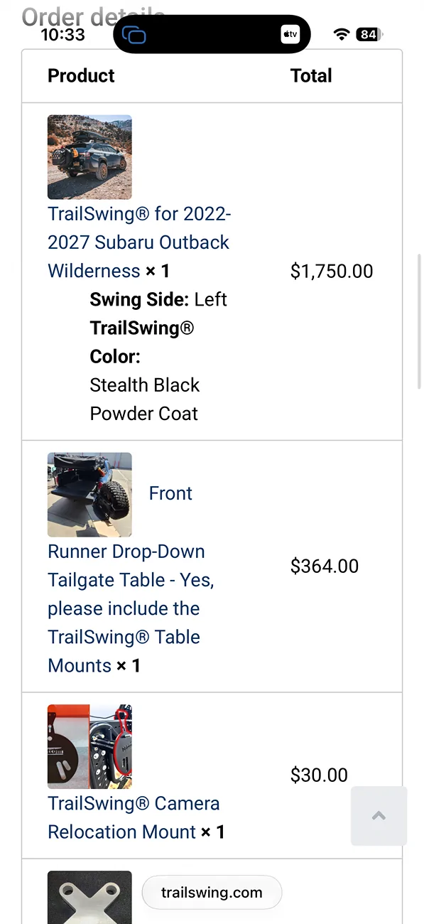

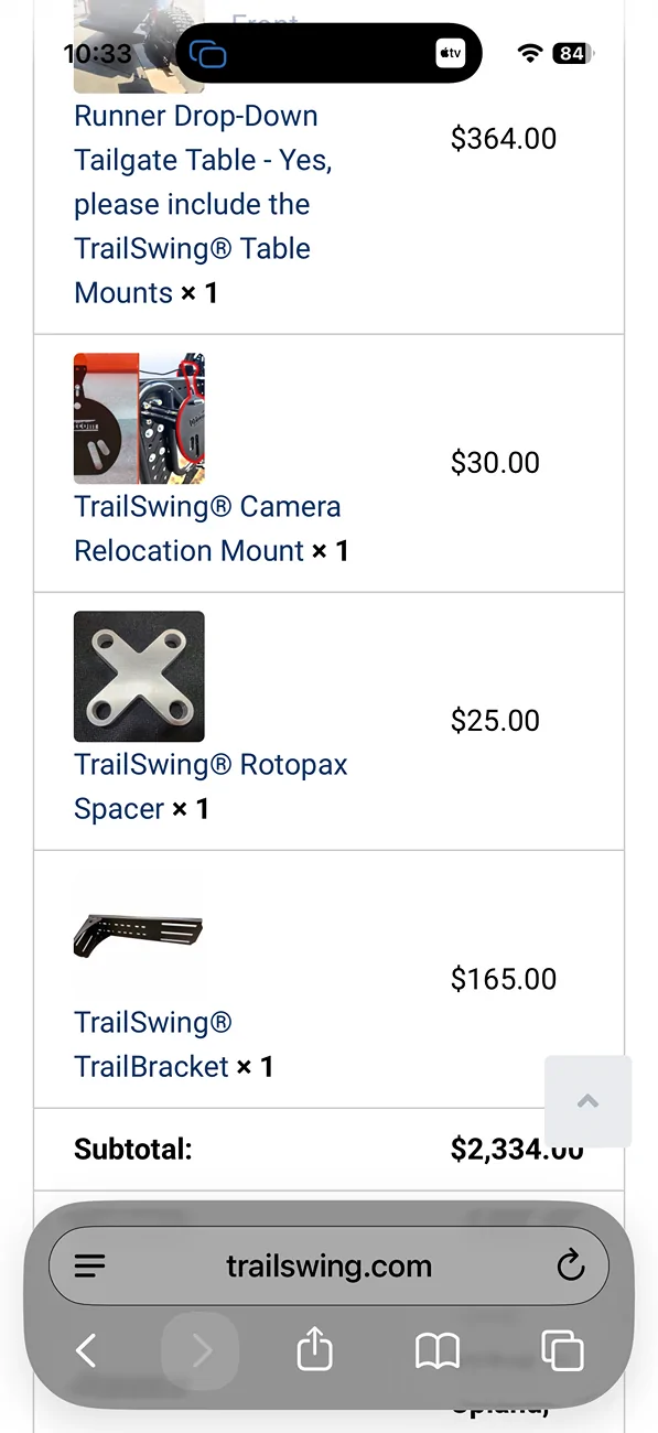

We shopped swing outs this week for our Tacoma and Subaru Outback. Mainly wife wants one for the Subie. We passed on RiG’d after a pleasant email exchange with them due to fitment problems with Subarus (hitch is too short).
We settled on the Trail Swing…here are the items she picked out. We will go pick up when it’s ready. They had a $300 discount on the items.
Happy swinging!

Subie is gonna look bad ass !

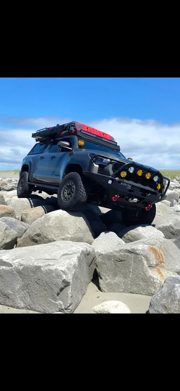

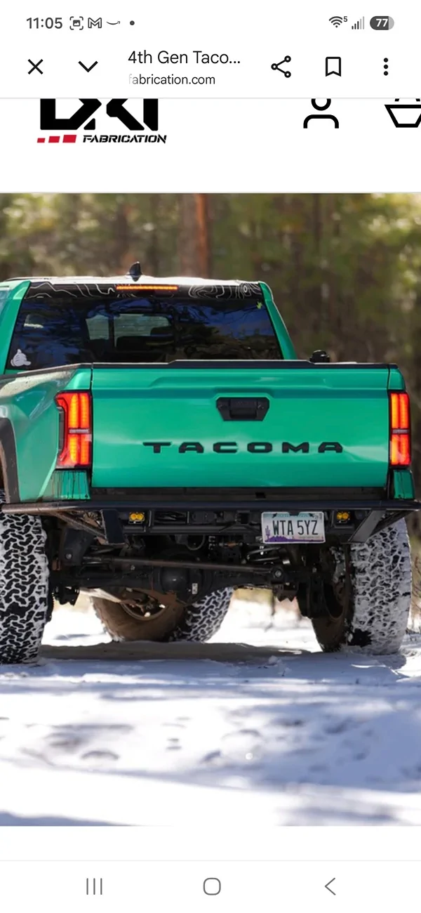

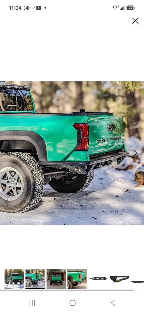

I'm running Backwoods, High clearance front bumper with 12k Evo, and love it .
Like other interested, I've been waiting, and waiting, for Backwoods to finish the Rear bumper/ hitch swing.
Although, DV8 just modified their ultra high clearance rear bumper enough now to work with the BSM and Radar. (This is not for the faint of heart, hackedy hackedy, and a bit of welding, and look, way more functional. IMHO
If anyone plans to go with aftermarket, Bumpers, winch, canopy, ext I pray that you have done some math so you don't end up doing this to KEEP YOUR PERFORMANCE.
The down side, Even with a new KING coilover suspension it felt like it's standing on it's toes, when I hit the brakes. I LOST so much of the suspensions ability. King sends them from the factory with 450lb coils in front.
After taking it to a weight station and getting, front, rear, and total weight, I talked with King and described my loss in performance.
King, ran the numbers and recommend I rebuild the front coilovers with 650lb coils, and change out my rear Dobinson 819v's for the 821v's after describing how I am changing the rear bumper and adding a duel swing. Ouch is what I said at that point and what made it even worse, is it took 7 months for the springs to arrive, due to a backorder from both retailers. 😡.
Hope this simple conversation helps so many save thousands that it cost me to keep up my performance.
Rear bumper/swing combos weight alot, even if it's a hybrid bumper.
Don't have the picture of backwoods quite yet.But here's a picture of DV8'S
HAPPY HUNTING.

Thanks for sharing ! Good info.
RCI rear bumper = 103# + swingout = 140# so 243 lbs. Not terrible, but definitely something to consider with our low payload. Rig'd setup = 60#.
My camper is 350# and I have maybe 50# worth of shit in the bed, not planning on much other weight besides passengers and camp gear, but it adds up quick!

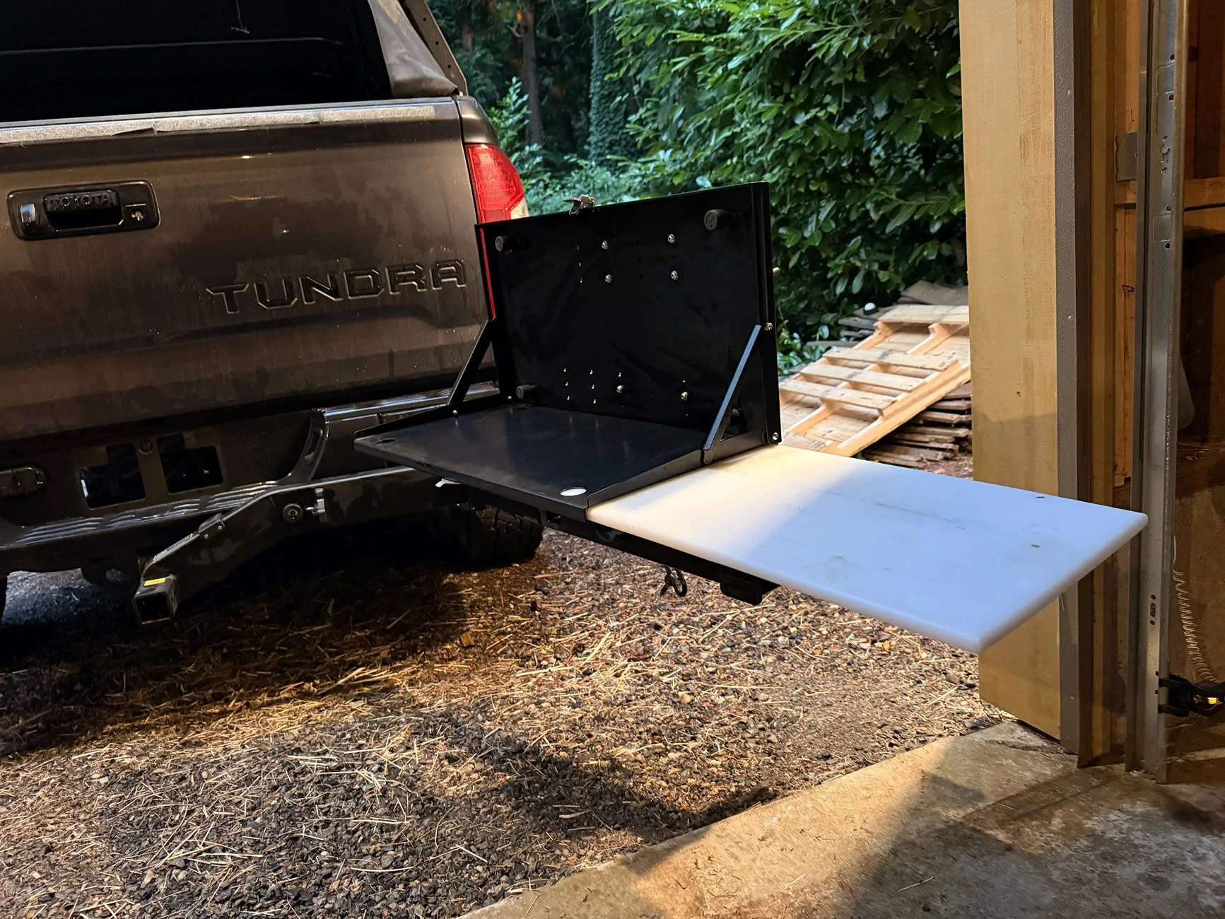

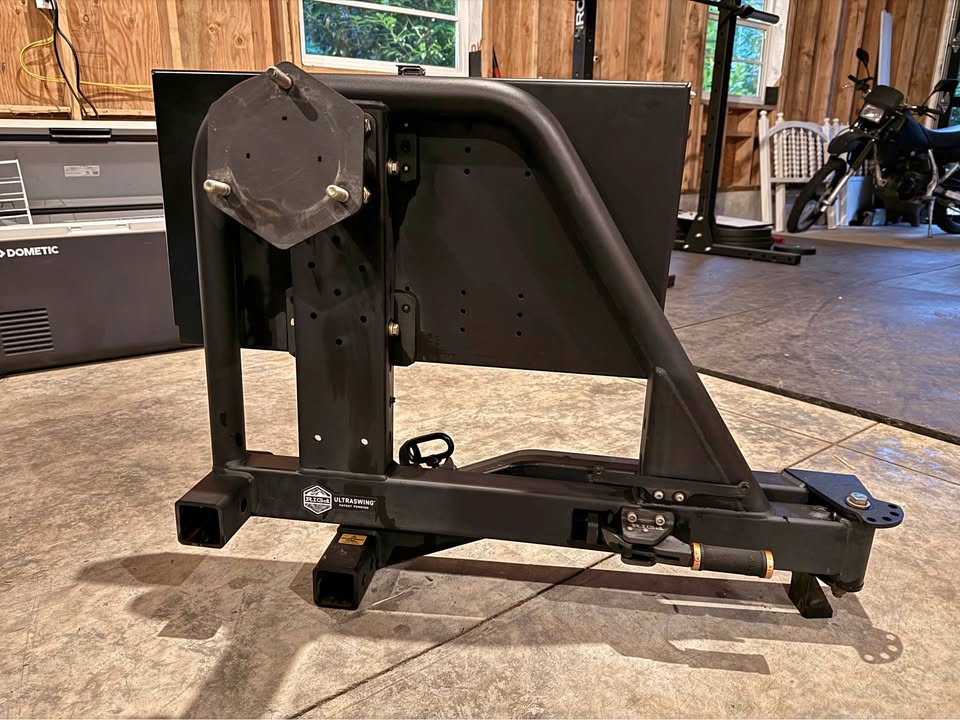

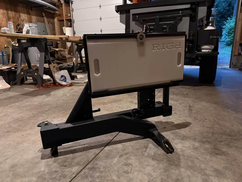

This is the one I'm picking up. Only thing is it's the "multi fit" v.s. the short fit. They recommend "short" for the new Taco, 4Runner, and GX. They say this one fits the Taco too, just sits 1 to 2 inches further out. Just can't find anyone to give feedback.
Saves me a good chunk of change though.

Nice score-hope it works well for your rig. Could not find anything hused down my way that would fit wasn’t rusted beyond my resto-abilities.

Yea same here. Most of them are priced $1200+ and beat to hell. Picking this up for $1100, hope it's rad! 🤞
