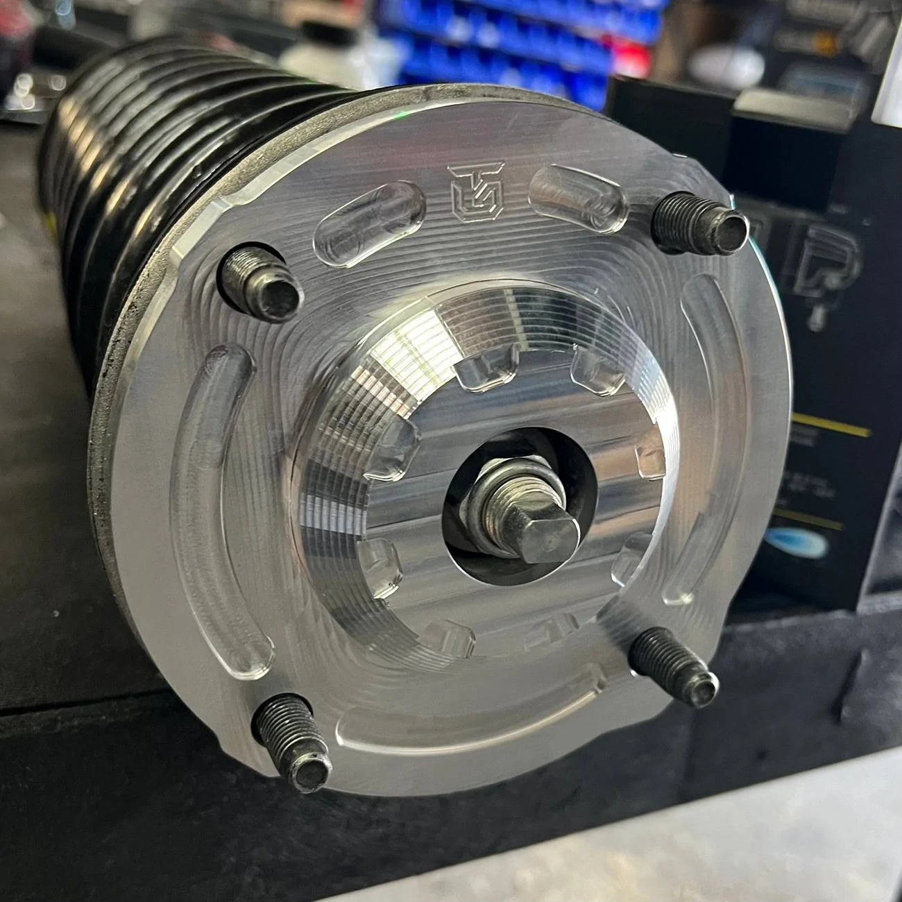

We ran into this same issue a while back.... on this thread...
https://www.tacoma4g.com/forum/thre...k-2024-tacoma-off-road-while-offroading.3357/
Icon and a few others have obviously seen the same weakness,
We came up with a fix because toyota was like 200 units backordered and we needed the truck for other stuff so we could not leave it at the dealer.
Our top late reinforcement is a little different than icon's but has the added bonus of getting you about an inch of lift, check it out here...
https://thetacogarage.com/products/...oard&utm_medium=product-links&utm_content=web
For anyone reading this, use code T4Gtop15 to get 15% off your reinforcement plates, or simply click on this link to apply it automatically https://thetacogarage.com/discount/t4gtop15?redirect=/products/strut-reinforcement-plate-spacer-with-1-lift-for-4th-gen-toyota-tacoma-2024
