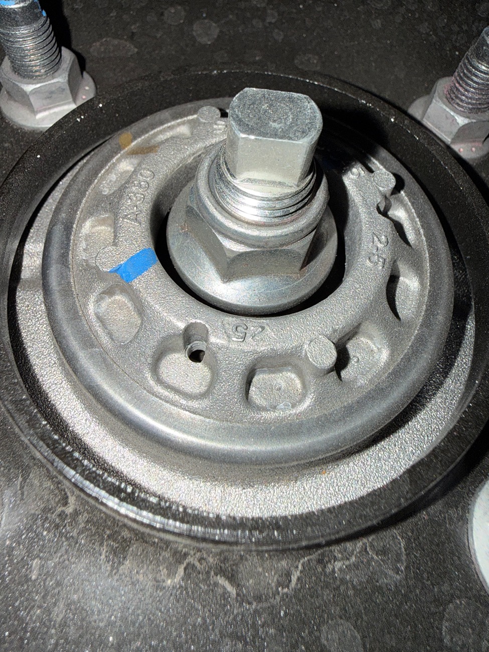

Just got a 2025 offroad premium, does anyone know if this problem has been fixed in the 2025 models? I just took a picture of the Top hats they look the same as the 2024, not sure may if the part is updated?
Same
