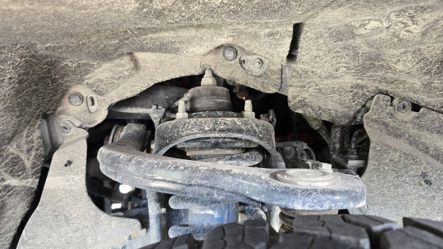

Shock top hat failure on our stock 2024 Tacoma Off-Road while offroading

I am curious to see if Toyota is going to redesign this with a proper fix. Kinda nuts they kept the same thing for the new 4runners too. Pretty lame a dealership is saying that installing the icon plates would void the warranty. Options are to do nothing, install the plates, or spend thousands on different suspension.

Also, my dealer told me that if I installed the icon plates that it will void my warranty. So instead, I will wait to break the top hats again...
Unreal! The OR stock suspension is such a joke for more reasons than one.
Why would the top hat plates void warranty?
I get that shit happens, design flaws are inevitably going to happen, etc.
But do the right thing. Start sourcing the parts for repairs. Don’t give customers grief for the design flaw, and for gosh sakes if you’re not going to offer a solution don’t void the warranty for something like the top hats.
So what do I do? Take them off every time I bring my car in for service? Have they already noted it and is my warranty already voided after my first two services? Rhetorical. Don’t expect answers. Thanks for reading.

2024 Tacoma OR Premium IForce Max - After destroying my passenger side top hat in a pothole at 6000km, the part was replaced under warranty after 10 weeks without my vehicle. When I picked up the truck up I was saddened to hear that the top hat was replaced with the same part that had just broken.
As expected, today, at just over 10000km the driver side top hat failed at on a lightly washboarded section on a local FSR doing about 40km/hr. The failure today really demonstrated that the pot metal construction just fails over time. There was no single bit hit today - just the usual expected irregularities on gravel roads. The truck was fully unloaded - just me, dog and some 25 lbs of tools. (I have never hauled anything heavier than mountain bikes and people.) I was getting passed by many other trucks / SUVs on the way in as I haven't trusted the suspension since the first failure. The truck gets used on FSRs a lot - probably about half of the 10000km on the odometer has been on FSRs.
I'm hoping this repair can happen in less than 10 weeks and I'm hoping that Toyota Canada will again provide me with a rental truck which isn't a replacement for my truck but is at least something. Sadly, this truck is the least reliable new vehicle I've ever owned and will be sold as soon as the warranty expires.
I would replace the suspension with an aftermarket product but don't want to void the warranty. I also feel I shouldn't have to pay money to make an 'Off Road' truck something that can be frequently and reliably driven on FSRs.
