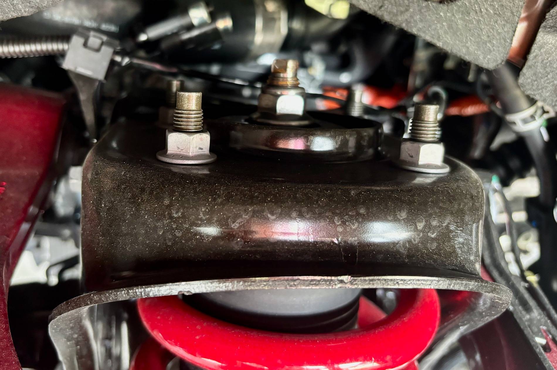

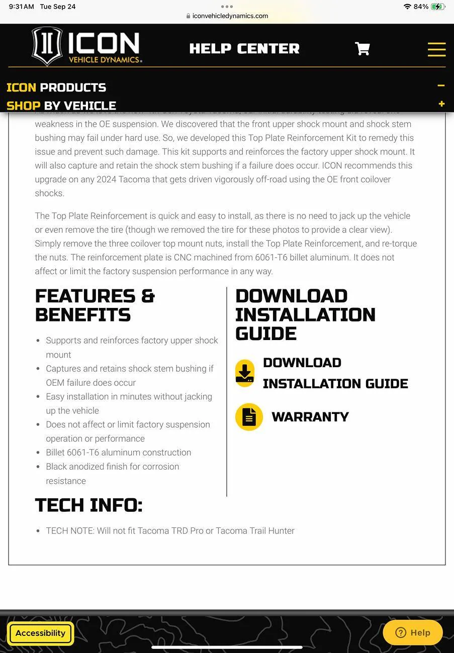

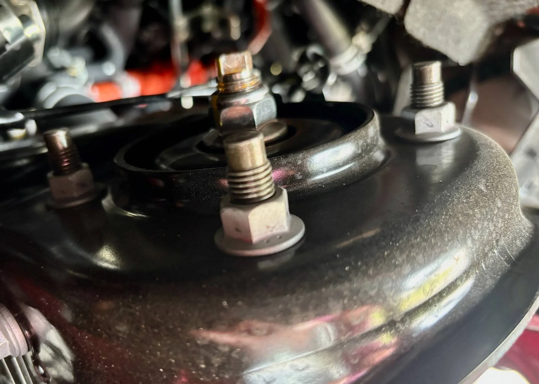

Does anyone know if the Icon top hat reinforcement plates fit on a Pro - or if they are needed?
They have better shocks but I think they have the same top hat, would you be able to snap a picture of the top of the shock mount?
2,335
3,023
Next week when it is delivered. :)
I think that you are right about the top hat being the same, so I may play it safe and get the Icon plate. Even with the Fox shocks I am guessing that it would be good insurance.

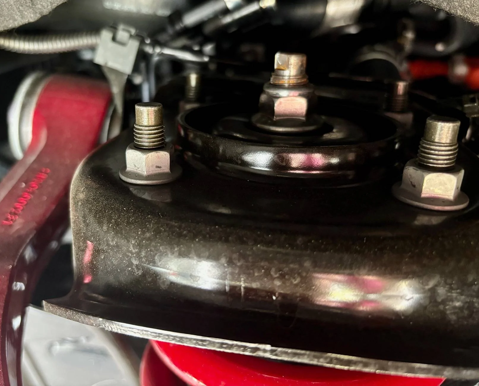

That looks like a different setup to me. I don't think the pros have that same shock mount from the looks of this picture.
That was what I was thinking too, although I have not yet looked closely at other trims. I will do that the next time I am at my dealer. I have not read about this failure in any THs or Pros so maybe I am OK.
If I can get a better picture I will post it.

Thanks for sharing pics of the PRO setup. I don't think the mount is any different from other trims, but obviously the FOX shock is more robust than the Bilstein one (just based on all the promotional shots of the PRO doing jumps). I think the primary cause of the failures of the Bilstein is the cast aluminum top hat which is susceptible to fatigue over time. If I had to guess, I'd bet the Fox shock is forged steel.

@SonoranSurvivalist Yeah - I think you are right on all of that. I will try to get a picture with more direct light on the top hat for comparison, and I still haven't looked at an OR. The OR is a very capable off road truck and Toyota needs to fix that problem as soon as possible.

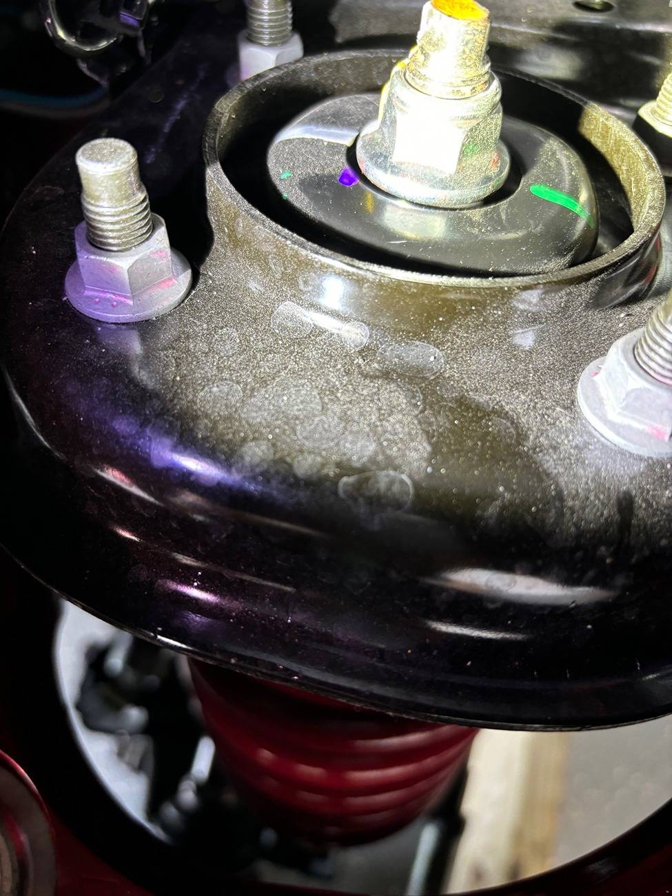

Here is a better picture of the Pro top hat. It looks like stamped steel to me, and not cast. Aren't the ones that are failing cast? Maybe I am just remembering that wrong. and obviously I'm still a bit confused. :)

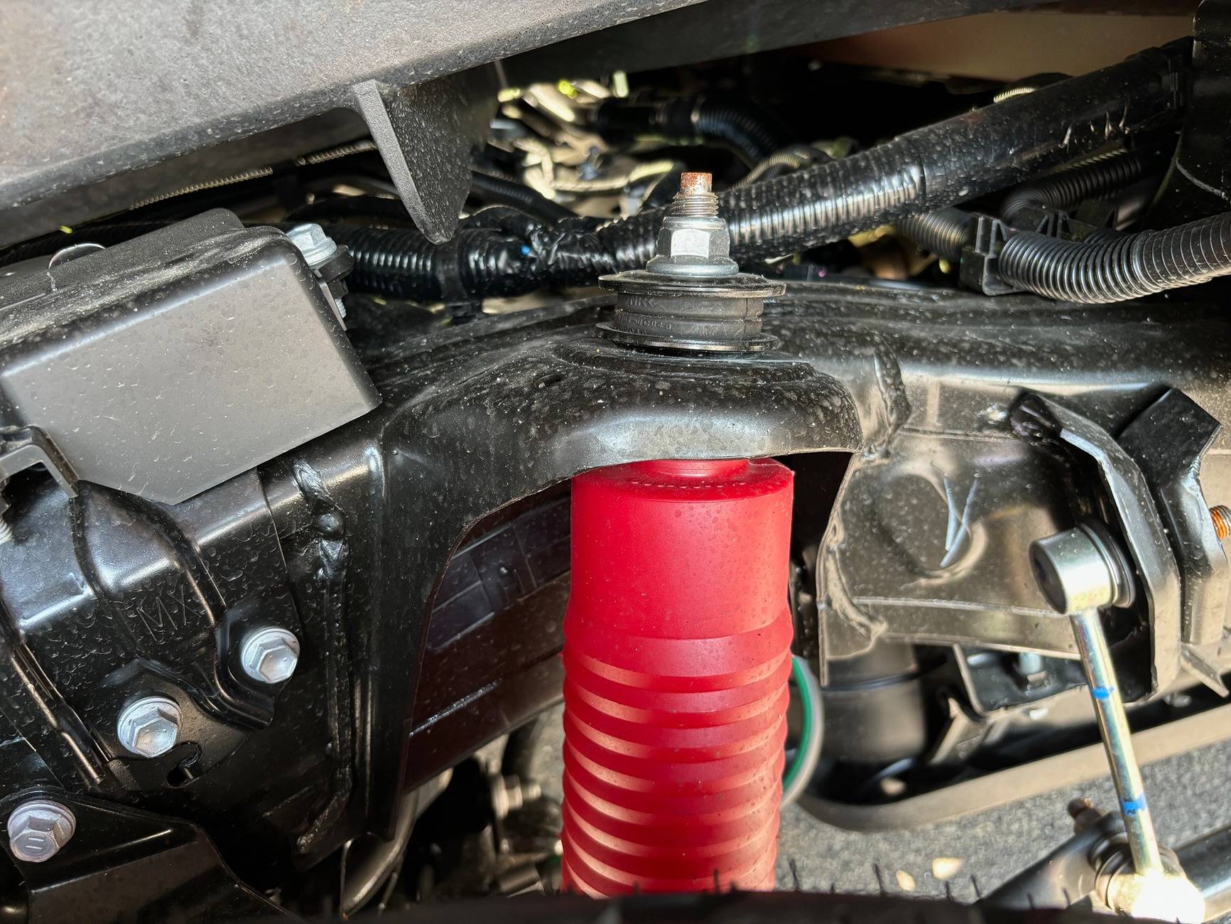

I also attached a picture of the external rear bump stop on the Fox shocks.

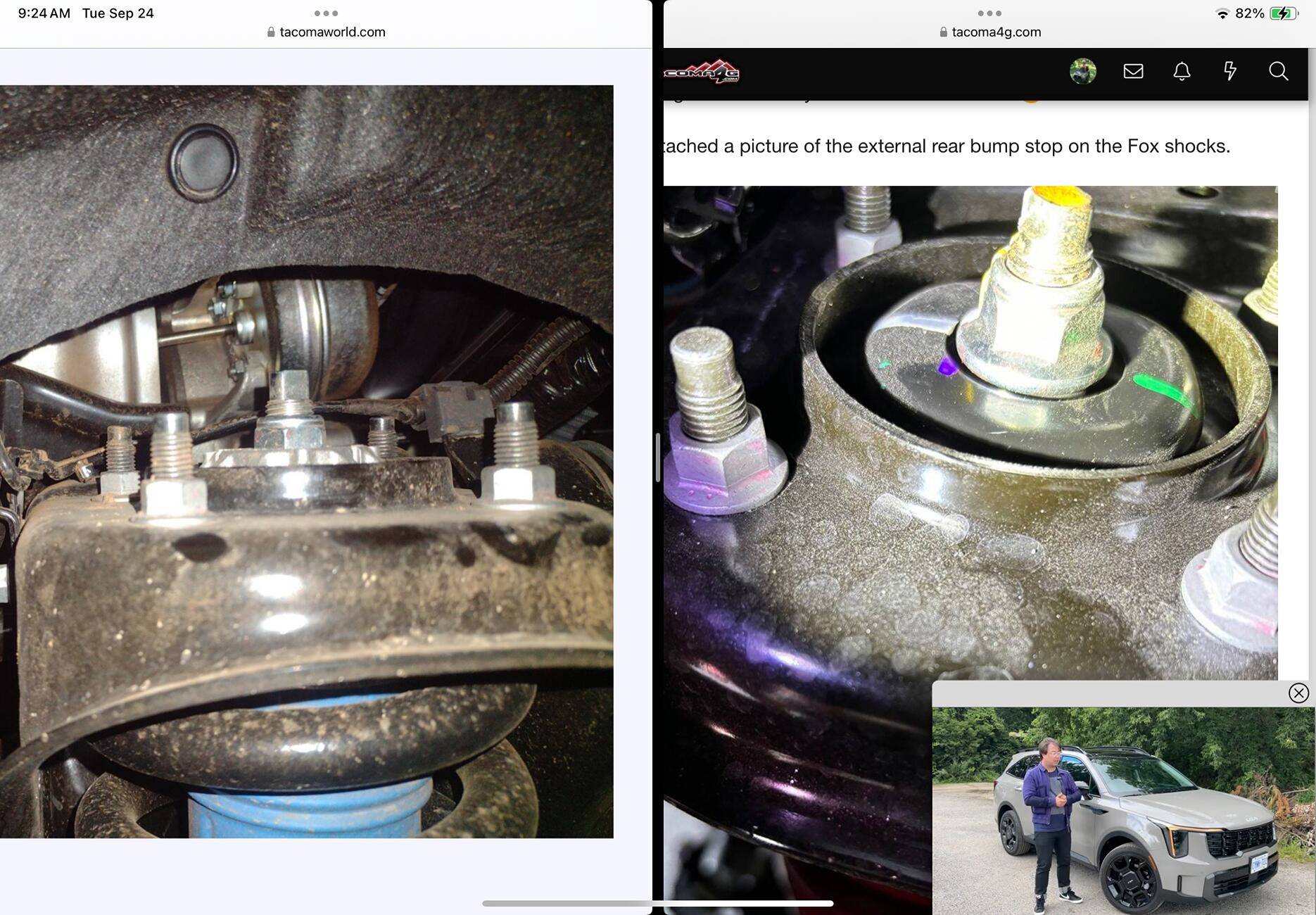

Left pic is of the non pro models. Right pic is of the pro models. So imo the icon fix won’t fit.
2,335
3,023
Yeah - totally different top hat - so no on the Icon reinforcement kit.
I guess for now I will just hope that the OEM ones are OK. At least they are not the same part that we know can fail on the other trims.
