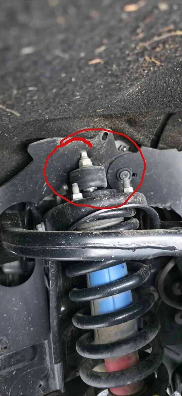

I did it :( In my case it was a legit speed and legit pothole, kind of asked for this my self. So the question is, can i drive it home(200 miles) like this?
Maybe carefully? But it is in NO WAY your fault! Toyota/Bilstein is 100% responsible for this!
This! I have hit some giant potholes and never had a top hat failure. Damaging a wheel is one thing, but the truck's suspension failing is in no way normal. This is another issue on my list of things I can't believe Toyota has never addressed.
