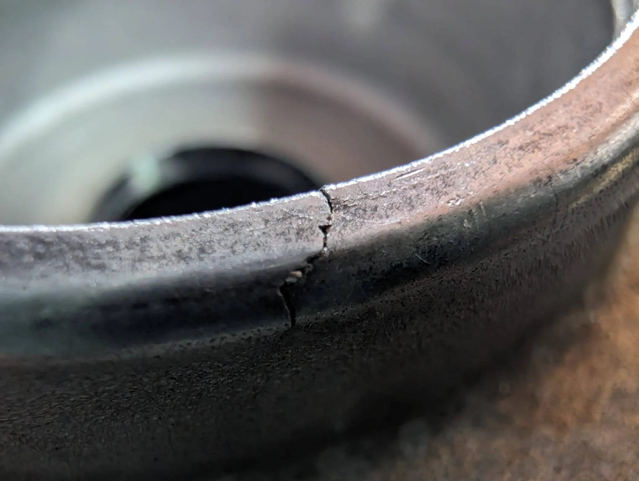

We went out with the new taco to try and see what it was capable of in stock configuration and I have to say, for the most part, it was great! We didn’t do anything crazy but we did test traction, comfort and clearance pretty well (although we didn’t record it all)
We tried not to beat up the truck too much but the truck did end up breaking…
On our way back we picked up some speed on a flat area of the desert, and without hitting any jumps, rocks, or washboard one of the top hats of out right shock managed to come apart.
These new tacos have no frame mounted bump stops like the 2nd and 3rd Gens. Instead, the shock has an ā€œintegratedā€ bump stop that is simply a piece of foam that bumps the shock body to the shock mount or ā€œtop hatā€ when at full compression.
Our only conclusion is that fatigue or a hard enough hit was able to crack the top hat, a cap holding the bushing for the shock shaft came out and the shaft was able to completely go through the hat. We were unable to locate the cap so we are unsure if the cap broke or simply slipped out after the hat cracked.
In any case the cap was being held in place only by a groove on the hat that might have about 3/32ā€ engagement with the cap, both aluminum parts. The hat seems to be formed over what seems to be a cast cap.
Needless to say, I believe the cap is not enough to take the force a bump stop normally would. I am not exaggerating when I say we DIDN’T HIT anything that would have caused a hard bottoming of the truck.
THIS IS THE 10TH TACOMA I’ve owned and we’ve hit significantly worse things on old stock shocks, without a break. Pot holes on a regular street would have been much worse than anything we did on this run. We’ve worked on hundreds if not thousands of tacos at this point and we’ve yet to see a shock mount break. Mostly because all other tacos did have a frame mounted bump stop I would assume, but that’s exactly the point, if you’re going to make ā€œoff roadā€ shocks and integrate the bump stop, the hats better be able to take an impact. These don’t seem to be able to do that. I could be wrong and this could be a fluke but the way it is designed seems to me like a weak point that will hardly be able to take a good impact without a redesign.
We have a clip on this video of where this happened, you can see we picked up some speed but there’s no obvious exact point where this would have happened, like I said, we didn’t hit any crazy terrain while taking that shot.

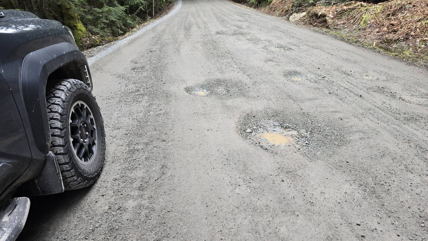

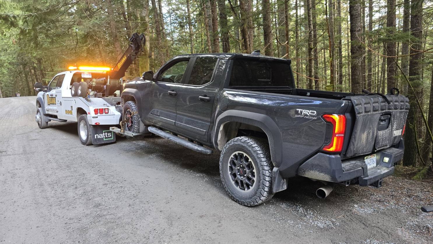

2024 Off Road Premium Hybrid. I just destroyed the top hat on my front strut today. Less than 50km/hr (30mph) into a pothole on a gravel road. Watched at least 50 other trucks including F150s and G3 Tacos, ZR2s hit it faster than I did with no problem. Even a couple Subaru Foresters had no problem with it. Really disappointed by this. Surprised it's not a recall already as its a very known issue and there is already an aftermarket fix. I will see how well Toyota treats me tomorrow as the truck is sitting outside the dealership now...
Pothole by the front wheel is the one that took me down!
Really sad as the truck as 6000km and its already the second time I've taken it in for problems. Again, we'll see how Toyota treats me tomorrow but I'll definitely be buying the Ikon top plate reinforcement kit before I even go onto gravel again.
Update. 12 days later... Truck still out of commission as dealership has had to order parts from the US. This is the second time I've had to take this truck in for manufacturing defects. The first time two bolts in the hinge mechanism of the driver door fell off because they weren't tightened properly. I hate to say it because the truck really works well when it does work but I don't think I would buy it again. I've never owned any vehicle that I've had to take for service twice in the first 6,000 km.
