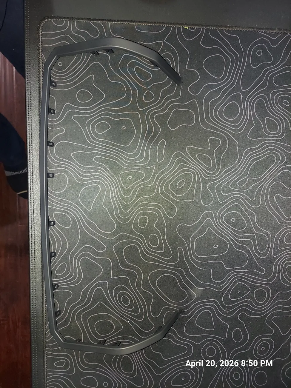

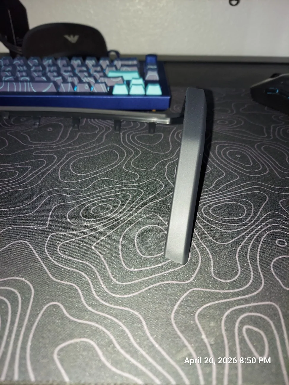

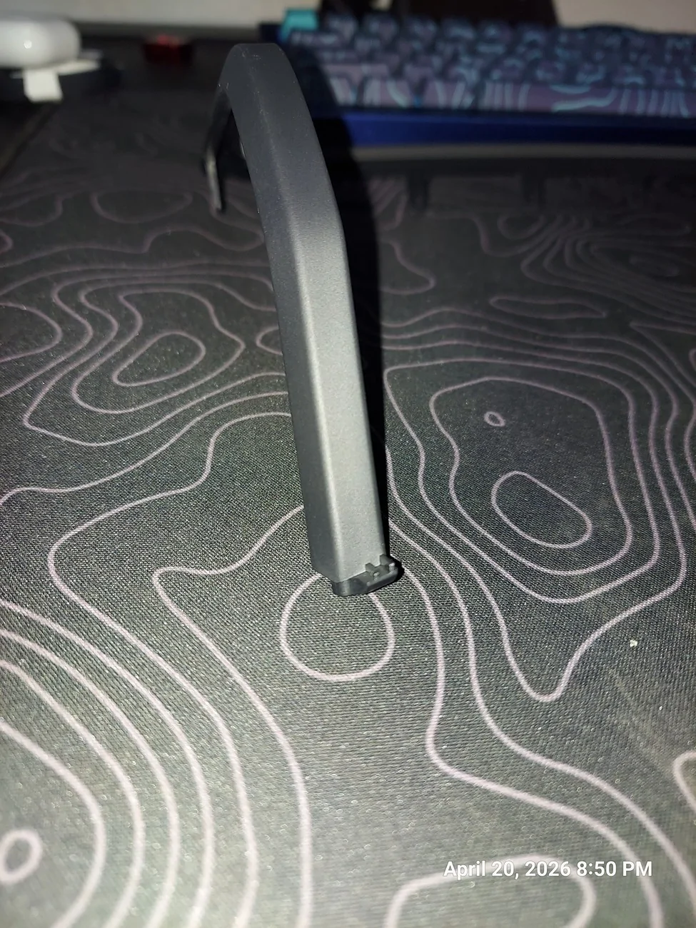

I got the blacked-out center piece, 55475-AK020. However, it came with a broken tab. The dealership I bought it from won't respond to my email.
Bummer about the broken piece. Mines is shipping right now, hopefully it is packed better. I hope you get taken care of for your troubles, too.

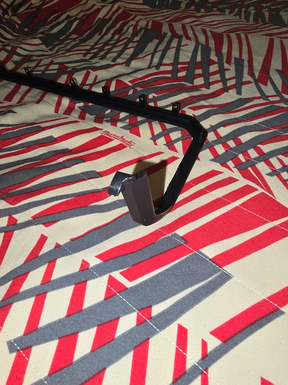

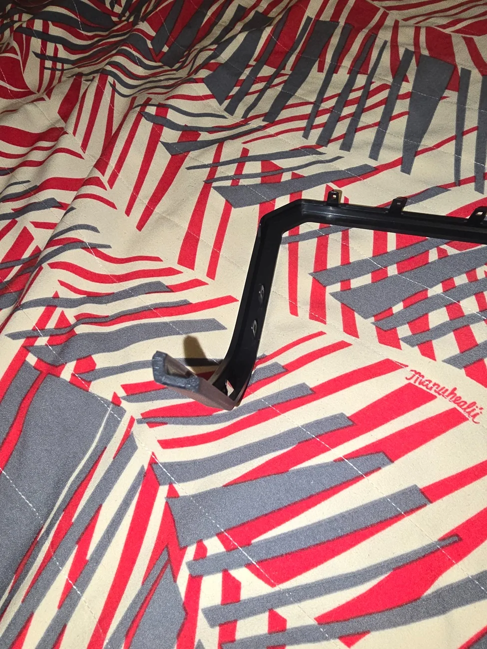

Mine just came in today. Looks exactly the same as yours. I thought mine was also broken on the side that doesnt have the tab, but I think that's just how it looks. Looks like that's where they break it off the mold or something.

Mine just came in today. Looks the same as yours. I thought mine was also broken on the side that doesn't have the tab, but I think that's just how it looks. Looks like that's where they break it off the mold or something.
My replacement is supposed to come tomorrow. I will start ripping it out then and compare it to the one attached.

Edit: I reread your post, and I misunderstood. Please disregard if you read the previous post. Otherwise, please let me know what you find. If it is broken, I am not too worried since the remainder of the tabs look to be intact, and the "broken" part you can't really see.

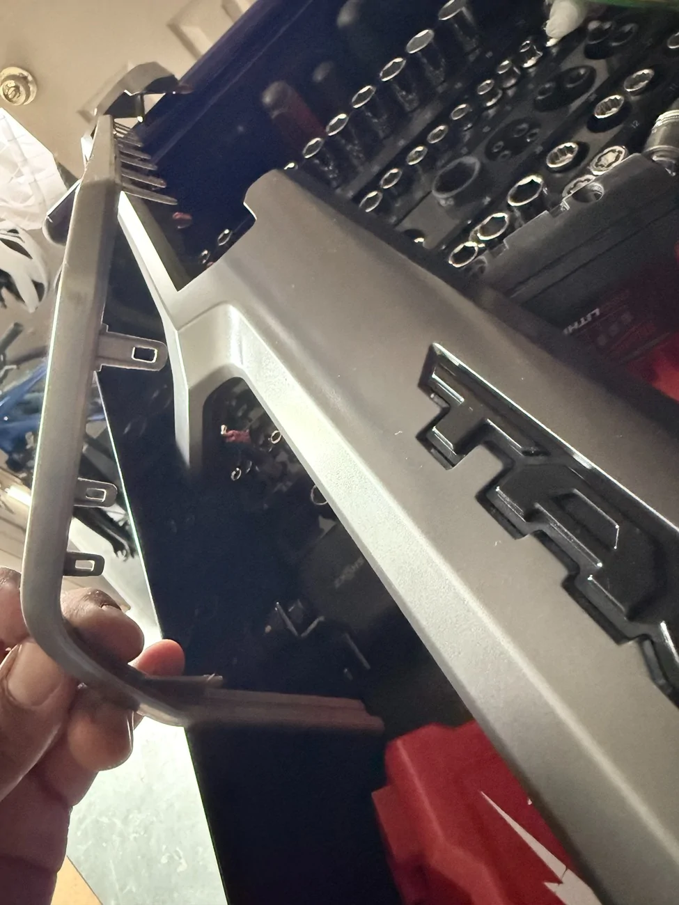

LMFAO, you are right ! I don't blame the dealer for not knowing its not like they have a ton of people ordering this part.
Just completed the swap, and the tab is meant to be "Broken". The original one is.
Hopefully, you haven't installed it because I have some tips.
1. Use masking tape on the new piece before installing it. I scuffed mine up.
2. Insert the Heritage piece first before installing the center garnish.
3. The tabs to the garnish piece are easily removable, but use a pick to lift. I broke one tab on both the original and the new one when installing it. Not a biggie as it's still very secure. It hurt me, though.
4. The tab piece of the new garnish you want to pop the tab first into place by rotating it in. You will have to gently force it in GENTLY
