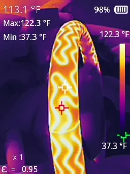

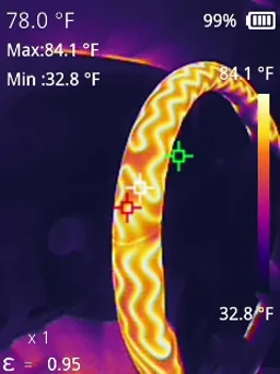

There seem to be good ones and bad ones. I’m replacing my TRD-sport with a TRd-sport and noticed the new one feels like nothing is on at all compared to the old heated wheel. Engineer brain kicked in and I broke out the thermal camera. Seems there’s some kinda quality thing going on. I feel like they are supposed to be hot not just like warm
I was waiting for this lol
I love this kinda stuff 😂
