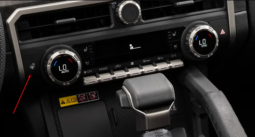

I had looked into this as well. Seems like there is only 1 clock spring available. Just not sure about the heated wheel button. If it's just the button (and if there is a wire behind it) or you need to replace the entire climate assy.
Could be as easy as wheel, and button.

I looked into this last year - there one seems to be one part number for the TRD Wheel - makes me think its a switch/wiring deal. I have not tried pulling the dash apart to see.

Well, its getting to be that time of the year again so I figured its also time to give this thread a bump. Anyone successfully done the swap yet? I happened upon a heated wheel but don't necessarily want to tear my dash apart to explore whether the harness exists.
