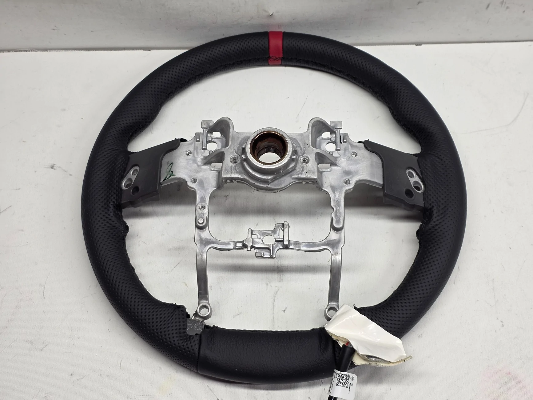

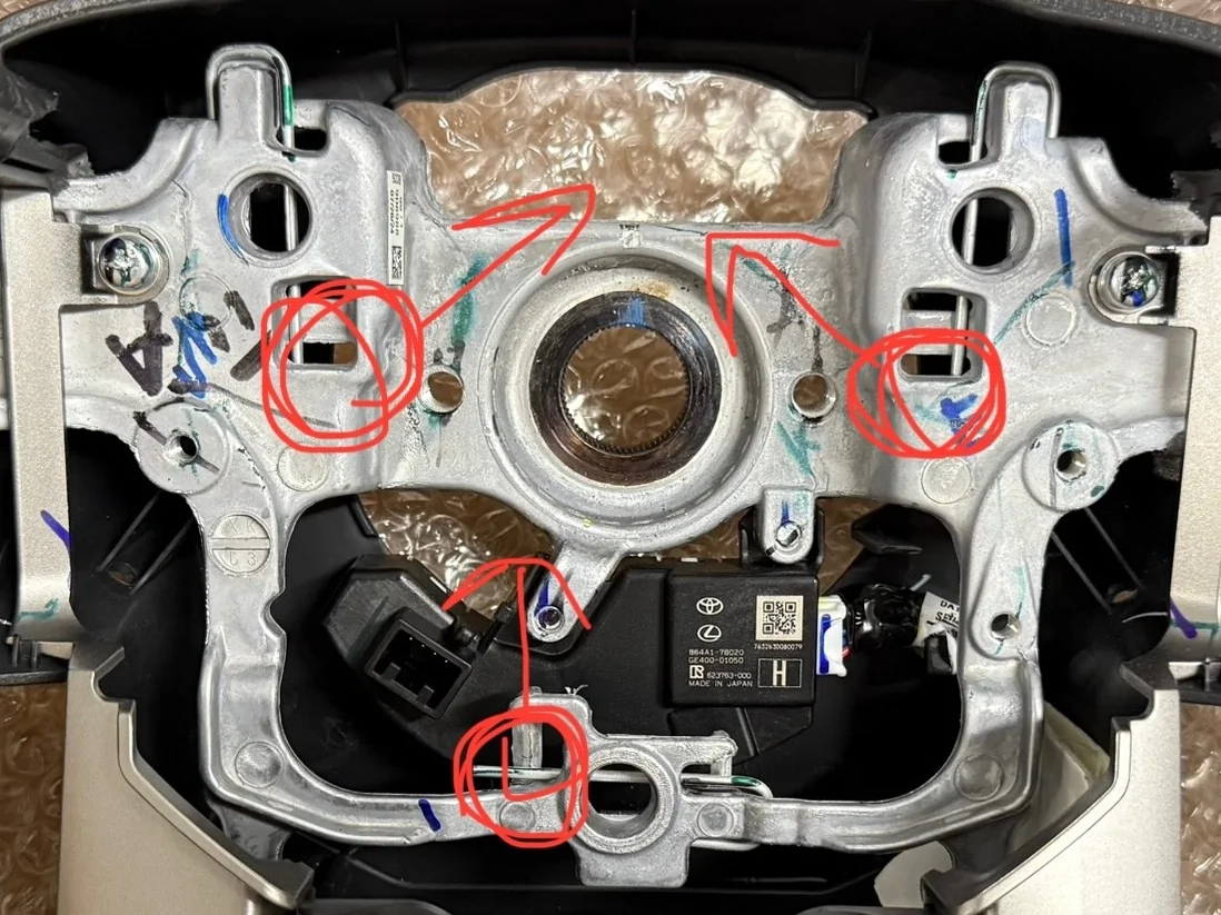

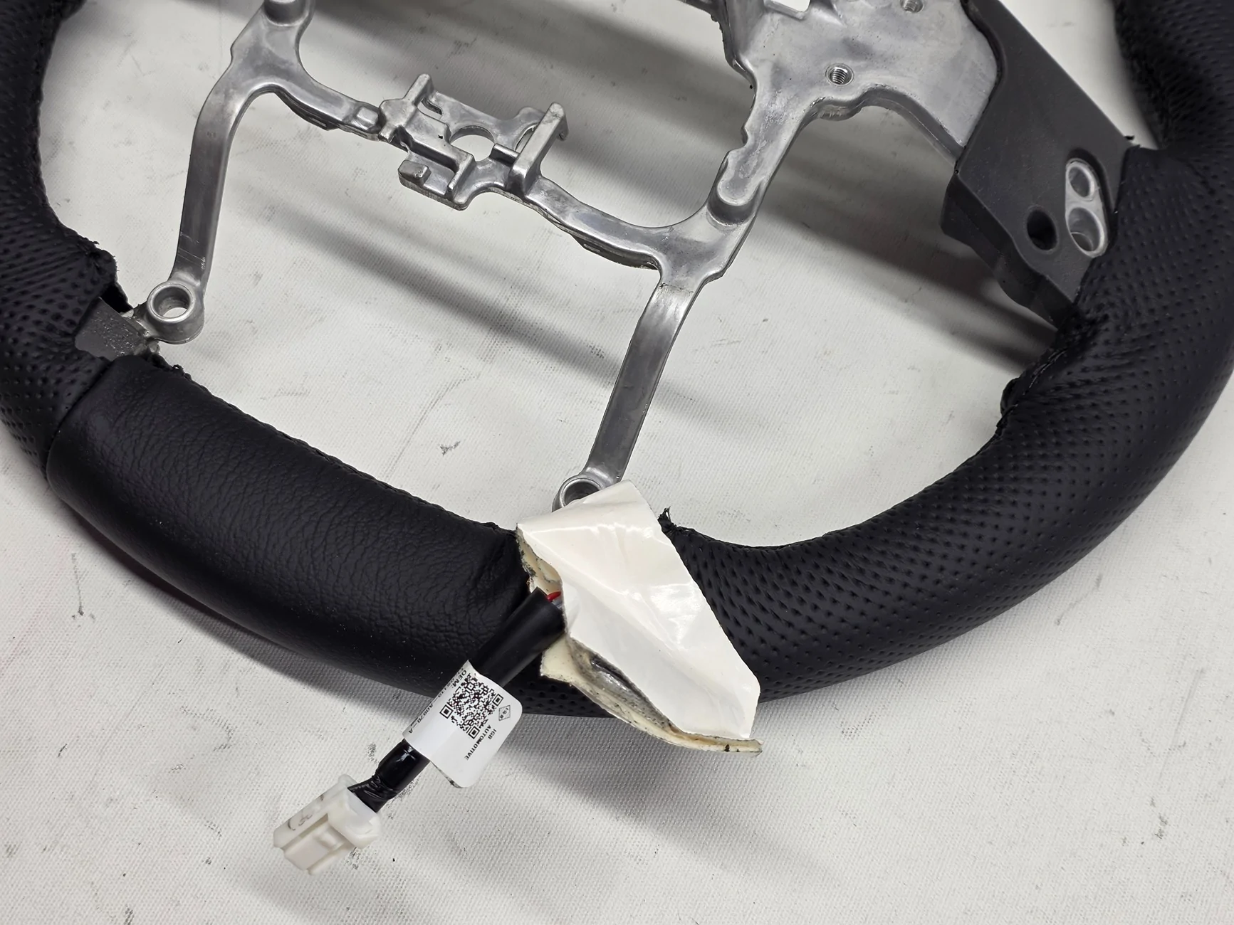

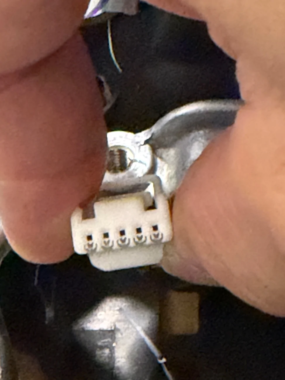

I can to take a picture of the connector on the right tomorrow when I get to work.

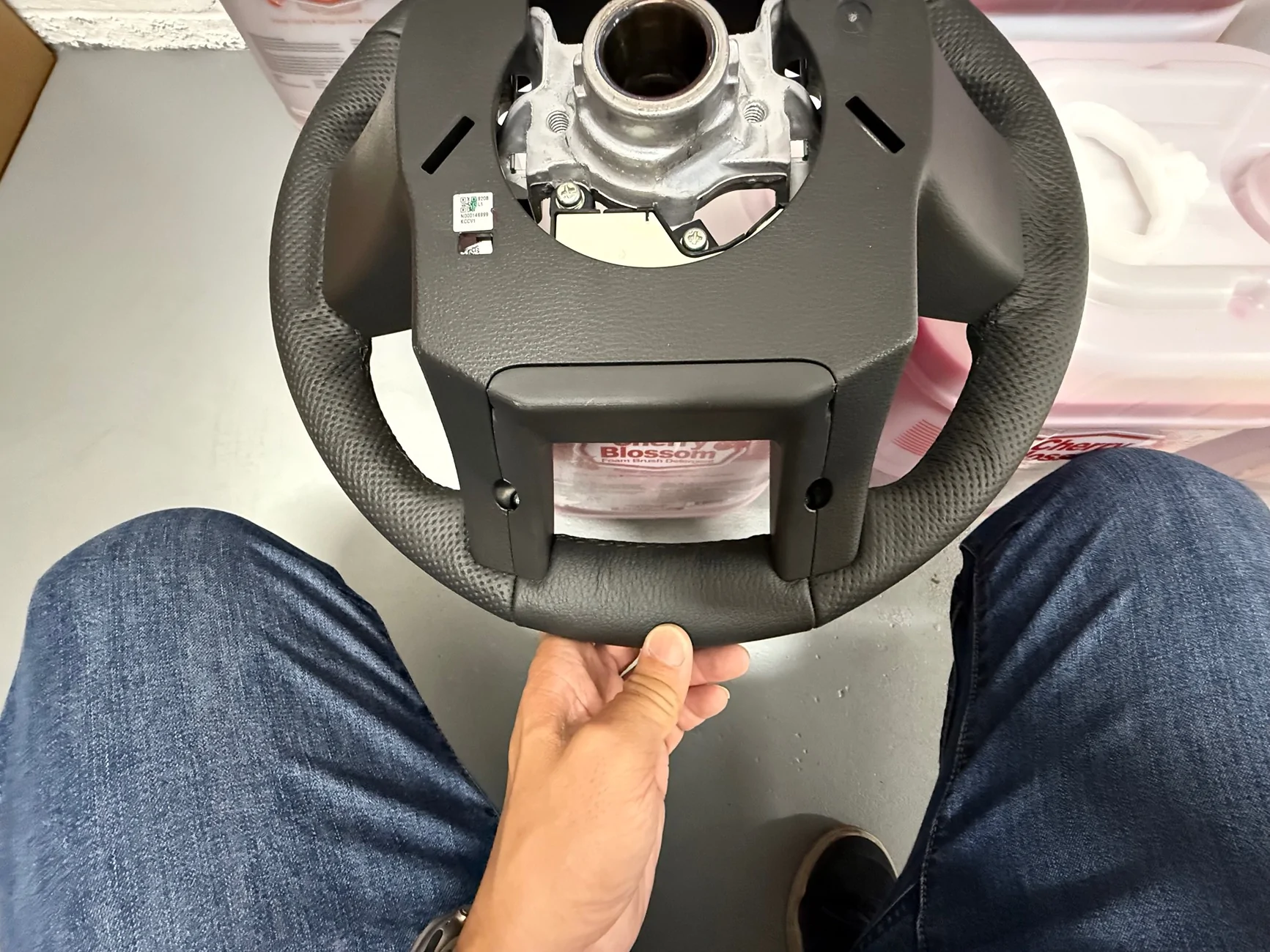

By the way. Here are the three clips. Accessed through the back.

I’m in So.Cal. I have my original Off-Road wheel with heat that you can try if you’re in the area. Otherwise I can take a picture of any connectors on the wheel tomorrow for you to compare.
Unfortunately I’m not in the area, but that wheel you have is the one I want (if it plugs in). I assume it likely does. I’d buy the wheel off you if you were willing to ship it, but I probably need to confirm connector pin out before I make a purchase.

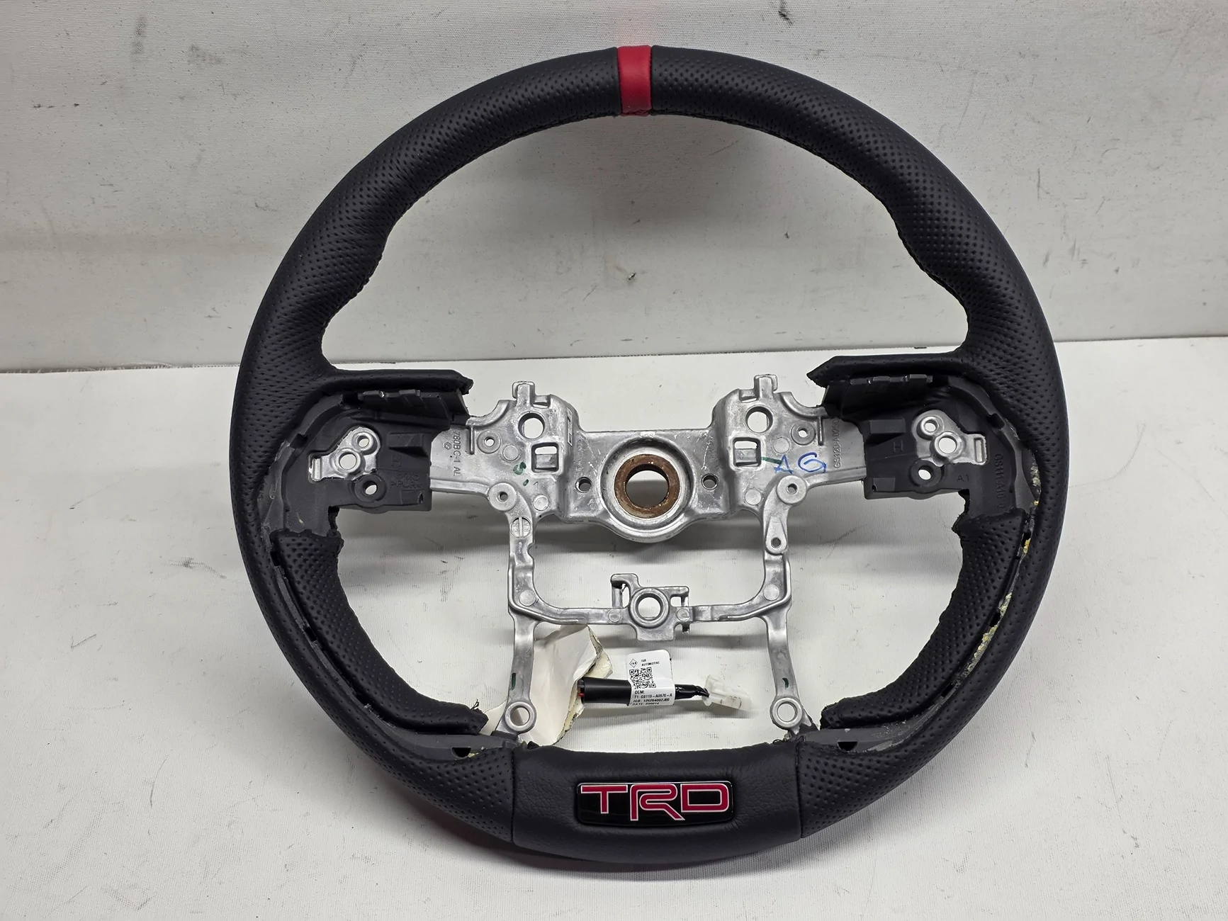

I have some pictures of the trd leather with heat.
