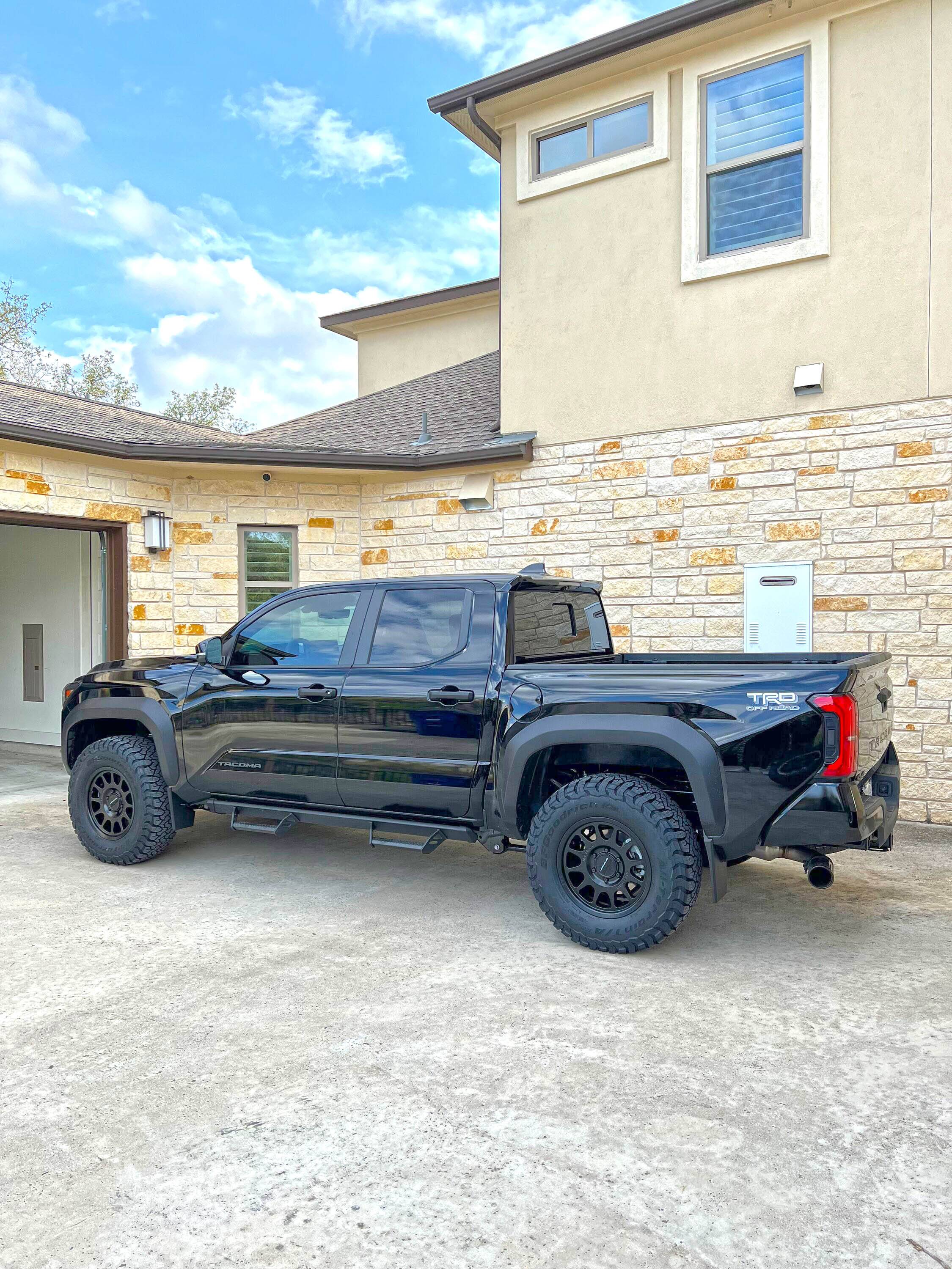

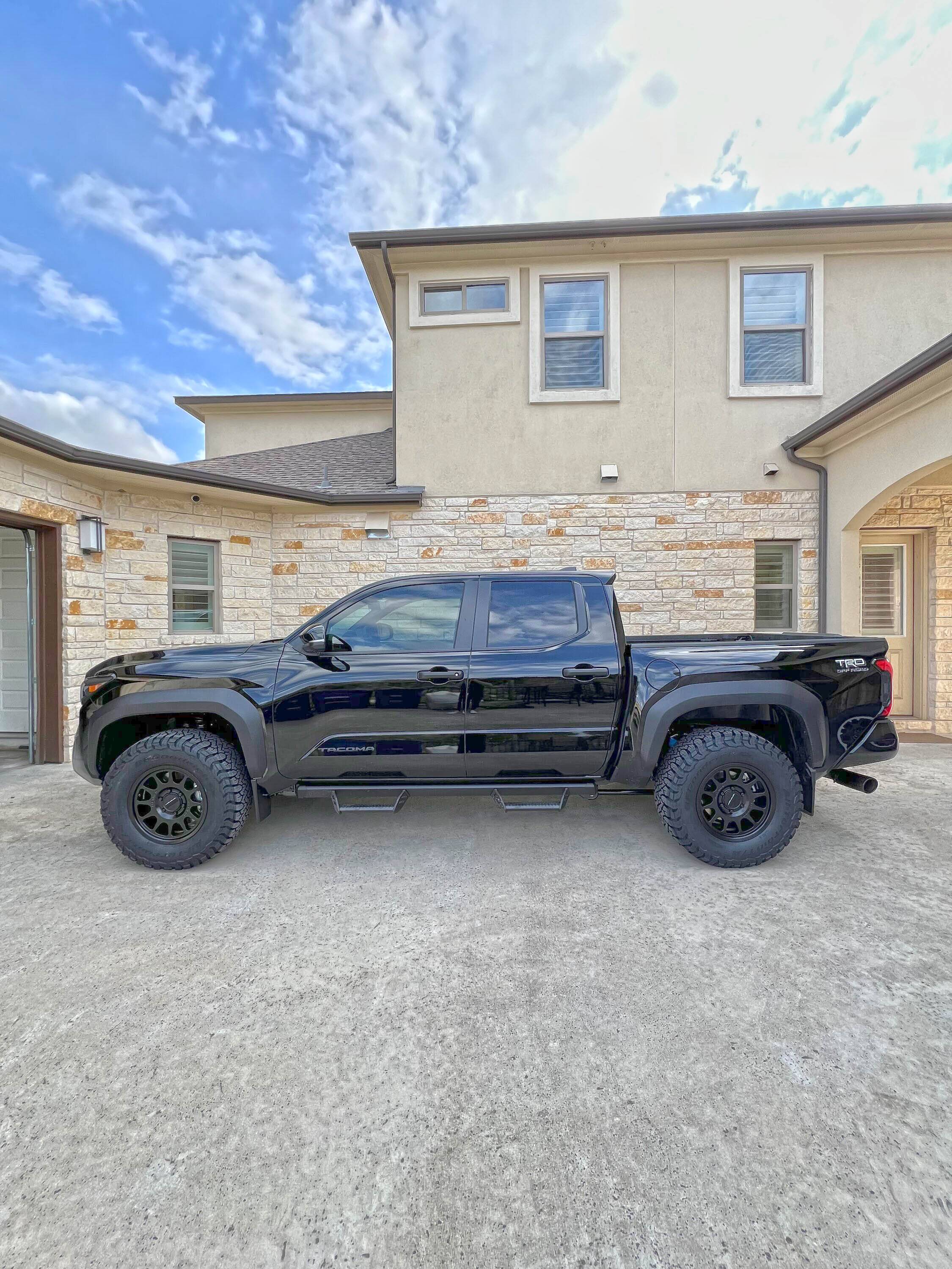

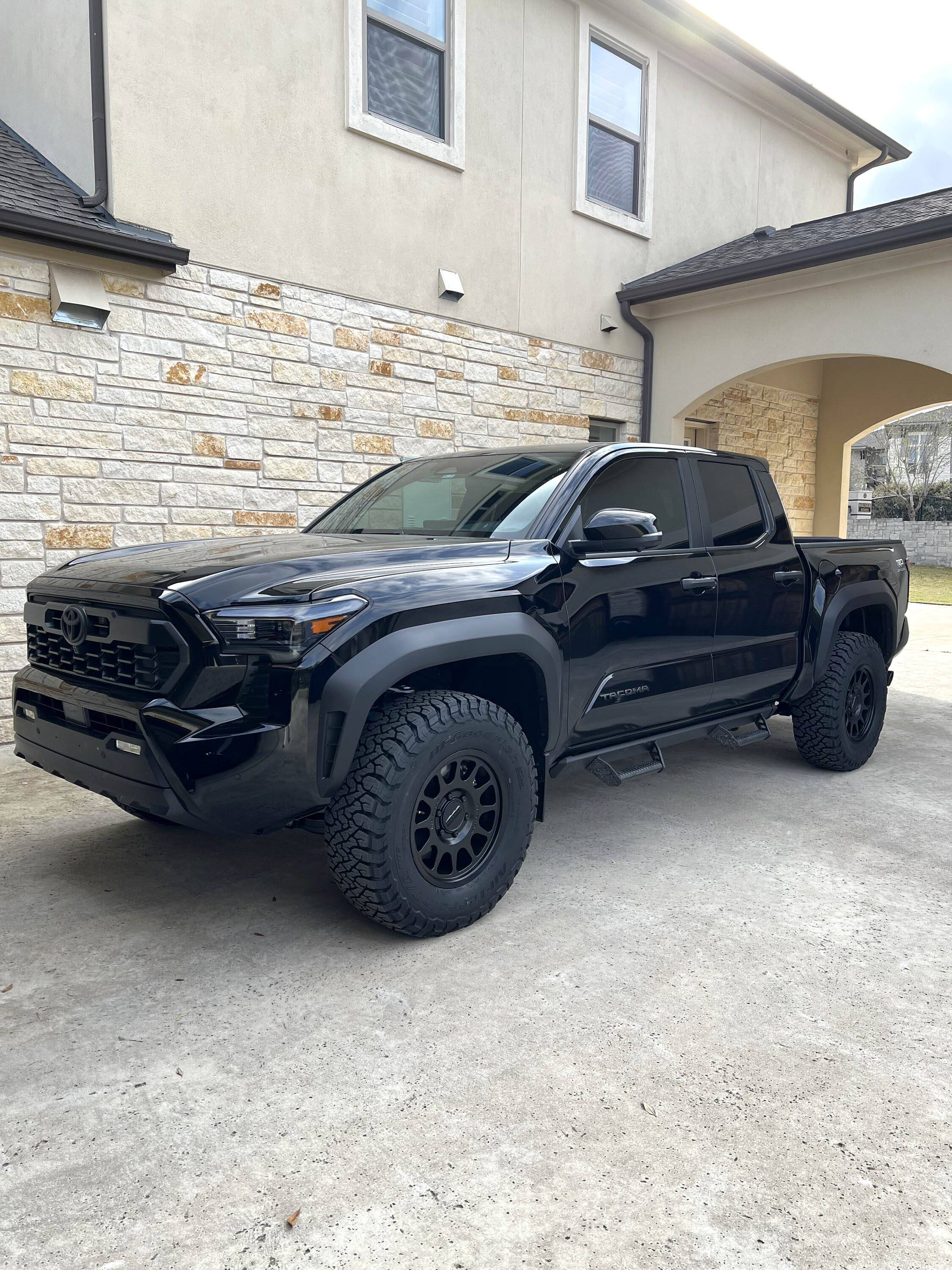

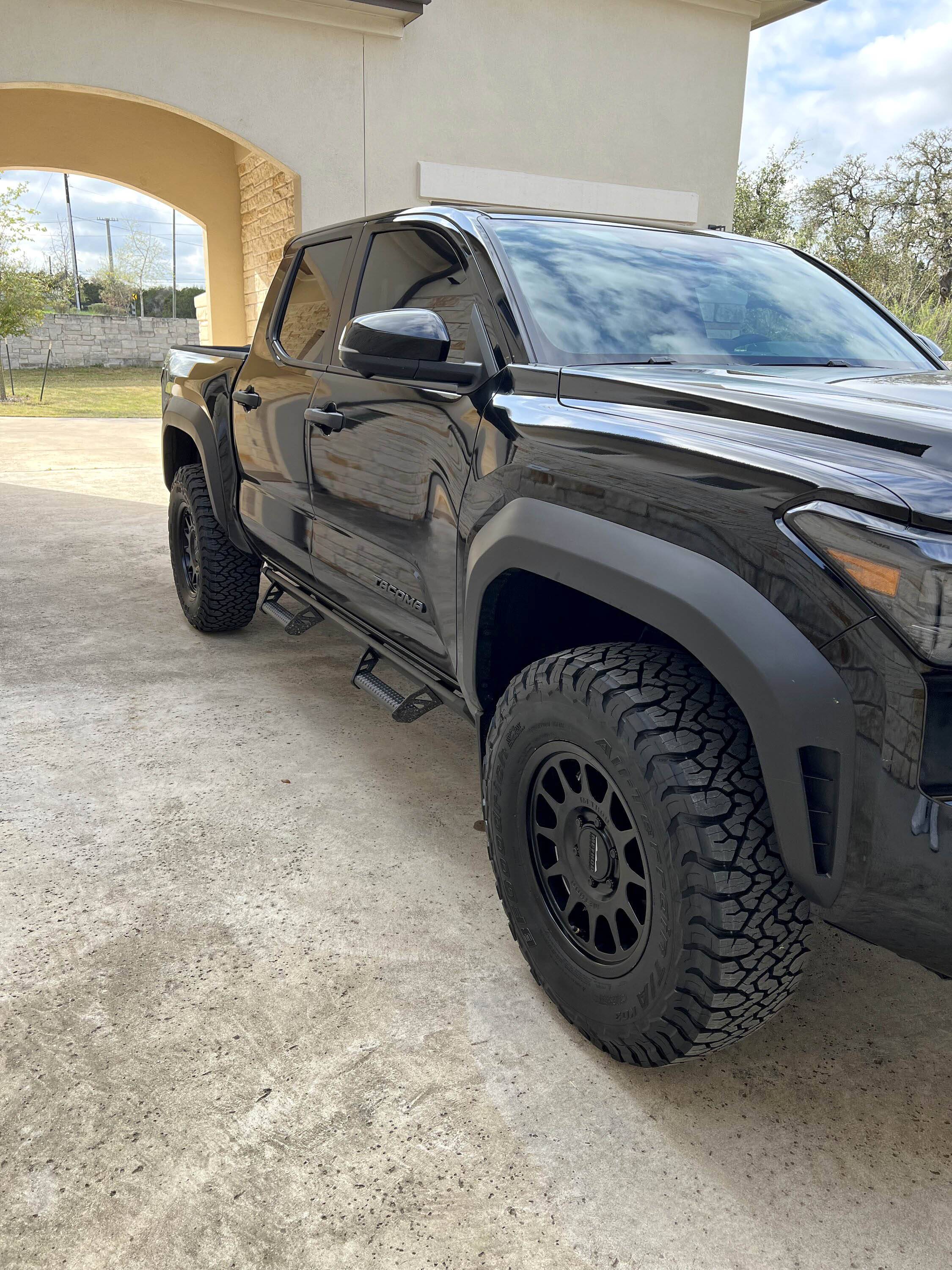

Hi folks, my name is Bill and I’m a proud owner of a 2024 Tacoma TRD Off-road Premium (Black). My build date was 12/2023. I took delivery of my truck on 2/16/24.
I’ll be posting updates of mods on this thread.
Here are a few mods so far -
Tires: 285/70/R17 BFG KO3 Load range: C
(Thanks to the guys @Discount Tire)
  • The new KO3s are fantastic. The truck feels much more planted over the stock tires.
  • Steering - IMO the steering was too light with the stock tires. Personal preference but the steering feels much more assertive and positive with the KO3s + increased tire size/weight.
  • Road noise - The increase in road noise is negligible.
  • Ride quality - I was expecting the ride quality to suffer with bigger/heavier tires, but I actually observed the opposite. The ride quality is improved perhaps because of the higher silica content in the KO3s.
  • No rubbing!
  • I’ll follow up re - long term performance / wet weather (should be improved due to new sipe pattern)
A couple differences to note (KO2 vs KO3)
  • KO3s are ~6 lbs heavier than KO2s in the same Load Range C (56 lbs vs 50.33 lbs)
  • KO3s should have improved wet road performance due to new sipe pattern/depth (In theory)
  • KO3s should have improved cold weather performance (likely due to more silica content so they remain pliable in cold temps) (In theory)
AFAIK, only (2) sizes are available for KO3s (285/70/R17 Load Range C and 275/65/R20 Load Range E) More tire sizes are expected in Spring/Summer 2024.

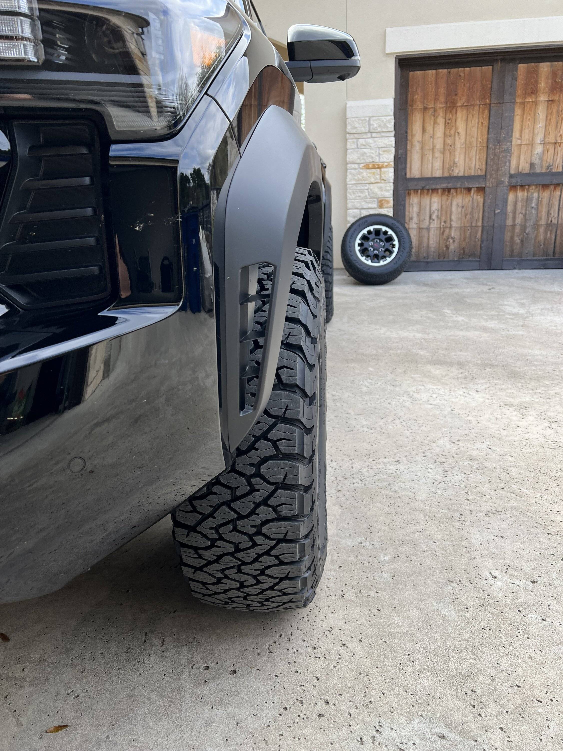

Wheels: Method 703 17x8.5 35mm offset
  • With 35mm offset, I measured 1/2” of poke (See photos). Perfect IMO
Tint: 30% All around (FormulaOne Stratos) | 90% front windshield (Llumar Air clear)
Mods (on the way)
Mods (planned)
  • Suspension lift - TBD (Most likely the OEM TRD lift when it becomes available)
  • Roof rack - Prinsu Pro (Still shopping around)
  • Dual battery / or other power system (TBD)
I’ll add more details when I’m at my computer. (Currently on the new Tacoma4G app. It is 100% worth downloading)
- Taco Bill
