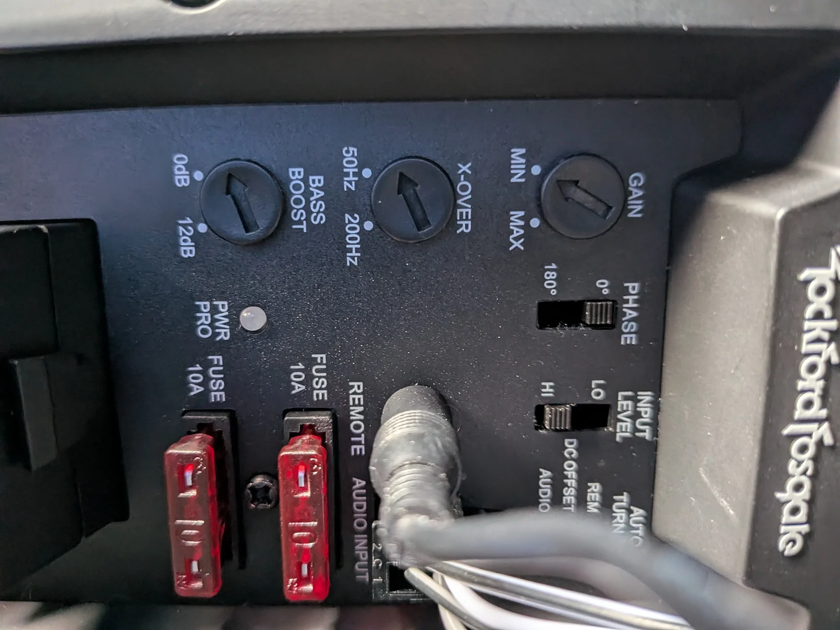

Sounds to me like you have it set correctly. Yes, just be careful with the bass boost, that is a sub killer if not done right.
And I agree, there’s A LOT of info on EVERYTHING out there. You can end up with “paralysis by analysis”. I spent a good 10 years doing that when I went from “just gotta make it loud” to “why doesn’t this sound good.” I’ve been at this for 35 years, and there’s always more to learn.

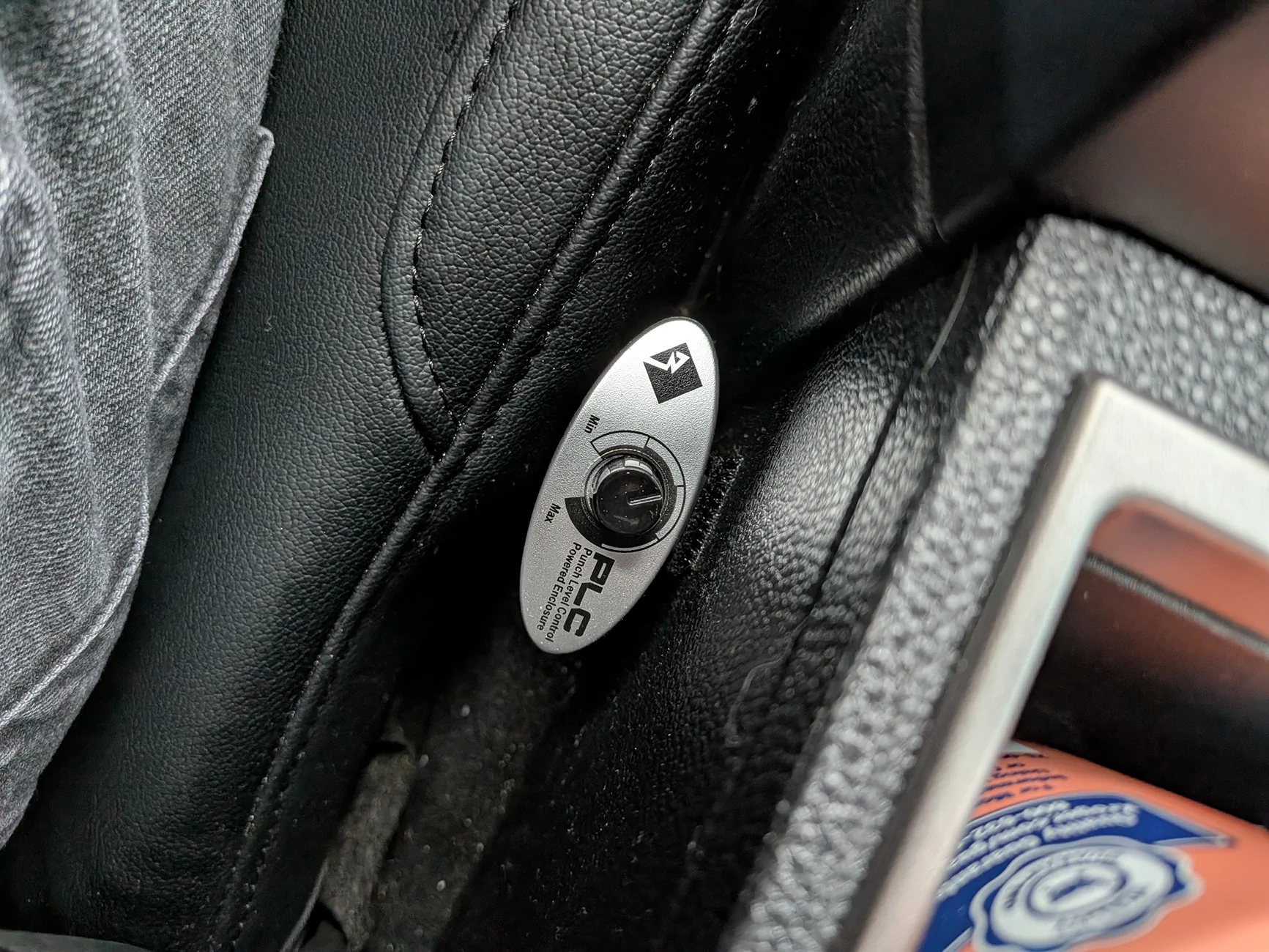

Current setting which sound good? Sorry to hijack the thread OP. So many knowledgeable people around here.
I’d probably set the x-over to the x, that’s likely closer to 80Hz. But other than that, your settings look fine. If you’re concerned, maybe try with the boost at minimum.
When you're adjusting your gains specifically for an amp, you want to use an Oscilloscope so that when you're at the highest listening volume level that your signals are still sine waves (there's a little more to it based on the frequency of the sound you're tuning against). If you just crank the bass knob and your gains aren't set properly you'll get square waves, aka clipping.
Clipping is bad mmkay.
Agreed, an o-scope would be desirable, but not everyone has access to one short of buying their own for a one-time use. And two, can’t really use it on an enclosed powered enclosure.
Ok! Thanks dude.
The one thing is that when that remote knob is plugged in, if I turn the gain at the box it does nothing at all!
Anyways, appreciate your help. Thank you

@PNWkip looking closer at the manual for your powered sub, I have a question.
Where are you grabbing the signal from for the box?
Can you possibly, this is going to be loud, get a test tone, something 40-50Hz at 0db, try kicker.com, and measure th voltage on your inputs at the box at whatever volume you initially set things up at? Because the max input voltage of that box is 12V, anything more is overdriving it.
