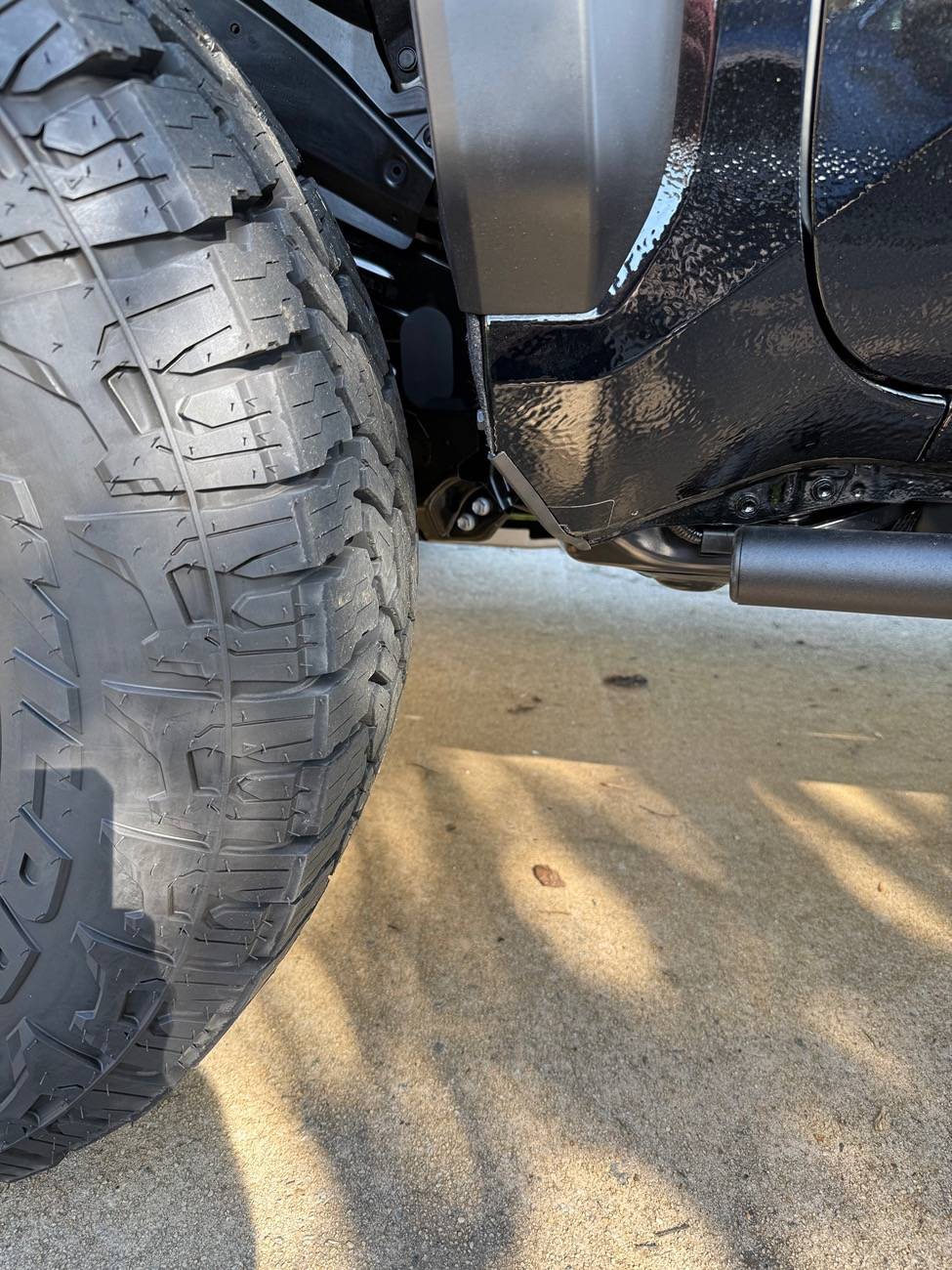

Discount Tire mounted them and I found the rubbing. Took it to the offroading shop and they eyeballed it really, I was kinda disappointed they wouldn’t discuss any other options.
That being said, it has been chopped. I didn’t love doing it, but it looks great with no more rubbing other than the case protecting the wiring harness at full lock. I’ll move it eventually.
2024 Tacoma Trailhunter max tire size IMG_3446

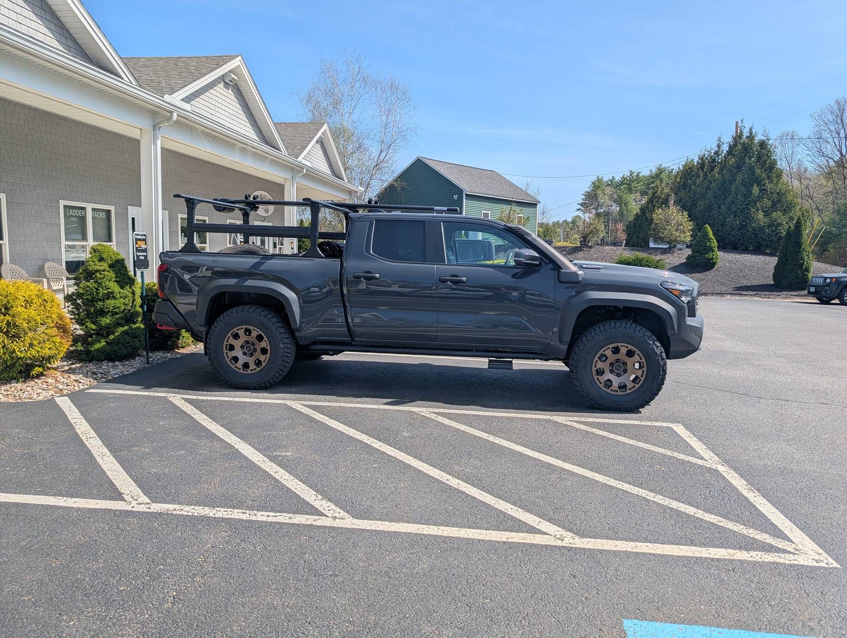

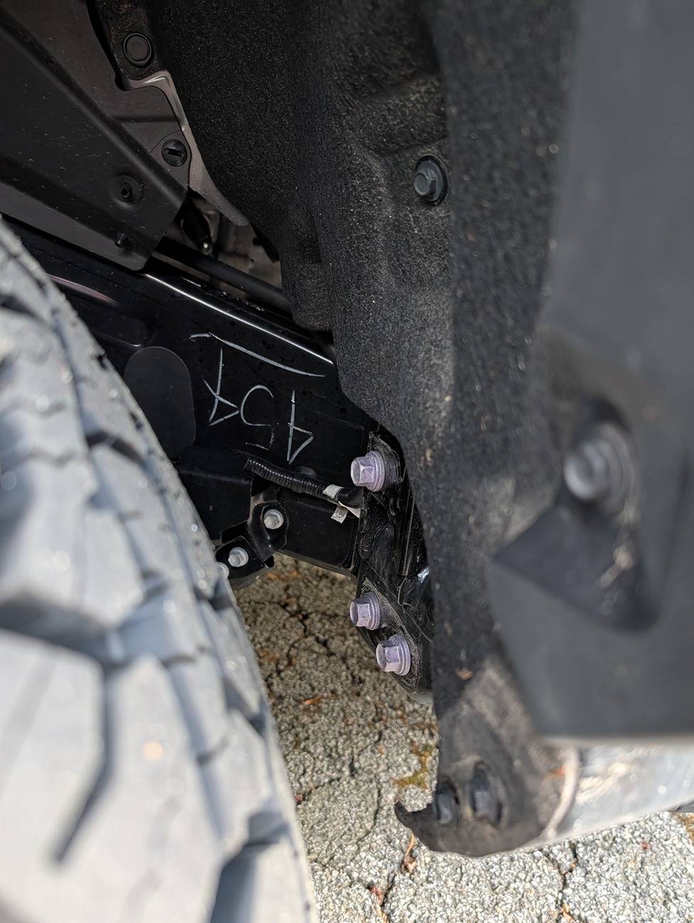

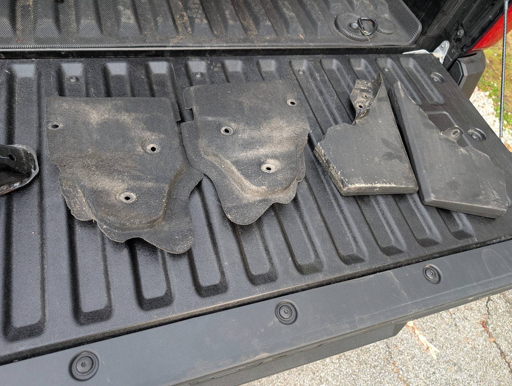

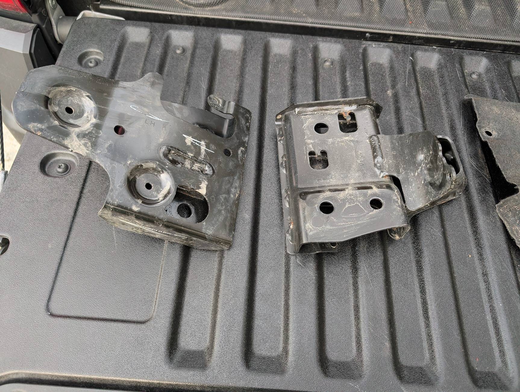

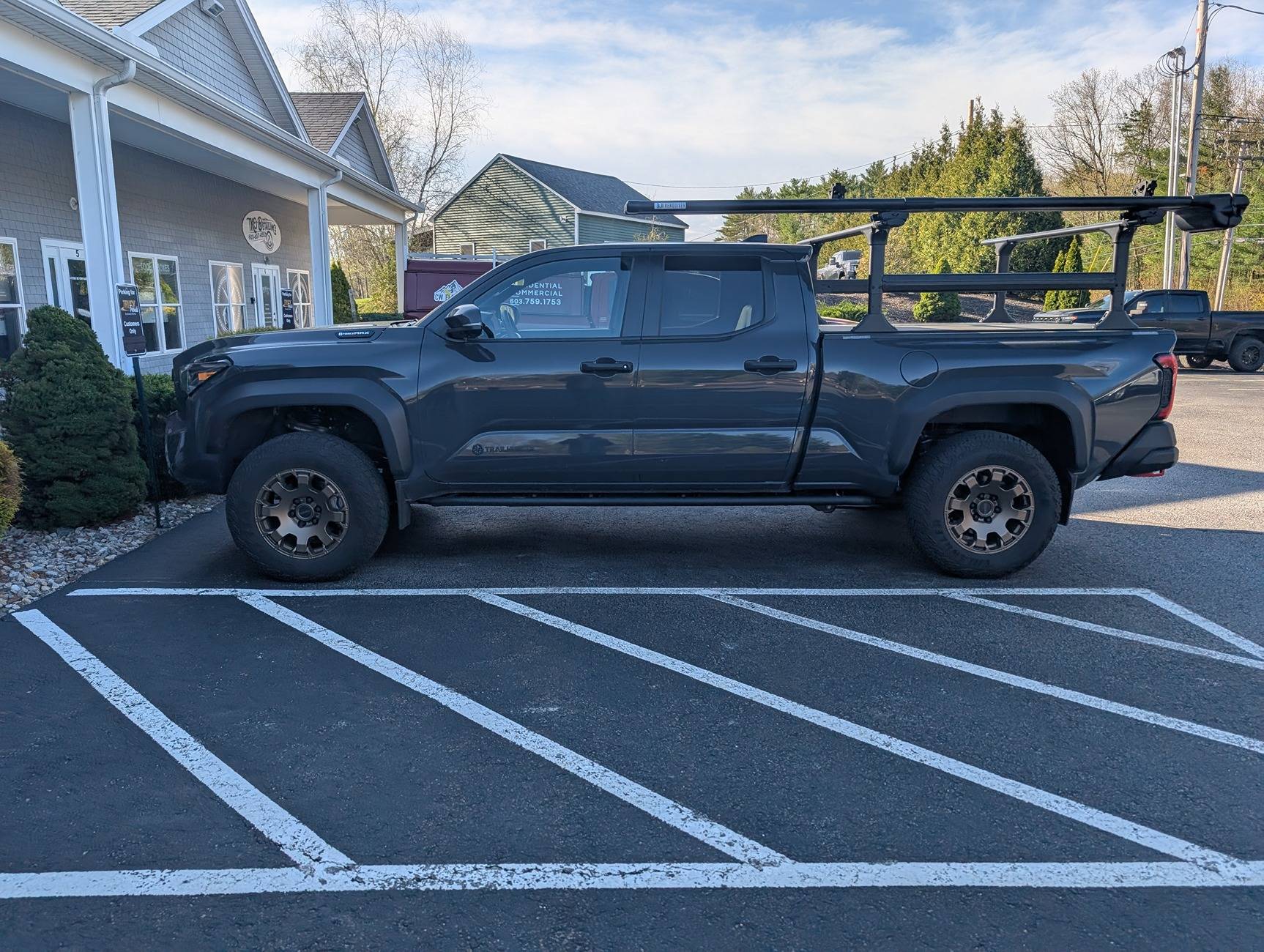

Well, it is done. Airlift in back to help reduce squat when towing, Westcott preload collar lift in front, and 285/75/18 KO3 tires (34.8"). "Pads" (with felt) and mud flaps had to come off the front. No other mods so far. The shop tells me the pads were enough and there is no rubbing. Time will tell. So far, so good. I'll see what I can do re: replacing mud flaps. The increase is height is noticeable when I get in for sure. The leveling is also noticeable when driving via the view over the hood. I'll figure I can always go smaller and put the pads back if this doesn't work out down the road.
2024 Tacoma Trailhunter max tire size Mud flaps and felt from pads
2024 Tacoma Trailhunter max tire size Crash pads
2024 Tacoma Trailhunter max tire size View of area where pad was removed
2024 Tacoma Trailhunter max tire size Before
2024 Tacoma Trailhunter max tire size After
Sorry the before and after pics aren't better aligned. And those parking lines feel like an optical illusion, especially in the first pic. Anyway...more later maybe. :)
Oh, I almost forgot. I didn't bother with a dedicated compressor for the Airlift since there is already one onboard. The valve to inflate is nicely tucked into the rear of the right side storage compartment in the bed.
p.s. And yes, I only have the nFab step on the passenger side for my wife. :cool:
