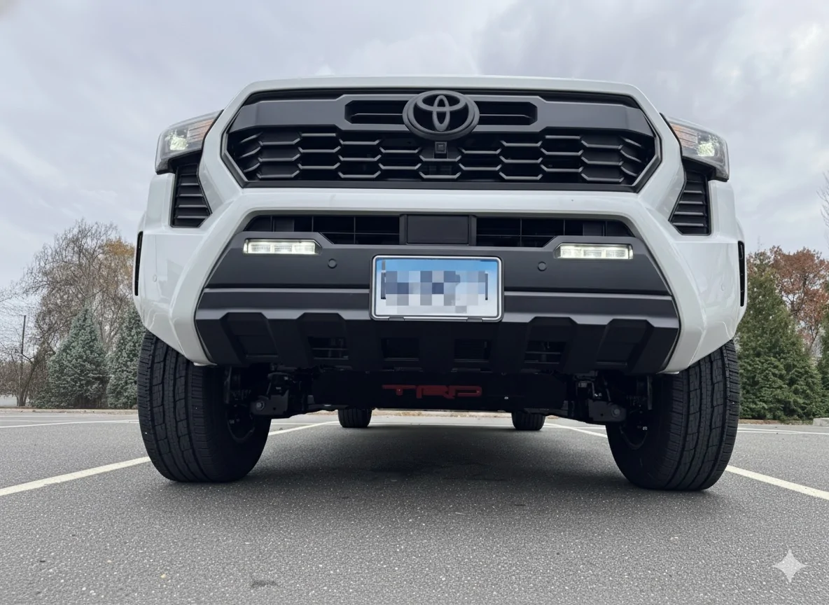

I removed the air dam and installed the APC skid plate. TRD Sport long bed. When I removed the air damn, I had that whistle/drone sound from the 4 holes in each control arm. Plugged those with Toyota part # 90950-A1021 (x8 qty). No more sounds. The APC skid plate is light duty, but better than the “soft felt” factory skid. I also like that it has an oil filter hatch, although I am only approaching 500 miles and haven’t changed the oil yet.
Rationale for removing the air dam came down to two things: I don’t think it looks good, and I am worried about it getting ripped off in the winter. If I was ever to drive cross country I would put it back on, only 9 screws. But day to day around town, I’ll take the minor hit on MPG.
