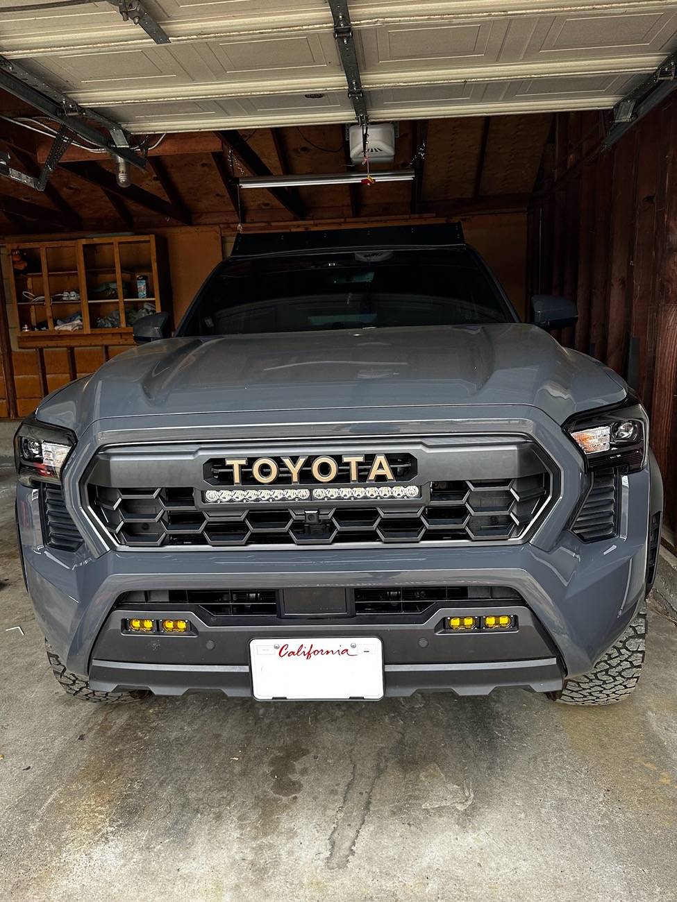

Trailhunter grill finally came in after waiting for a month. Installed a Baja designs s8 20" lightbar and Baja designs SAE amber fog lights too.
Did the light bar just slide right in? Or how does it attach? And did you link it to one of the aux buttons inside?

The baja designs light bar was a very tight fit going in the factory cutout. I had to force it in to sit almost flush. Since there wasn't enough room to fit it with any brackets, I ended up drill holes on the side of the grill and mounted it with a allen head bolt. I saw someone else on a facebook 4th gen taco group do it first. I made my own wire harness to use the factory aux buttons. All together took me about 2-2.5 hours to do the whole install.

Hello! Did you have to get a camera bracket too, was it included, or did the original one work??
