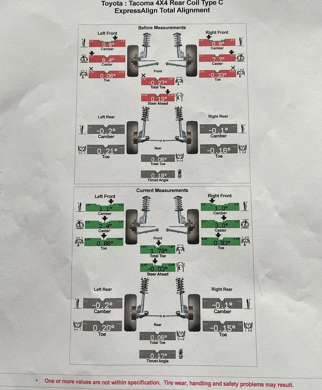

Figured i would revive this thread after today’s 3rd attempt by the dealer to align my 2025 PRO. Wheel now points slightly left of center to go straight. Truck tracks better but not perfect. Dealer said they toed in right front to get it to go straight. Top of front tires noticeably stick out approx. 1/2” from the bottom when putting a level on them. I don’t know what’s up with the before measurements. Help me understand what’s going to wear out.

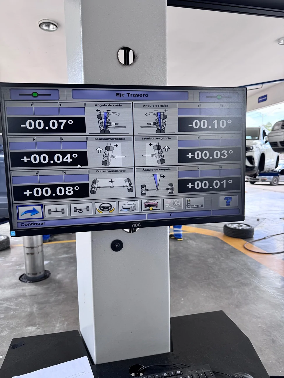

I just installed rear LCAs and was able to hit some pretty nice numbers:
This is fully adjusted with LCAs...

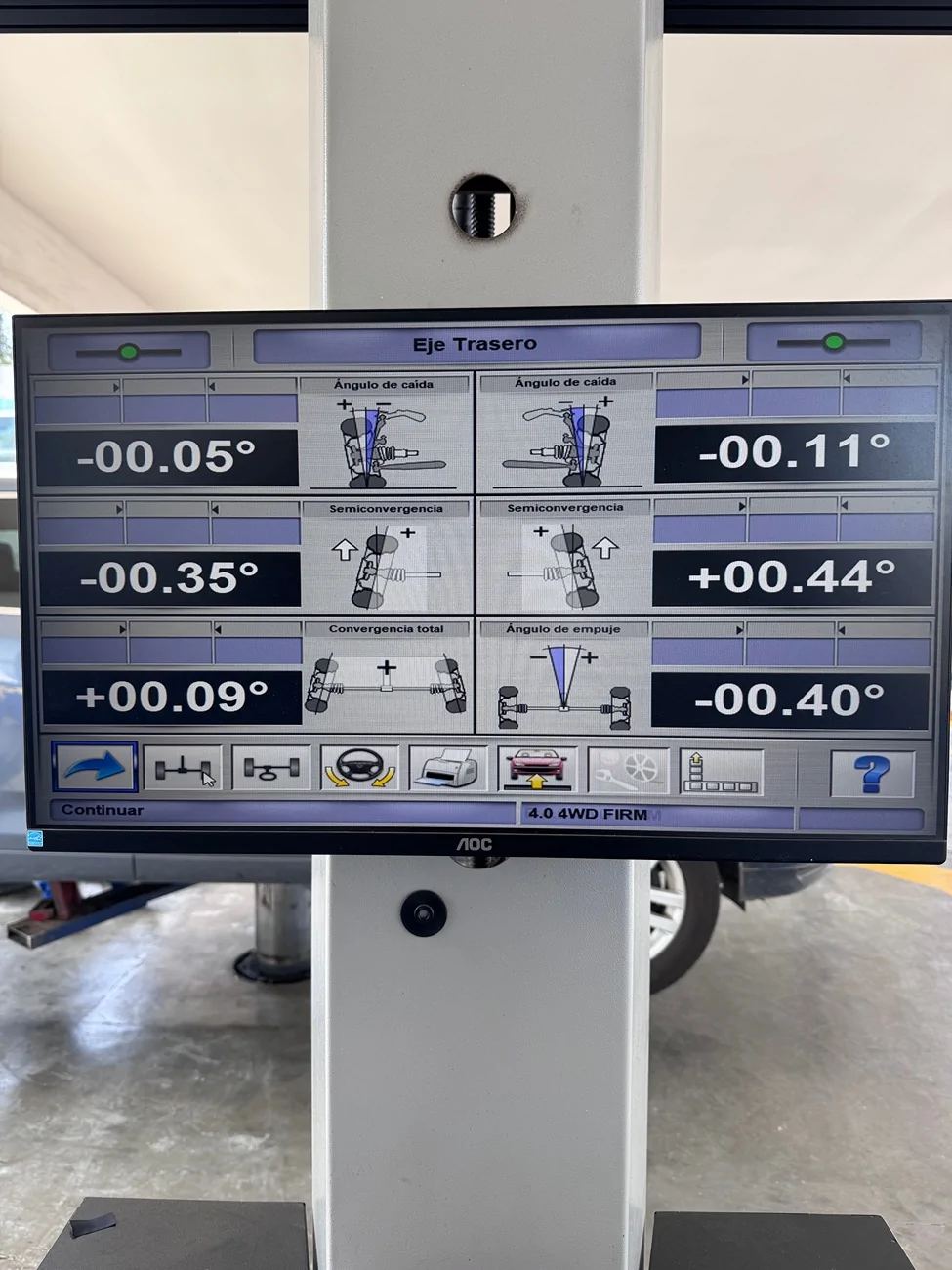

And without any adjustment...
2024 Tacoma TRD Pro Impossible to Align Properly... tempImageH6V6nu

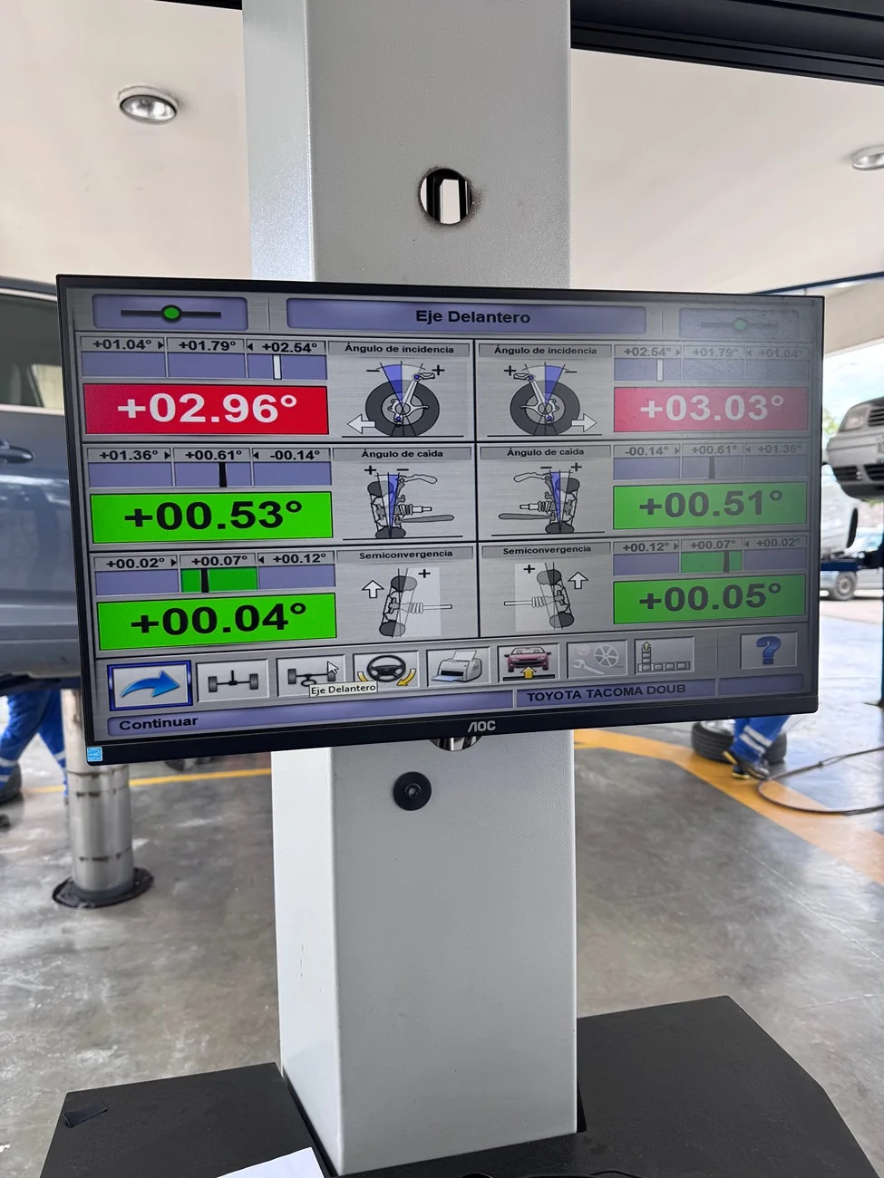

Front:
2024 Tacoma TRD Pro Impossible to Align Properly... tempImageAk0rU5
