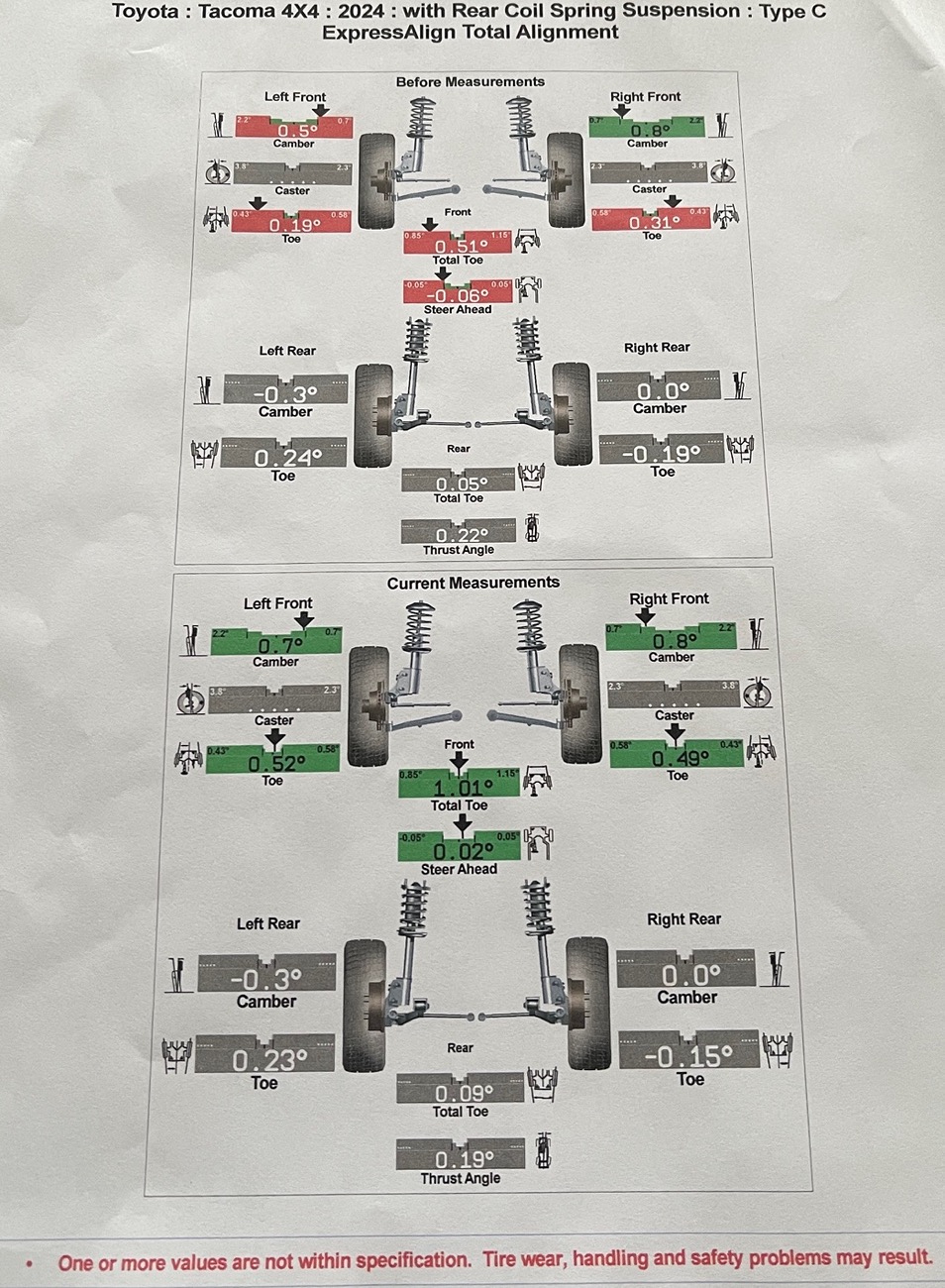

Finally had a chance to take my 2025 Pro back to the dealer for another alignment attempt. This time they agreed it’s pulling to the right and 4 hours later it still pulls to the right, at least if not worse than before. Steering wheel now seems to point to the right when holding the truck in a straight line.​

I don’t blame the dealer for the problem, but the first time I took it in they did nothing and said everything was fine and that even if something was wrong they couldn’t do anything until their alignment machine was updated for the 2025 model year. But notice my spec sheet printout shows 2024, so they could have run it the last time I was in.
I also don’t have any specs for caster….anyone have thoughts on why?
