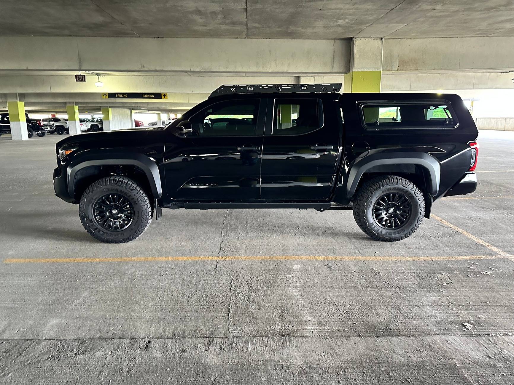

I had the same quandary. In my research, I did find the the OffRoad typically had a little better resale. The locker also makes a huge difference. You can always swap the hood on an offroad, but you cannot add the locker. I actually plan on doing that next year. As far as the suspension goes, well it's just what it sounds like. The sport is stiffer. If you are getting a pavement princess and drive windy roads, it may be the truck for you. I personally think the tires on the truck are even more worthless than the tires on the Offroad unless you live in a good climate. For the money, I couldn't justify passing on the OR. I do drive offroad through so it was more of a no brainer for me.
