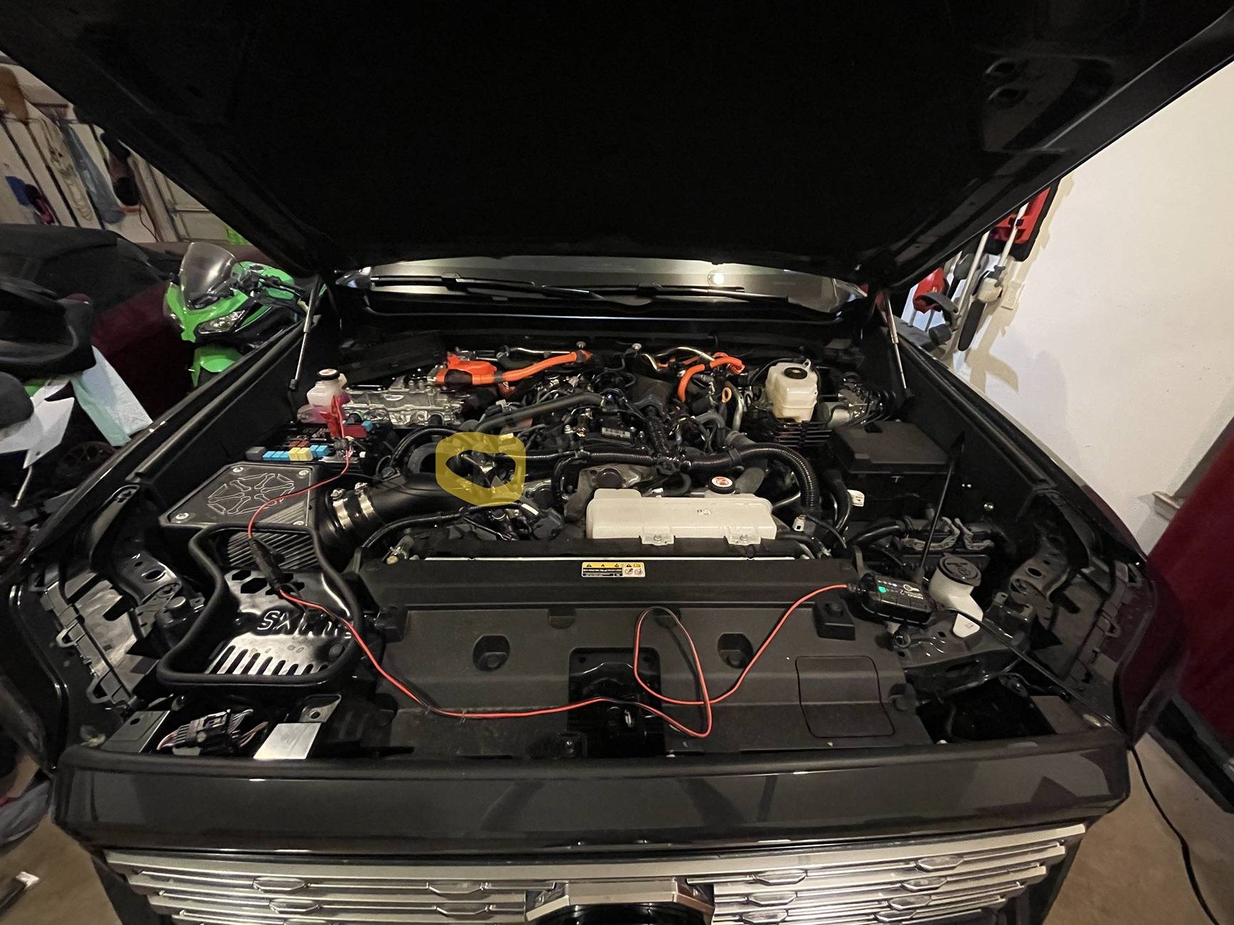

I thought I saw a post about jumping the hybrids from under the hood, rather than at the battery itself, but I can't find it right now. Assuming that is true, I think that is where you would add a trickle charger, and it would be way more convenient than accessing the 12 volt under the rear seat.
This is true, it's in section 7 of the owner manual. Basically, their example is ground to a metal part on the engine and, after popping the fusebox cover (passenger side) attach to the positive terminal there.

I can confirm that I've kept my truck on my NOCO GENIUS 2, 2 Amp charger since posting this thread with no ill effects. I was fairly certain it's not an AGM, as there is nothing on the battery that says AGM so I'm using the enhanced lead acid setting. I'm just using a 2 Amp to minimize off gassing, even with the battery being vented to the exterior, just to be safe, as I don't leave the windows open. There is a nice and shiney bracket for ground that I circled in yellow. Once I do the winch battery terminals under the hood, I'll hook up there with a permanent pigtail.
