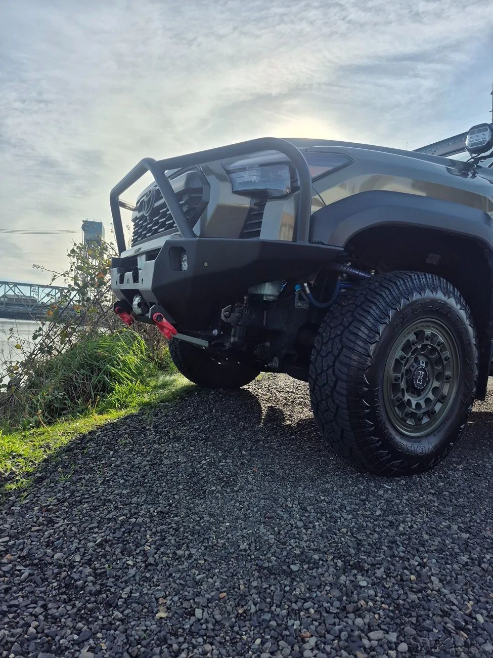

I went with total chaos. Upper control arms when I had my king lift installed.
Absolutely love them, they our nice and silent.
