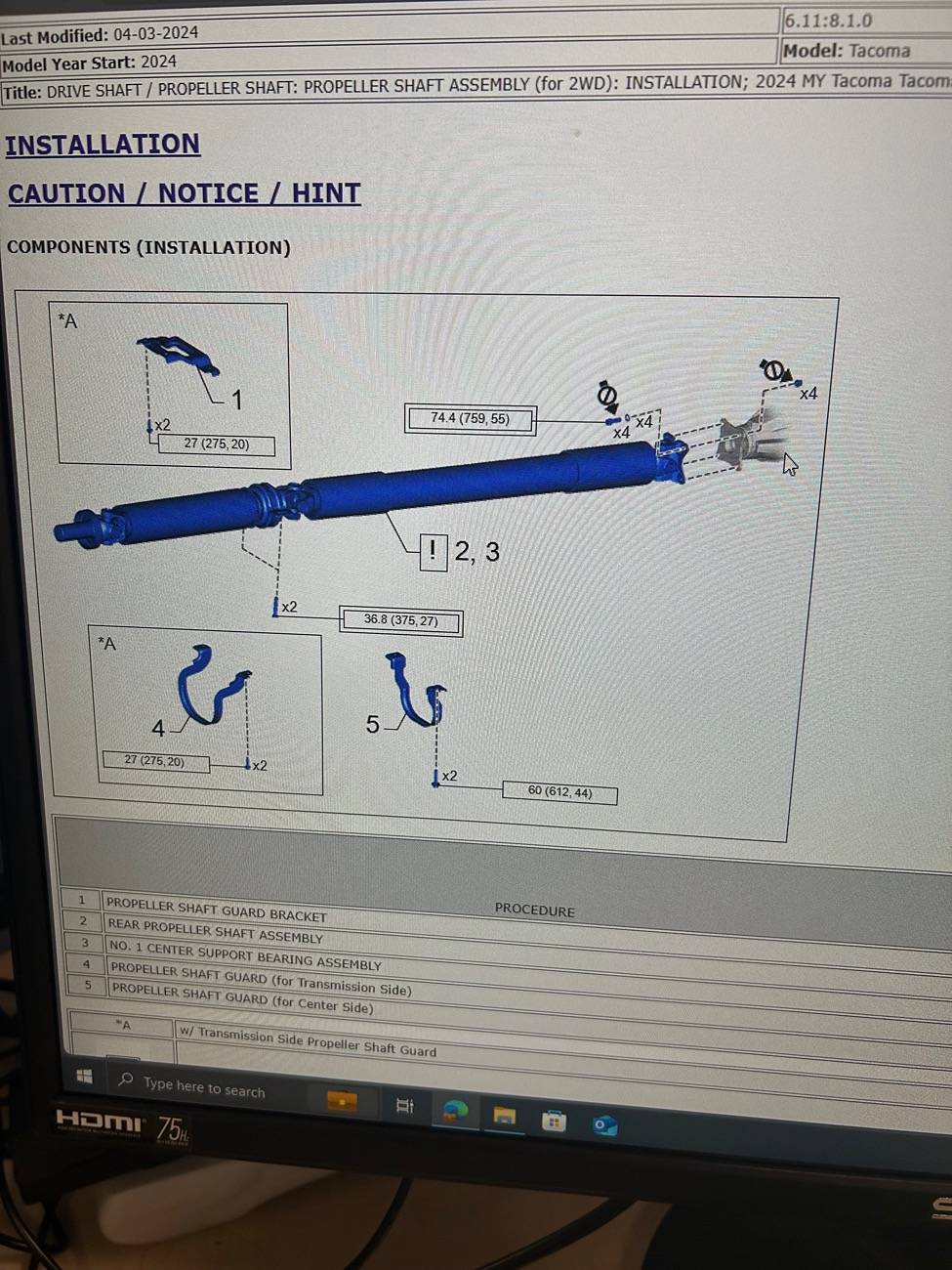

Does anyone know the torque for the propeller shaft bolts? I've found posts about the torque on gen 3 and 2, but not gen 4 trucks. And I don't see the torque listed on the map.
