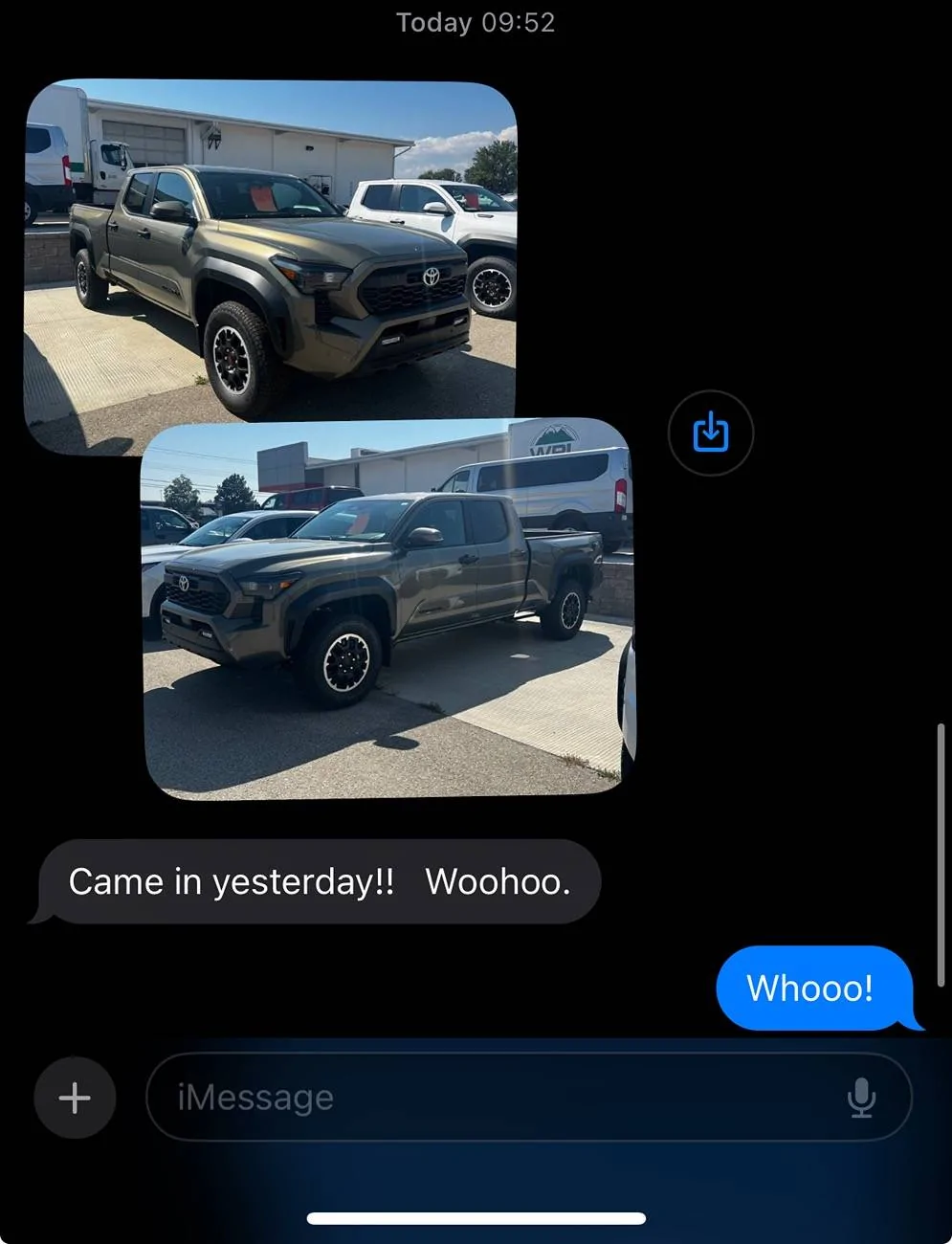

Side note, FINALLY secured my 24 TRDOR Long Bed Bronze oxide. Stoked.
How sweet it is! Congrats!!
Question, will you have a 6MT map release at some point?
Thank you for all the hard work and efforts put into the Tacomaverse.

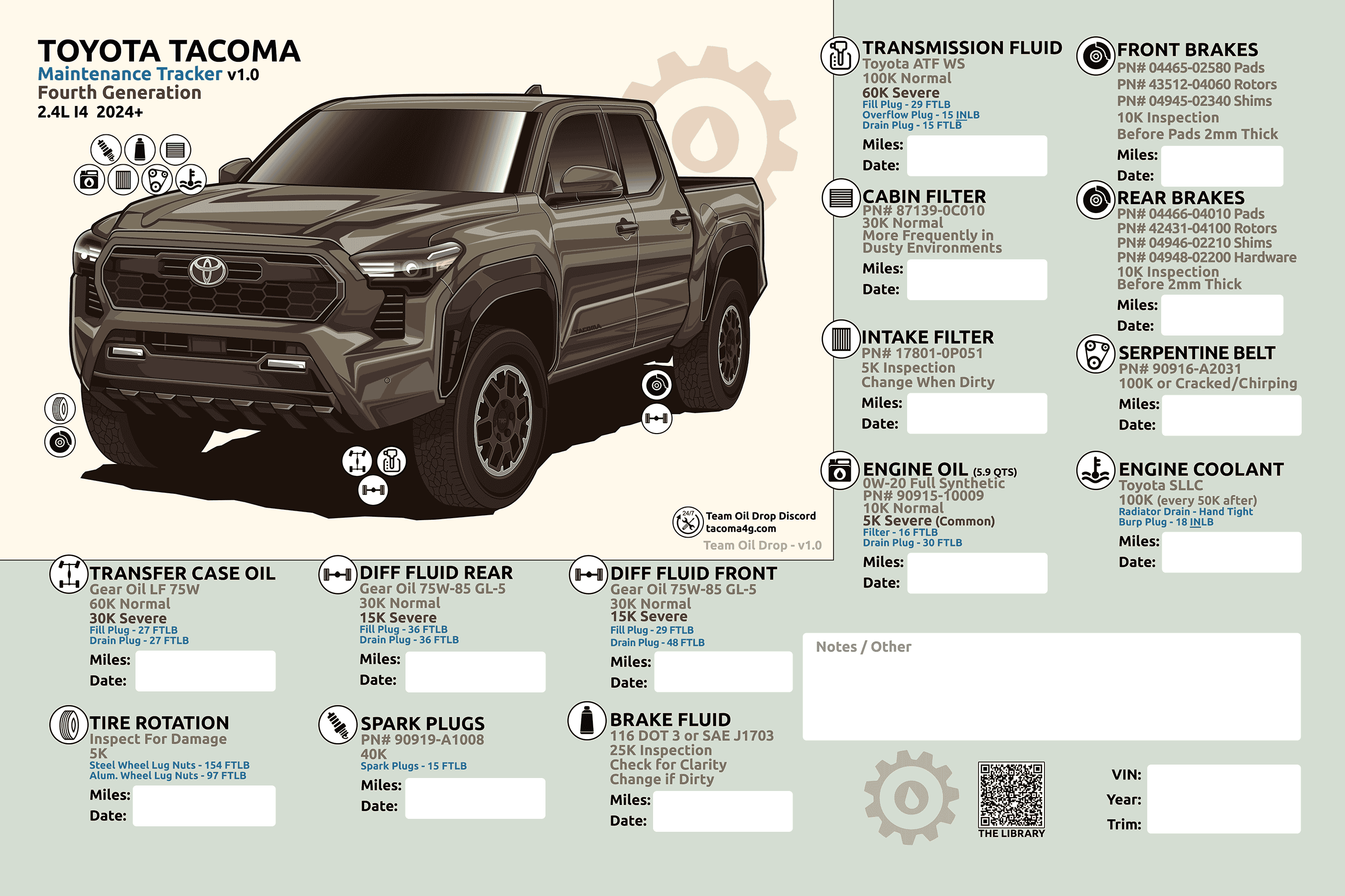

UPDATE
The Map & Trackers are now available in v1.0! It has been a long process checking, rechecking, and collecting the correct info. All info is fact based, no opinions, collected from two Toyota manuals. Part numbers and Torque Specs are straight from someone very high up with access to "the system". I hope you all enjoy these. I have all factory colors available in my shop if you choose to support (no pressure). If you don't know me from the other major tacoma forum, I run "Team Oil Drop". I will have all of us full, concise, complete videos on each of these DIYs in the not-so-distant future. Thank you, Tyler.
ORIGINAL POST
Very useful. Thanks for sharing.
Good morning/evening fellow maintainers. Here is BETA version 0.1 of the 4th gen maintenance map I will be sharing here. Do NOT use this on your 4th gens until it reaches Version 1.0. This is merely a placeholder to get my thoughts together and receive your feedback and recommendations as we progress together. Thanks everyone - Tyler
Note: I came here by recommendation from a fellow member as the tw 4th gen section is still a bit low speed. This place seems cool.

I'm interested in the Manual transmission info as well

I doubt it has that many differences, only a little more coolant and maybe cleaning the hybrid batteries, but will you do one for the hybrids thats seperate? If not, I am going to buy one of these right away.
Thanks
There’s no immediate plans for hybrid changes on the maps yet… sorry for the late reply

Hmmnnnn, I don't see any responses to the messages below.
Are you going to do a manual transmission version?
Oh well. It seemed like a nice way to keep track of my maintenance requirements, but I guess it is not to be.

Generally I don’t make a separate tracker for the manual transmission as it’s only one of the multiple tasks that are different. Couple that with a tiny percentage of 2024s being MT most MT guys just know this and don’t bother. Sorry not the answer you’re looking for. I’m not saying it won’t happen, just pretty far down the to do list.
