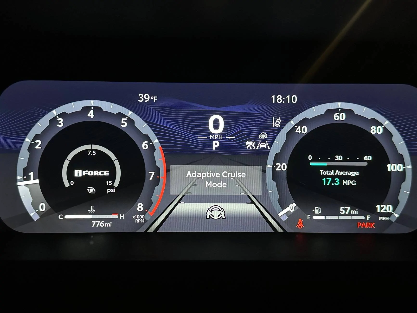

I’ve been sitting right around 17mpgs for the first few weeks of having the taco. 285/75/18. Strongly considering different wheels to add some personality to her but that probably won’t help.
maybe they were onto something w the air dam? šŸ˜‚

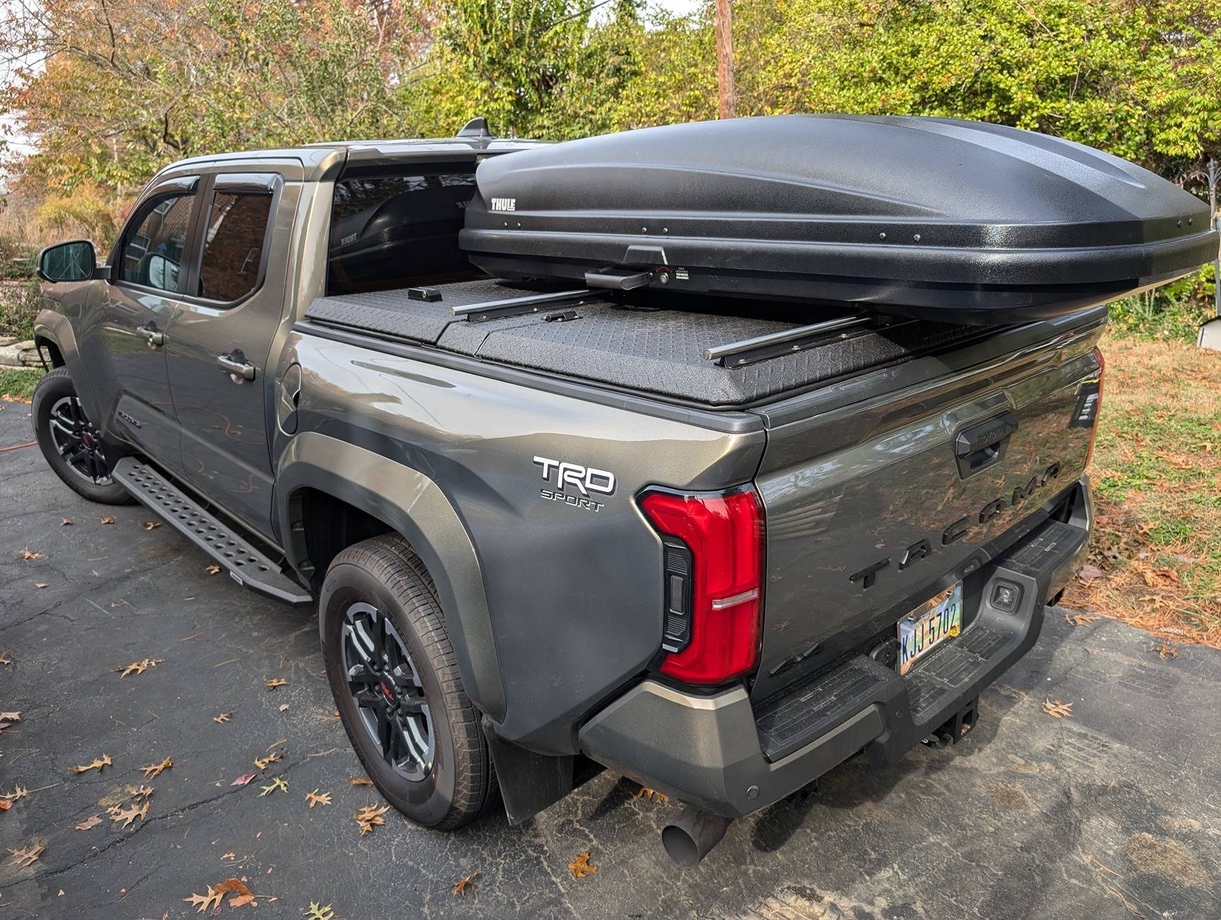

Aerodynamics seems to be the biggest factor.
Here is my experience on a recent trip Cincinnati - Aspen
Factors '24 Sport w manual trans - all highway driving.
Numbers hand calculated at each fill up. In some places in mountains regular was 85 octane so I went with midgrade 88 or 89 which were both tanksfulls that got 20+mpg but also running in much thinner air which reduces drag.
Air dam in place, Diamondback 270 bed cover w Thule 615 Ski Carrier mounted on bed cover on linear bearings to allow hatch access.
Go Rhino RB20 Slim side boards, 24 Trailhunter lightly used wheels/tires BF Goodrich TRAIL-TERRAIN T/A 265 70 17.
Mileage on this trip varied quite a bit depending on speed, headwind and altitude/climb.
Overall trip average was 18.6mpg. Could probably have got 20 if I was closer to speed limits.
21.4 Cinci to Indiana - some wet roads - no wind running 80
17.6 Illinois - running 80-85
17.7 Missouri running 80-85
17.4 Kansas running 80-85 slight headwind
16.7 Colorado running 80-85 butmore headwind and uphill to Denver
20.8 Denver to Aspen 5 stops in Denver, big climb, running 70-75
21.3 Running around in mountains 65 - 70
21.2 Back down and through Denver
17.3 Kansas - 80-85 no wind
17.6 Missouri running 80-85
17.5 Illinois - running 80-85
18.9 Indiana - home 80-85 Not sure why I get better mileage in final leg across Indiana both coming and going - might have been a tailwind coming home,

but the first leg out is a mystery why I got so much better - roads were wet half the leg. Tire friction?
Air dam doesn't do a thing.
@dvazquez I honestly would not worry about it. These things fluctuate a bunch. You will get all the hyper milers claiming they are getting 30 etc etc. There are plenty of us that just drive normal and we are getting 18-20. As mentioned above each tank can fluctuate 2 mpg easy. Removing the airdam did nothing pos or neg. Adding the bed cover also did nothing. adding a level kit did nothing. Before and after all those mods I can still get 18.0 and sometimes I can get 20.0 pure tank. 10K avg is 18.3.
