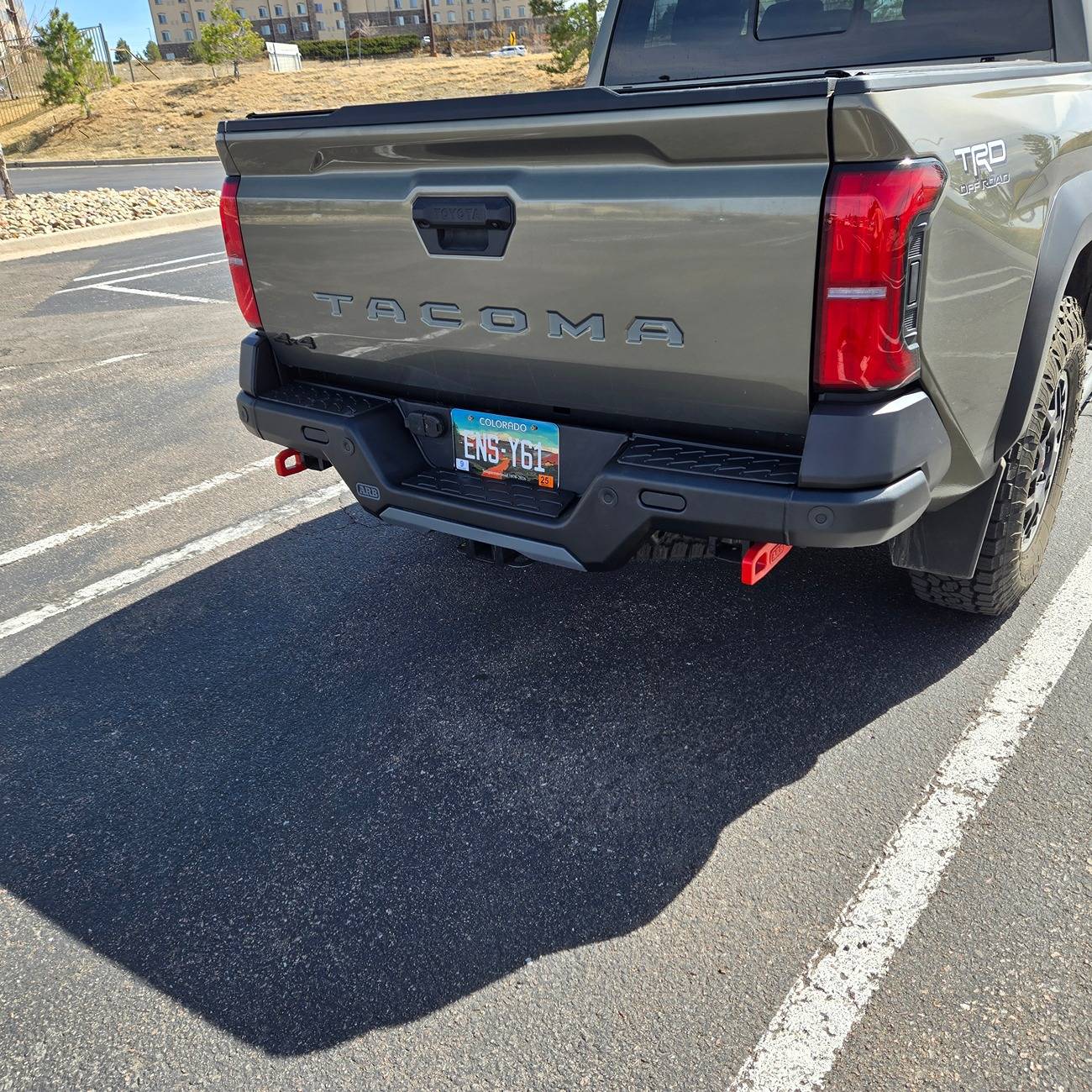

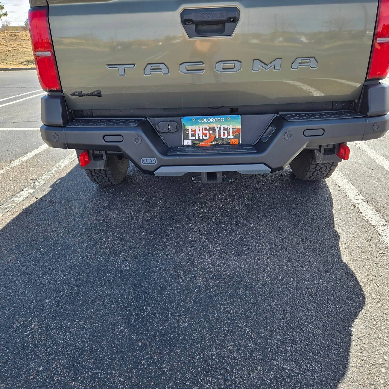

I picked up my ARB bumper yesterday and installed it. It took about 4 hours, but went on pretty easy.
No instructions come in the box. Fortunately when I ordered it I was able to get a PDF file from the Toyota (attached)
The instructions say you need to order a new wire harness from Toyota, which I did. The clips and retainers are all layed out to the ARB design.
The bumper comes with 4 new Sonar sensors. You do reuse your Blind Spot Monitor sensors (Corner sensors above bumper)
The only issue I had was after I was done, the Parking assist was disabled for front and rear. Everything else going through the harness seems to work; lights and Blind Mode sensors
The instructions tell the tech to perform a Parking sensor calibration and I don't have that capability.
EDIT: Update see post #16. If you reuse the stock sensors in the stock locations everything works and you don't have to do Calibration
Searching the internet I didn't find anything about my issue. I asked a person on here if the shop who installed his bumper recalibrated the sensors and he told me that they sent it to the dealer to register and calibrate them.
I reached out to the Toyota Dealer I bought the bumper from and he confirmed with the lead service tech that the system goes into open loop until they program the new sensors.
I will be taking it to the dealer on Tuesday to have that done.
I had two questions before I ordered it
1) Will the bumper be heavy enough to cause any droop on the rear? The answer is no, it measured the same before and after
2) Do I need to order the new harness? I likely could have made the stock harness and parking sensors work, but I didnt try
The other aftermarket rear bumpers reuse the existing sensors and harness and likely could have done that here. I did remove the stock harness and sensors from the old bumper in case I need them for troubleshooting. I could plug the 4 old sensors in and connect it to the truck to see if the parking sensors work again, but will follow through on the Toyota Calibration

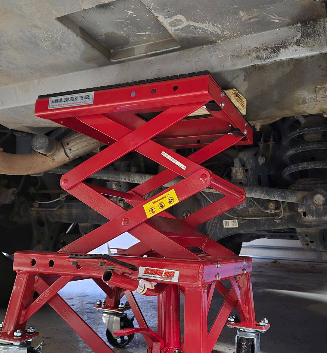

One other note, I bought this stand on Amazon to remove and replace an Aux fuel tank in my Land Cruiser (pictured). Once the bumper was complete on my work bench, I transfred it to this stand and worked it into place. It made it easy for one person to install it
Very happy with the robustness of the design. I wish I knew ahead of time using the new sensors required calibration as I may have played with the old sensors before fully assembling the bumper. Not sure if they would have fit and stock has different sensors center vs outer. The ARB 4 sensors are all the same and the same as the stock center ones. I am sure I will be happy in the end to have used the new sensors and harness :)

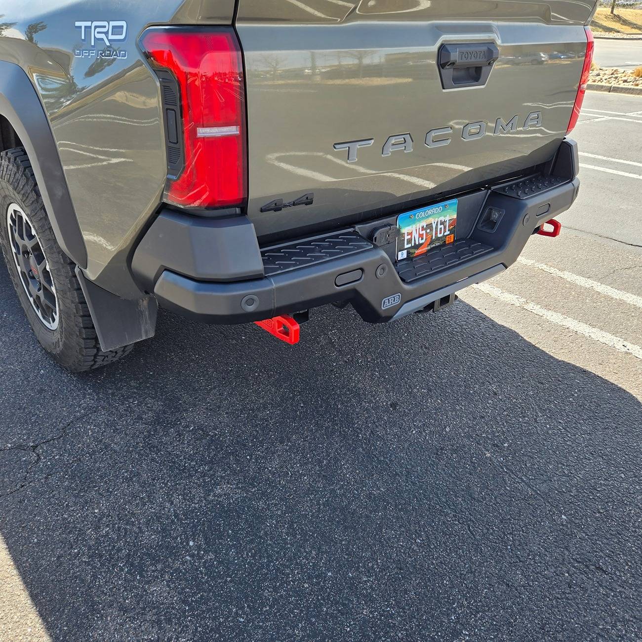

I do have a question maybe those with a trailhunter can answer. There is an unused connector that clips to a bracket on the pasenger side of the bumper. I am guessing it is for accessories like lights. Anyone know for sure?

Maybe the extra plugs are for the arb oval lights for this bumper?
On my Trailhunter I do not have anything plugged there. The wiring harness just above there is the harness for the Rigid oval lights in the bumper
Thanks, so you are confirming you have the same unused connector. At least I didnt miss anything in my install
I wonder what it is for?
When I traced the harness that the connector is spliced into all the way to where it ends passenger side, it goes behind the right sensor. So, I wondering that the connector is for diagnostic testing on the bumper sensor, i.e. re-calibration.
