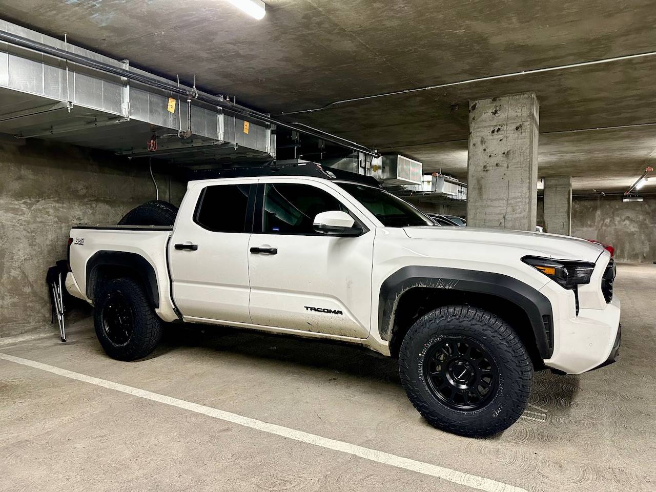

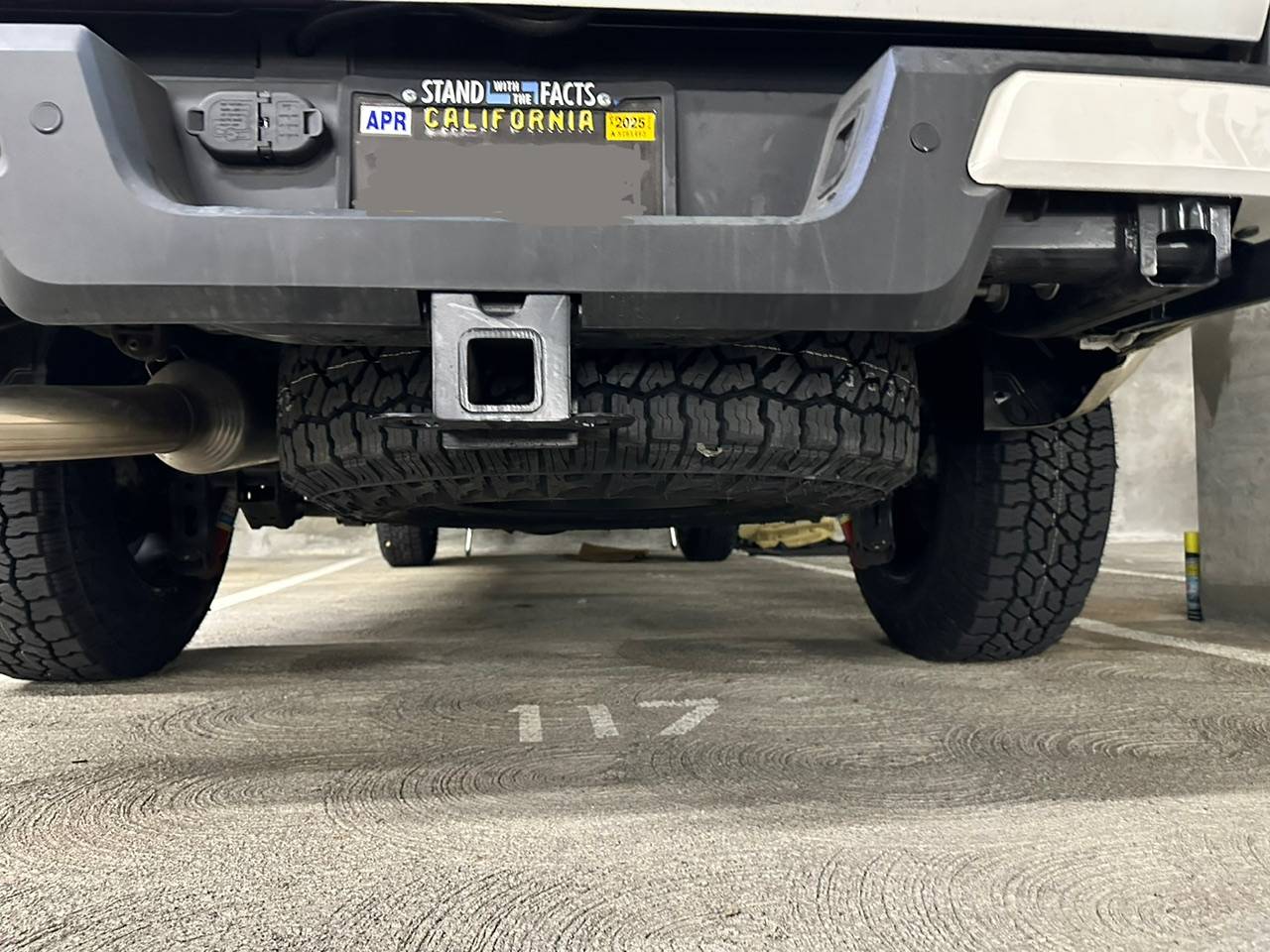

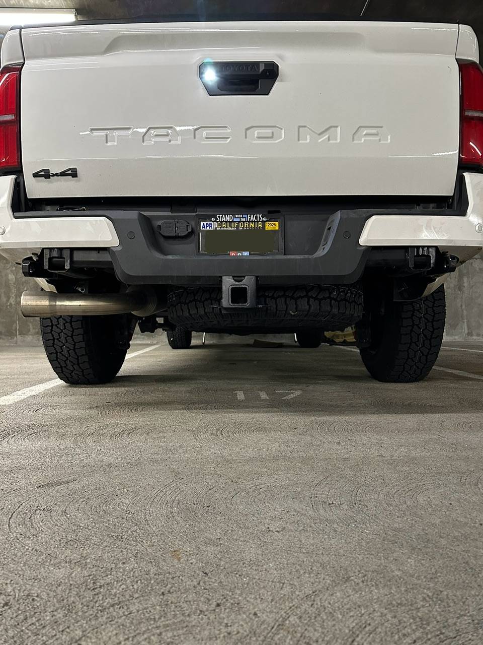

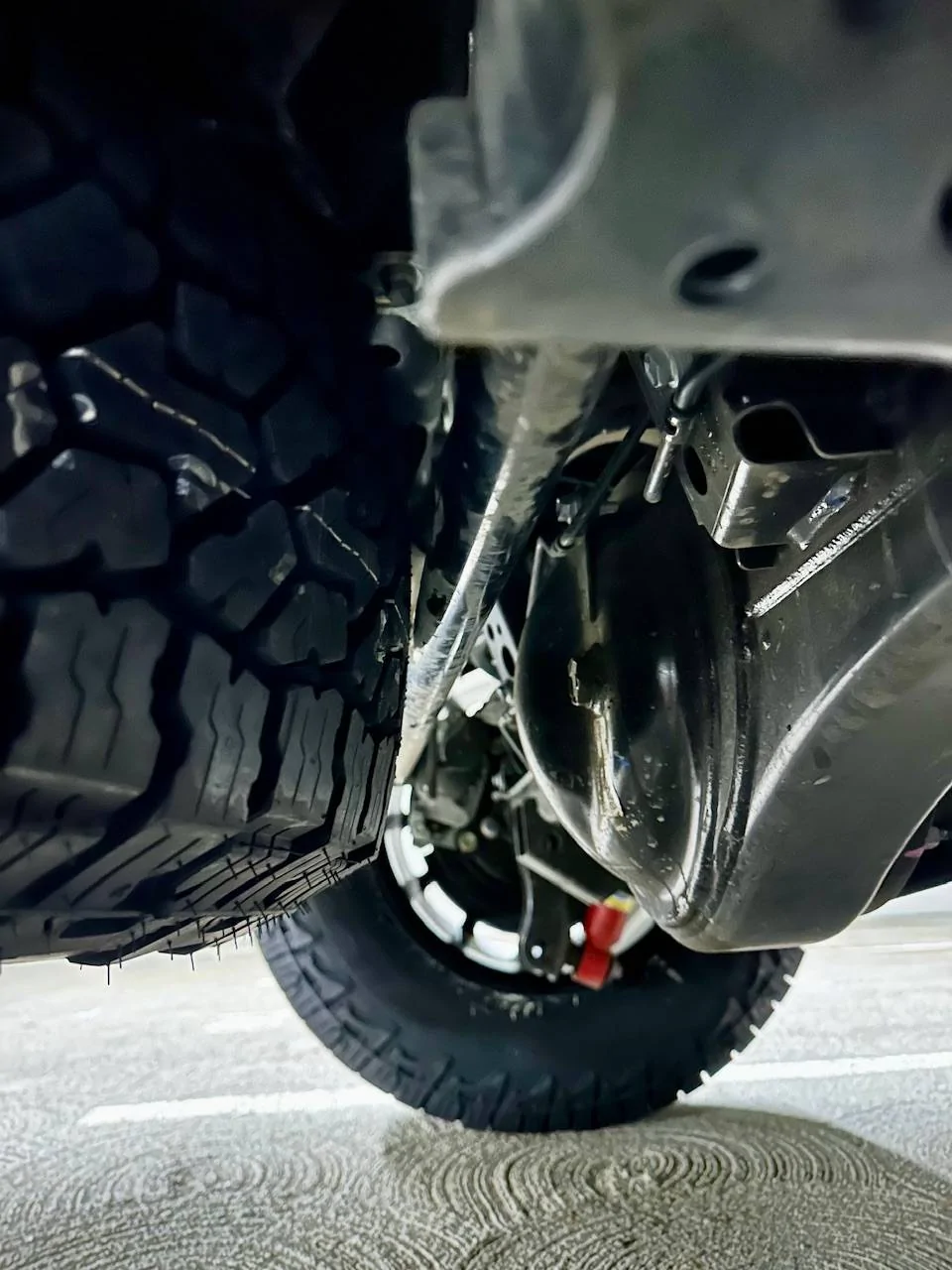

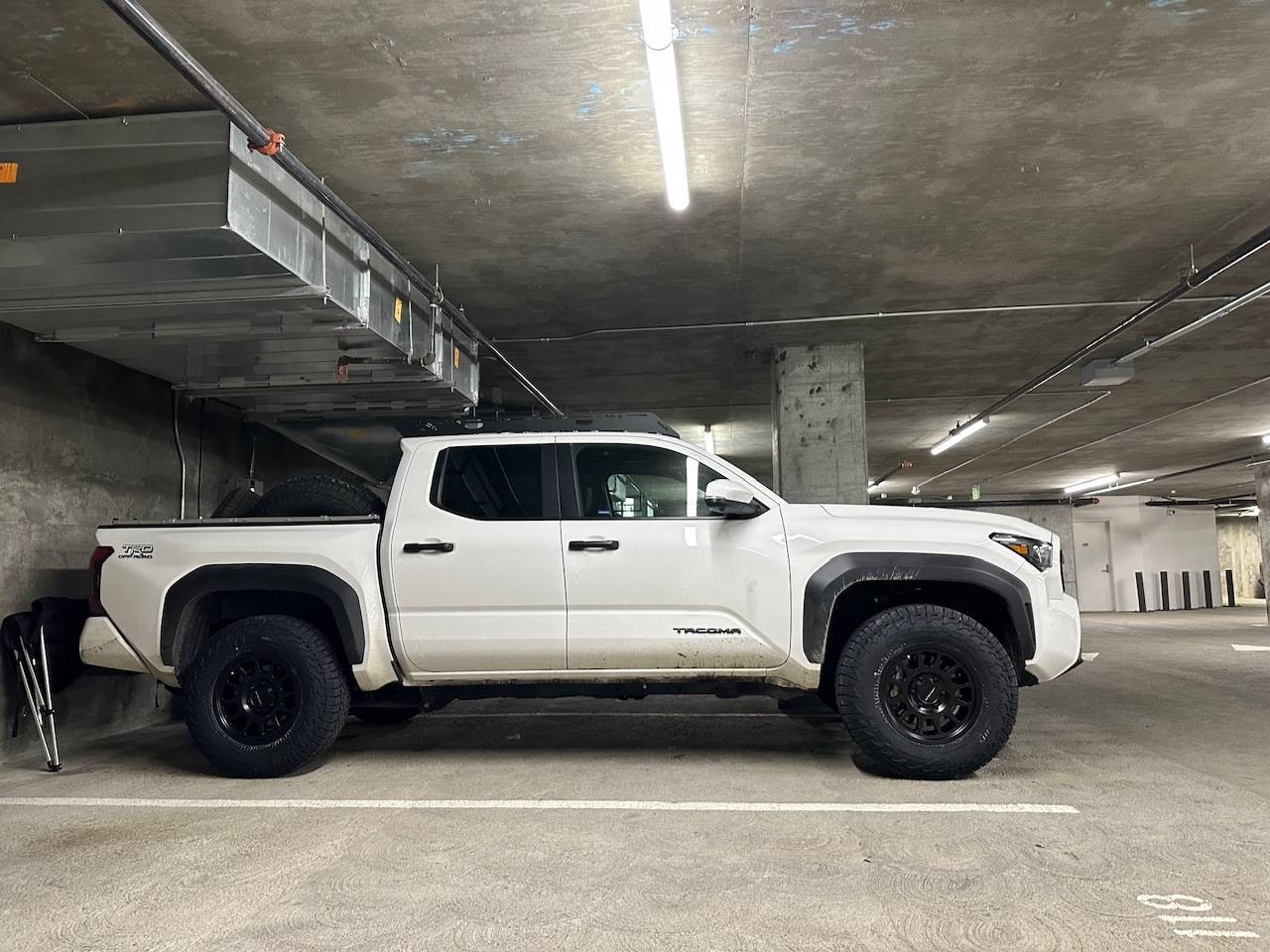

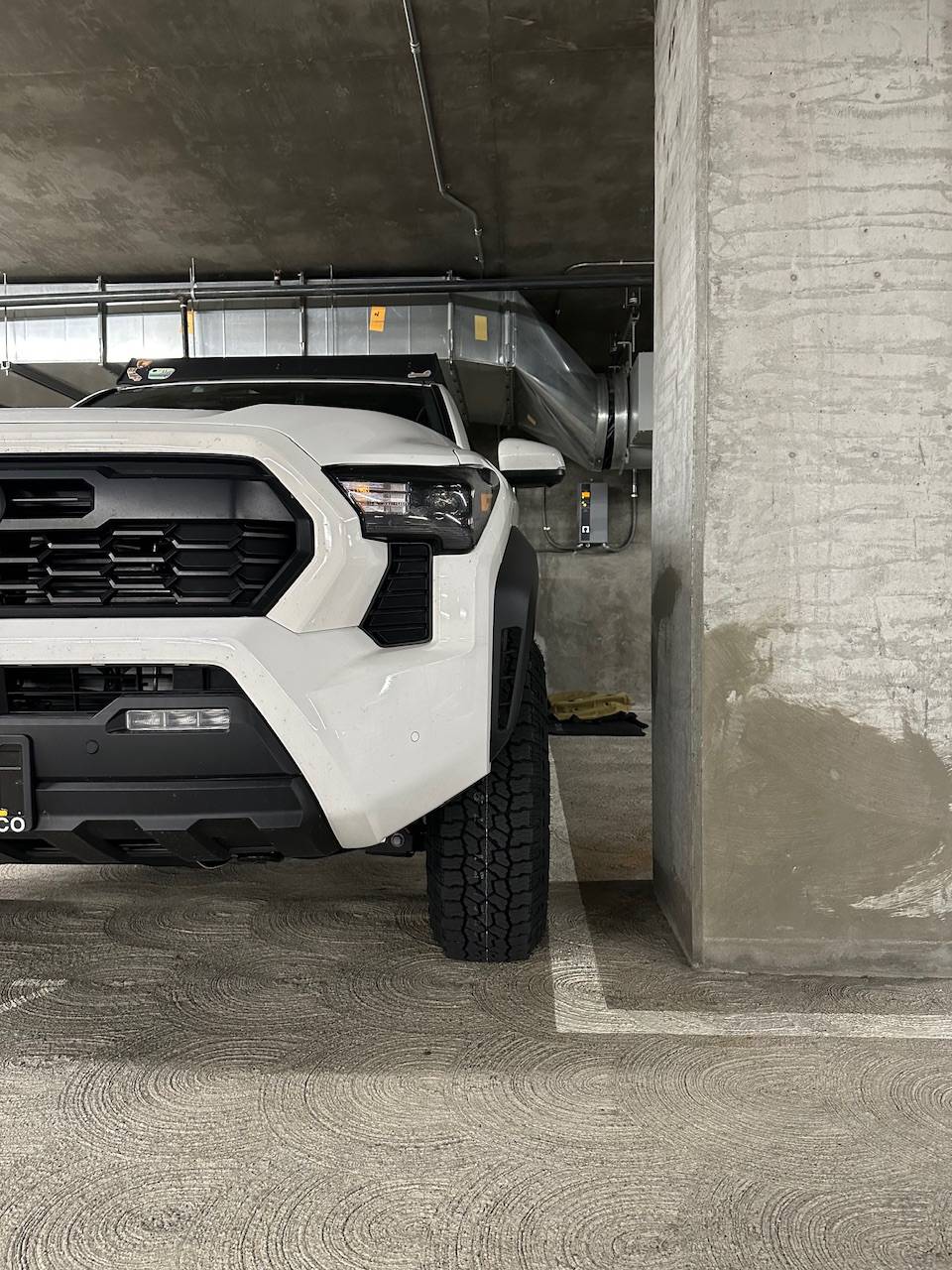

Mostly posting as I was curious how these would fit / look and if a full size would fit in place of the spare. Good news is they fit great and align perfectly with the fender flares, look great, and fit in the spare spot (very tightly).
Tires: LT255/80r17 Falken Wildpeak AT4W Load E
Wheels: 17X8.5 METHOD MR703 +25mm offset

How do they ride? This is a great choice for performance, off-roading capability, weight savings, handling on the highway, and fuel economy (low rolling resistance). I personally prefer the look of a wide tire but recognize that the skinny is better for performance.
Your tires are a true 33” which is ??

They ride great! Definitely stiffer than the stock tires but worth the peace of mind when it’s tire versus rock. It was definitely for all those reasons I went with these - plus not hanging as low in the spare tire spot. They really fill out the truck better too imo.

!!! Dude you did it, thank you, they look awesome. That's exactly what I am wanting to do to my truck. I just ordered a Total Chaos, 2 .5in King coil over full suspension, new sway bar end links and dobson rear Springs. Everybody's gone to 35in tires and wondering why the truck is overheating and getting s***** mileage. It's not rocket science. These trucks are not designed to run 35in tires, unless you rehear them. In my opinion, take it for what it's worth. I've been building Toyota's for over 40 years and I've already been there and done that.
Dude, your truck looks awesome.
Thank you for the picture that is exactly what I was looking for.
How did you figure the offset on the wheel?
That's the only thing I cannot figure out?

Thank you! If I put on 35's I wouldn't fit in most garages where I live (including my job, which would be an issue). But I also love that I didn't have to change anything to run these 33's.
The offset was mostly a guess. The stock wheels are +50 something (I forgot) so I figured half that with the skinny tires would line up well and it ended up working. Plus seeing some other peoples builds helped me kinda guess that.
How did you figure the 25 + offset? And exactly what is offset, and what does it do one way or the other? Excuse my ignorance.
I don't completely understand offset SUPER well. Positive offset pulls the wheel in towards the body (as far as I understand) and as the numbers get smaller into negative offset they're pushing the tires out past the fender more. So I just dropped roughly 25mm of offset from the stock wheels and figured with the skinnier tires that they'd sit right where I want them. I don't want a bunch of poke as it's not my preference and I'd rather not kick tons of rocks onto the side of my truck.
Anyways I could be wrong as well, but luckily it all worked out for me haha!

I definitely would. My understanding is that it wouldn’t be good to use the standard spare due to being a different diameter tire.
