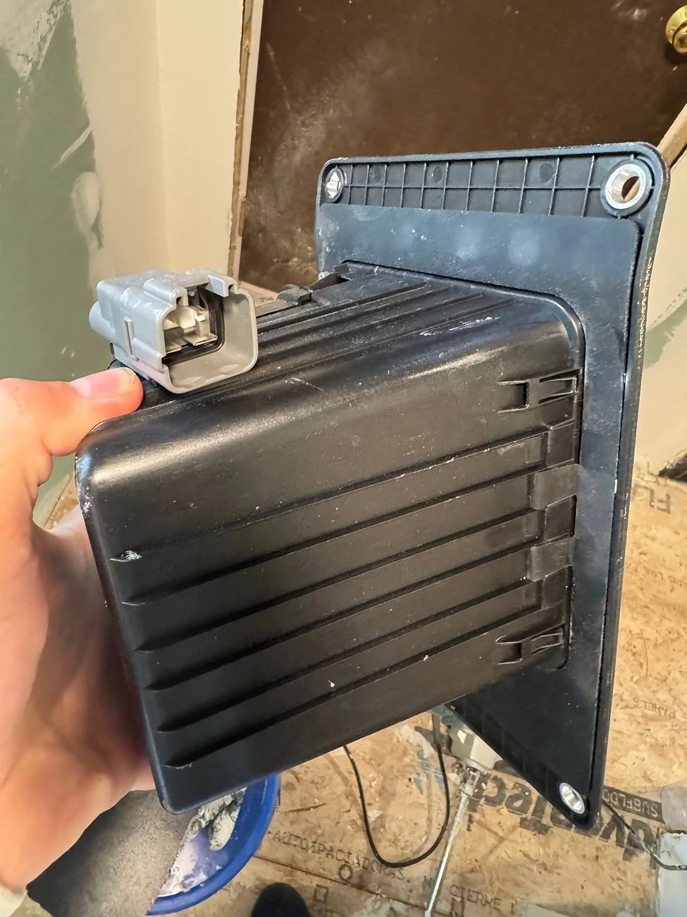

First thing I did was remove the existing cubby. This is trivial, just 4 torx bolts (T-27 i believe) and unplug the gray connector. Be careful it's brittle! Installation of the new control box is just the opposite of removal.

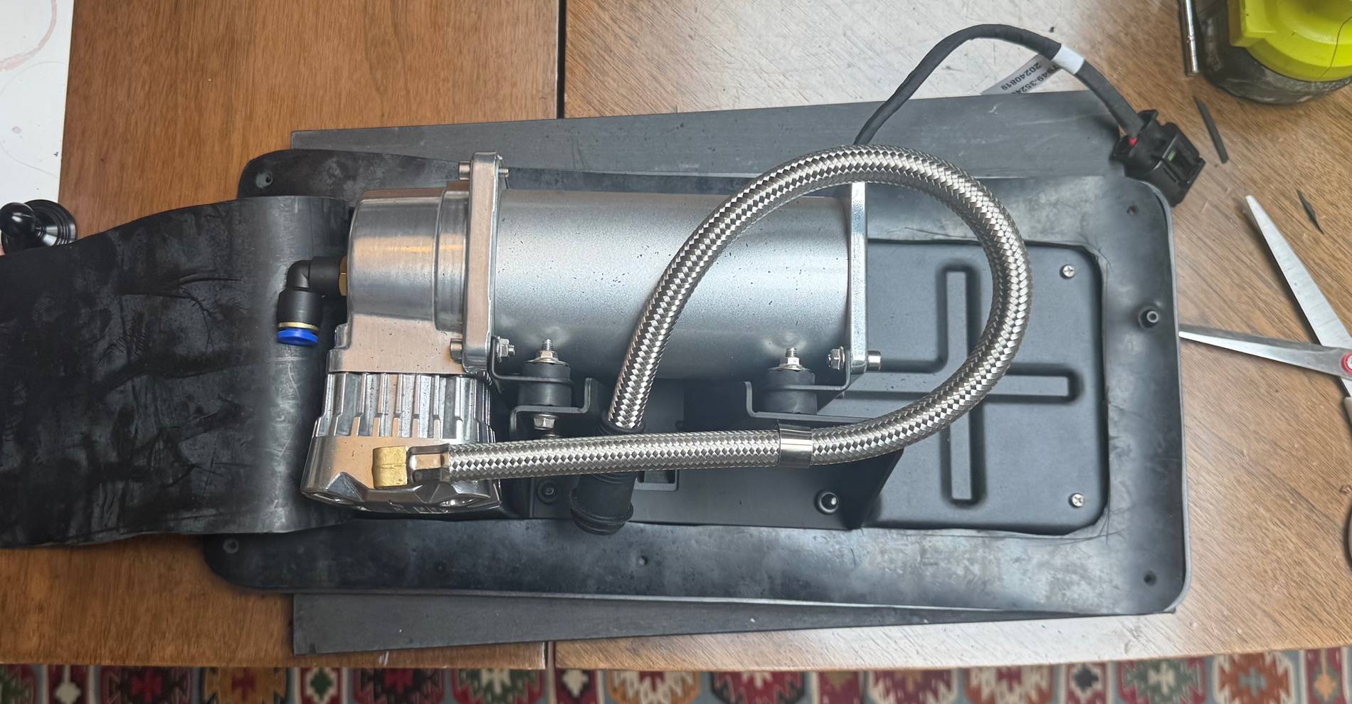

Before I went to install the compressor, I decided to make a gasket for it using 1/8" rubber since the control unit had one and the compressor did not.
2024 Tacoma Trailhunter OEM Onboard Tire Inflator/Air Compressor Retrofit into Tacoma Offroad Premium DIY IMG_3245

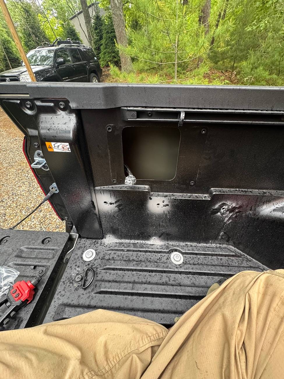

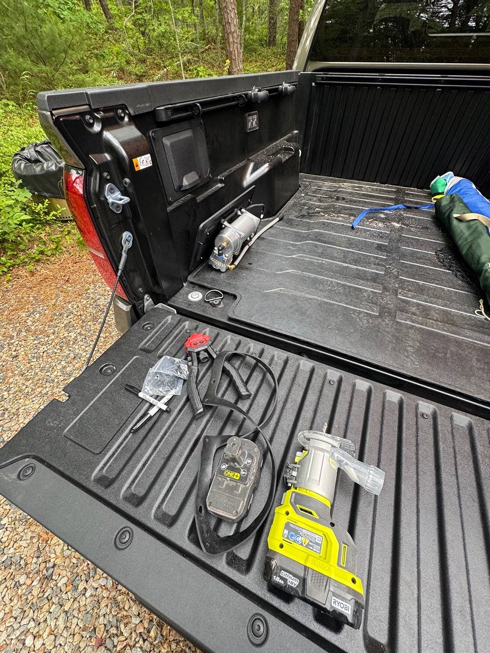

Now the only real hard part of the installation, cutting the bed and fitting the compressor unit. I decided to cut out the compressor unit using a cordless router. I wore a mask since the fiberglass really gets thrown around the air. To do this you'll need to measure where the bolts will go using the unit as a plan. Be careful, the middle bolts are not symmetrical (ask me how i know!)!
2024 Tacoma Trailhunter OEM Onboard Tire Inflator/Air Compressor Retrofit into Tacoma Offroad Premium DIY IMG_3247
2024 Tacoma Trailhunter OEM Onboard Tire Inflator/Air Compressor Retrofit into Tacoma Offroad Premium DIY B4E208A9-8350-4B82-8716-F9A3D6F0498B_1_102_o
There are 8 total holes that need to be cut (6 bolts + 2 stabilizers that come off of the compressor housing) AND the big center hole for the compressor itself to fit through. Unfortunately I didn't get any pictures of this because it started raining harder right after i took this pic. That being said just take your time with it, it's definitely stressful to cut into a brand new vehicle, just make sure you're not cutting anything behind the bed that you shouldn't be and go slow. Also obviously, I removed the control box while installing the compressor.
